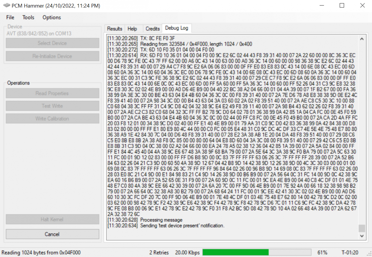

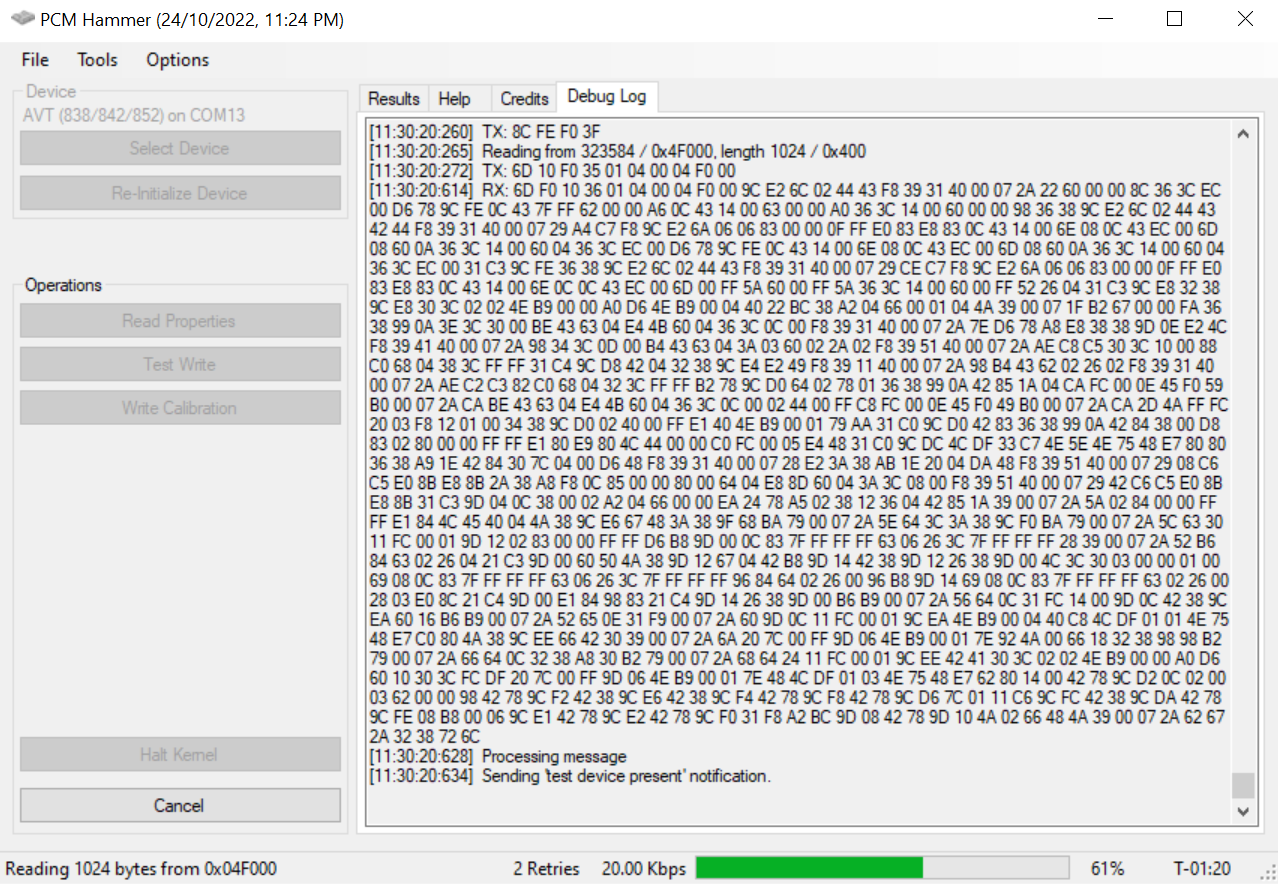

There have been a number of people asking about P04 support, and to date the answer has been that we welcome the help and please have a go and send a pull request if you are able to come up with something.
A few months ago, Gampy was able to come up with a micro-kernel which was able to run on the P04 and respond with a kernel ID. Thanks, Gampy!
More recently I was contacted by JakeFunny who was interested to contribute. Jake took on a mission to make the need for CRCs be optional (as I knew that functionality would not fit in a P04 kernel) and sent a pull request. Thanks, Jake! I was able to take this and test it, and use it as a template to make some other features configurable / optional. I extended it to make kernel version, flash id, checksum, and the max kernel block size configurable and then started playing around with kernels. I was not able to get the official pcmhammer kernels running on the P04 DLC, even when I cut a lot of stuff out and got its size down small enough. So instead I took Gampy's micro-kernel and put some of the common functions from the main kernel in to it. I found the transmit routine was causing the crashes and I re-wrote it, piece by piece, until it was able to complete a block transfer. From this I've learnt that the P04 DLC is really sensitive to timing, much more so than the other supported PCMs.
None the less, there is now an experimental branch that can almost read a P04. Its available here: https://github.com/LegacyNsfw/PcmHacks/tree/antus/p04
To try it you'll need to checkout the antus/p04 branch and compile it. Then go to the kernel/p04 folder, and with the 68k assembler installed to the default location run p04-kernel.bat in that directory. This should allow you to complete where I am up to - that is partial P04 reads.
Jake, or any other interested parties, if you want to pick this up and improve it please do so. Next up we will need a stable read kernel, and the main app needs to be able to advise users if their interface is too small to upload a P04 kernel in one packet (a limitation, only on the p04 hardware so far).
Once we have this, we can start thinking about if and how we can come up with a write kernel. Size of the kernel will be the biggest remaining challenge.
