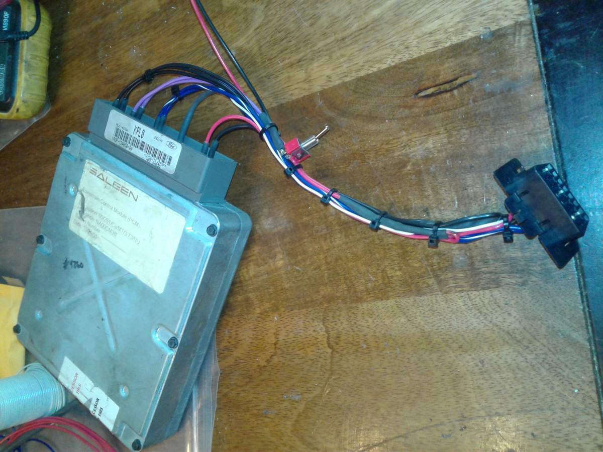

Looks like we are fishing in the same pond. I grabbed this pinout info a few days ago. I have almost zero experience with Ford stuff (eec 4 and sct and a chipper years ago) so I will be building a bench harness in the next few days too, any suggestions are definitely appreciated. I have a '99 mustang to work on. It is supposedly a supercharged Saleen car and the computer was dead. I found a Saleen computer on ebay and did the PATS and it now starts and runs although quite rich. I'm not sure if the ebay computer is actually a Saleen computer although it has the Saleen stickers on it. The car does have the red top injectors and I have cleaned and flowed them on my flowbench. HpTuners will read the file but then says to contact them and send file so it doesn't let me do anything or look at anything. I grabbed another EEC-V and had a bud program it with a stock program with his benchtop machine that does all sorts of vehicle computers(commercial shop stuff). He programmed it according to the VIN number I provided from the car. Info doesn't show VIN in his software after programming. HpTuners never saw a vin with the EEC-V that was in it nor with the Saleen/Ebay computer. I haven't checked with my OBDLink scanner yet, the car is an hour away.LSHERO wrote:Just made as bench harness for ls engines and get into the swap hobby and help others get ls swaps done. Wanting to know if it's possible and just as easy as lsdroid and tunerpro for Ford's? We have a 2005 mustang with 4.6l and seeing if it's possible to turn vats off and tune a little for a 69 bronco refurb and swap it ? Thanks guys!!!

I friggin hate buying credits and would rather buy more equipment to do whatever I need myself. I've perused Moates site about the ford stuff but am still confused on what to buy. I have a lot of eprom stuff and a Burn2 I bought just to check out the whole 27s512 flash stuff years ago. Quite a few different programmers besides the Burn2. I have a VxDiag interface, a tactrix interface, an AVT852 interface. I would think one of those should be able to talk to the EEC-V.
Is there a quick tutorial on getting started with EEC-V? Communication first obviously, then a .bin editor/software. Freeware is nice but cheapware is fine with me too. I ain't skeert

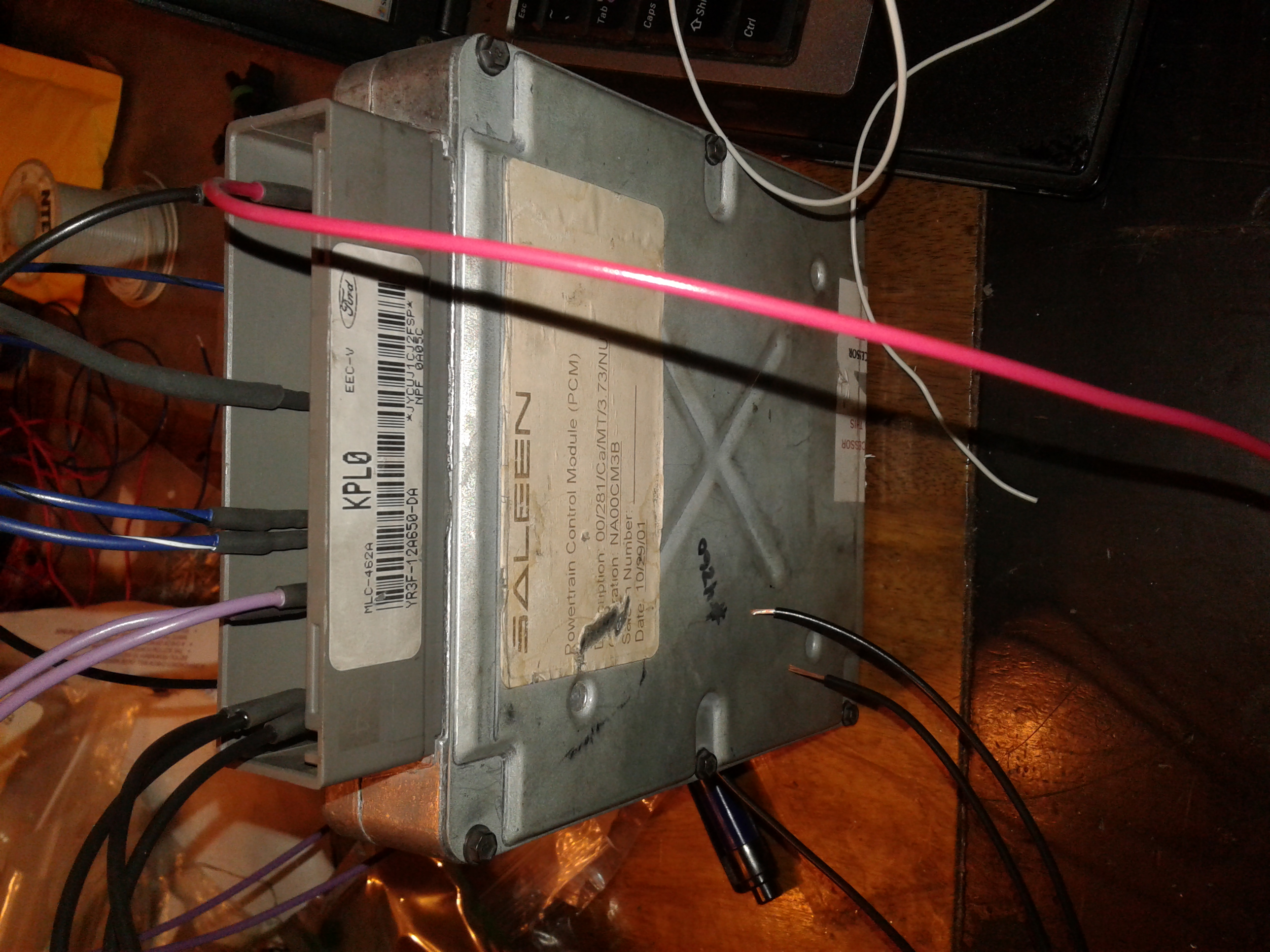

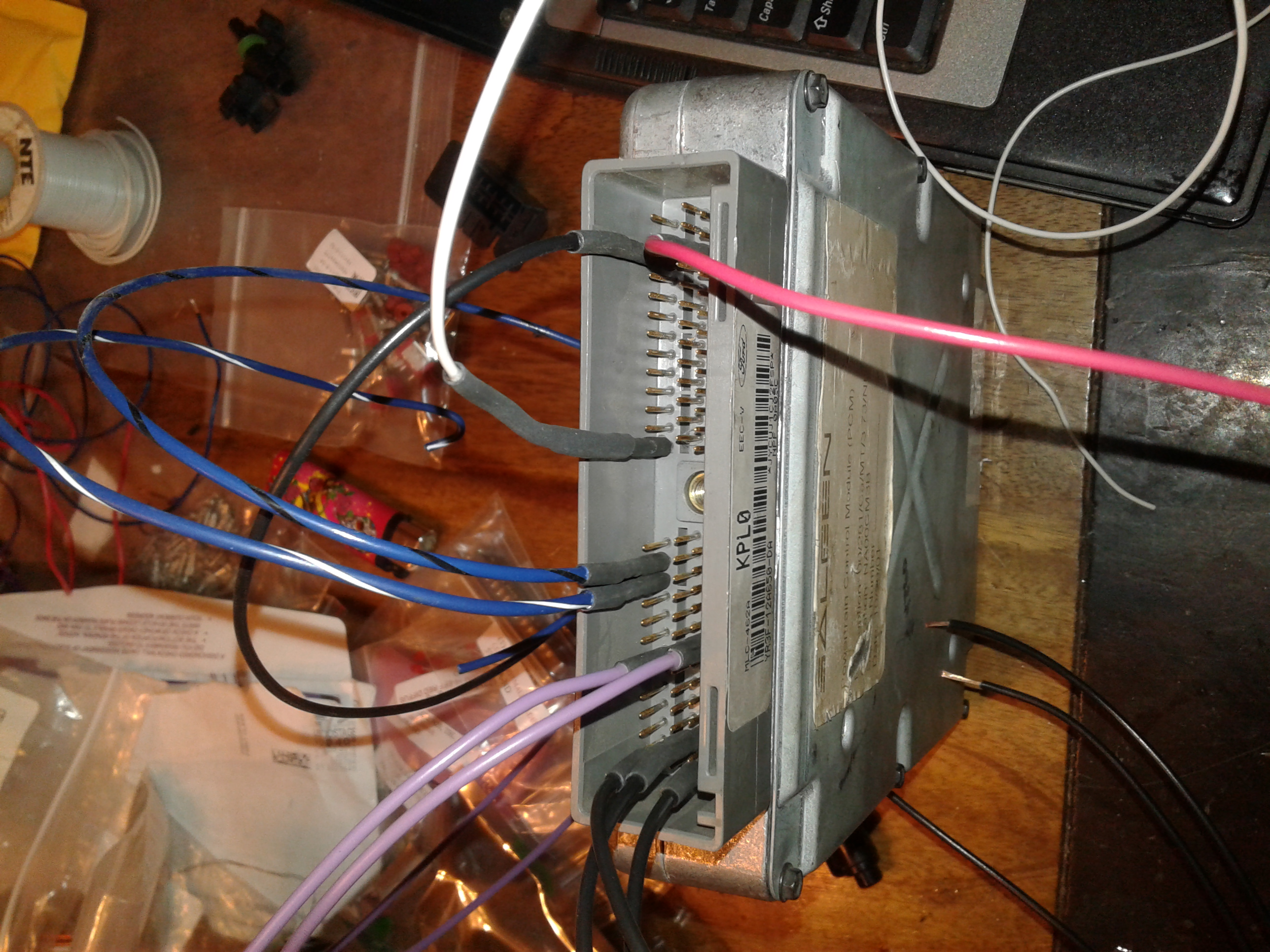

Awfully big pictures from my phone, sorry. I ain't skeert yet
Re: Newbie , is it possible to make bench harness Ford?
Bench harness works, now I gotta figure out how to log some traffic then head to the dealership my bud works at and log some writes.
