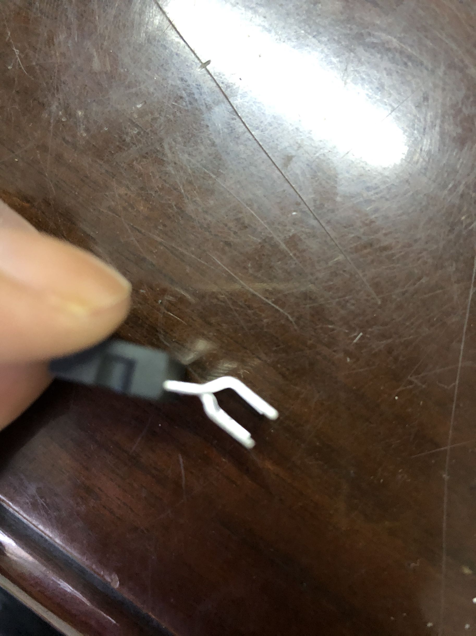

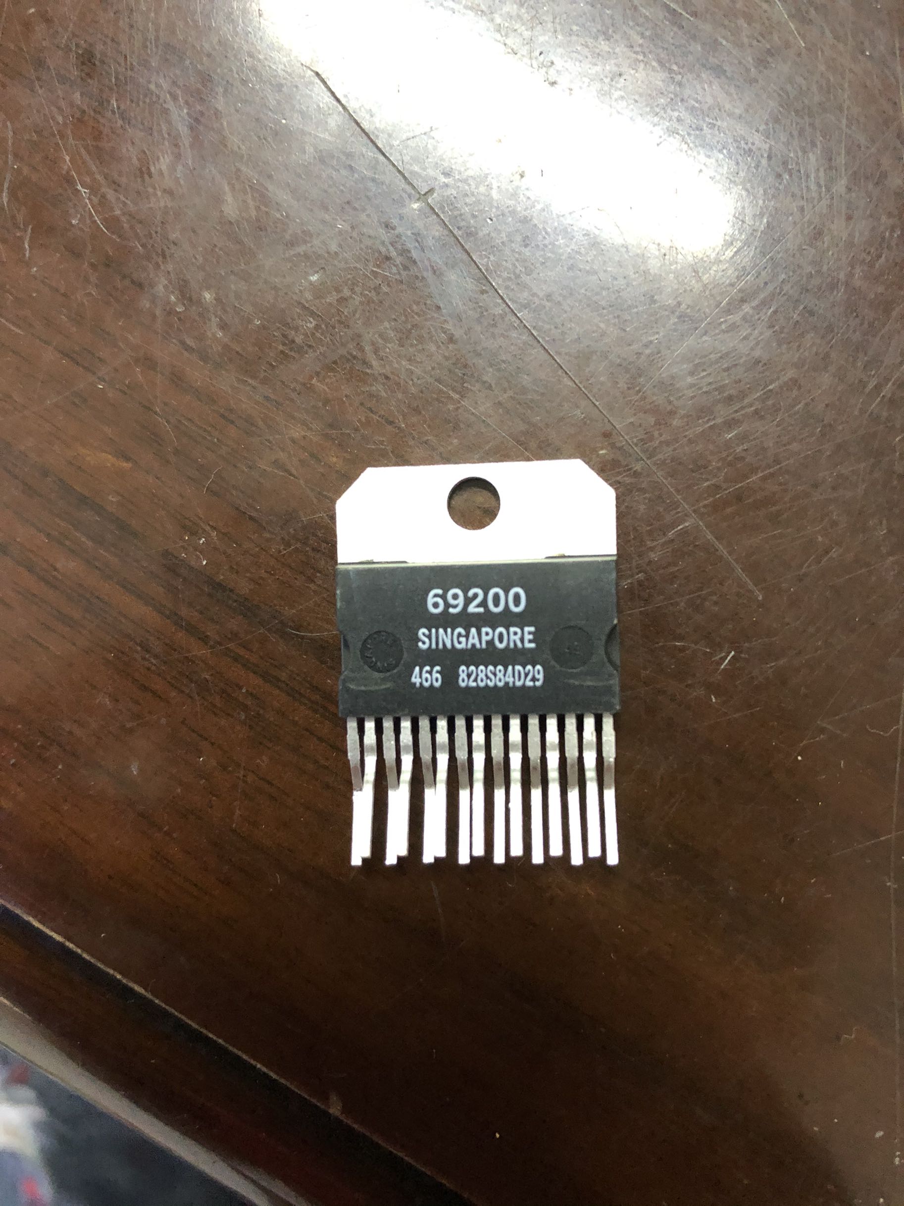

Drudging up an old thread. I just received some 69200 IAC chips(pics below) so I thought I'd have a go at converting a DBW pcm to DBC sometime. One of the pics I posted earlier shows the IAC chip and cap difference but where is this analog A/C input and tach pull-up spoken of above? Or are the boards the same traces minus the IAC chip and cap and these other inputs are firmware/OS based?
