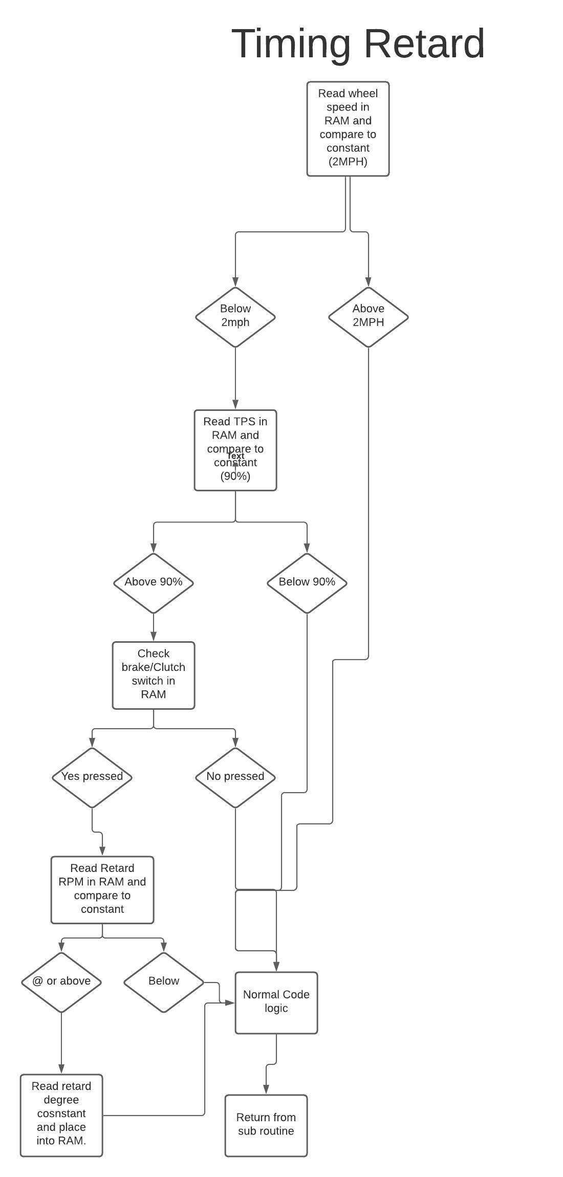

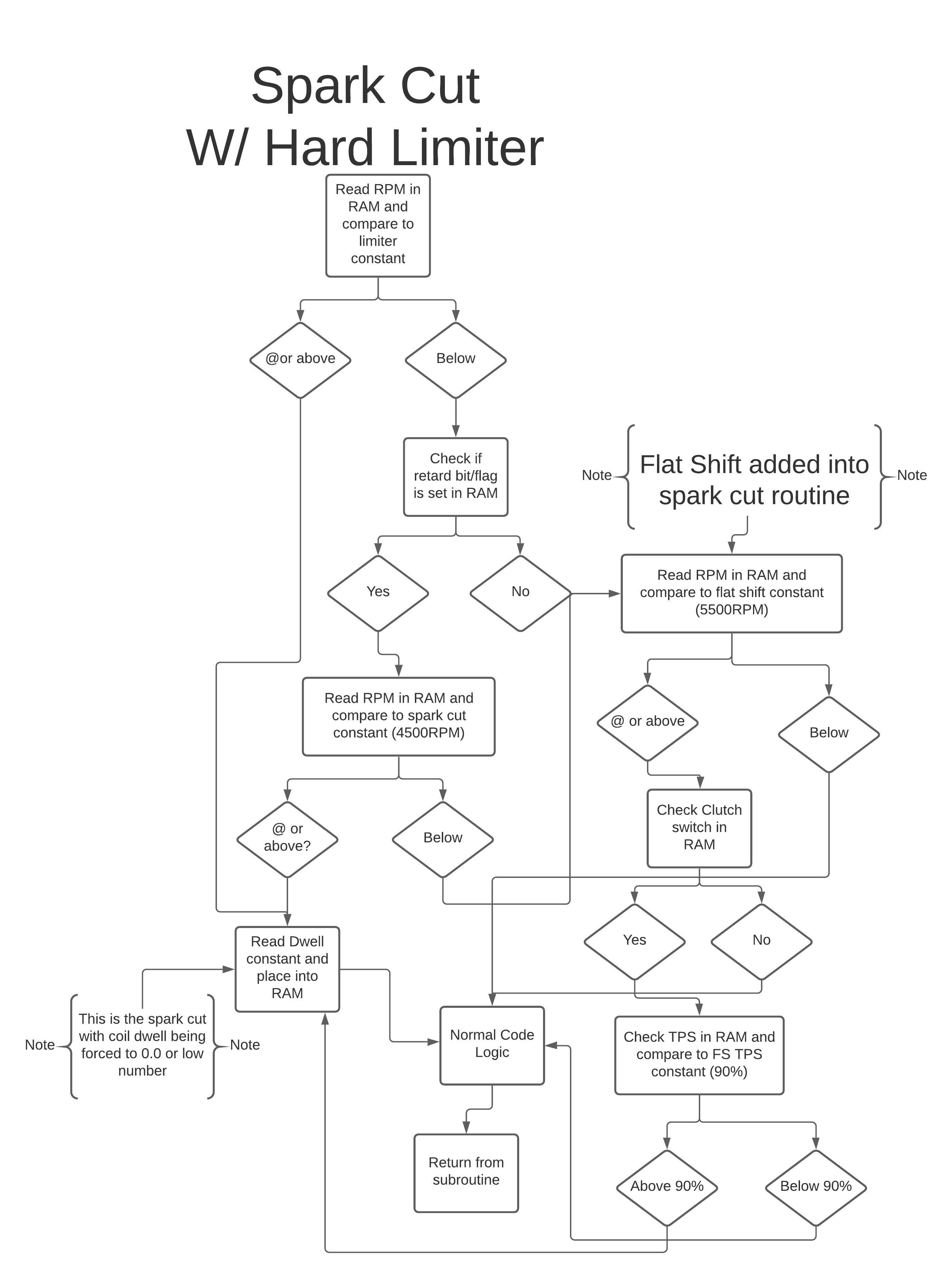

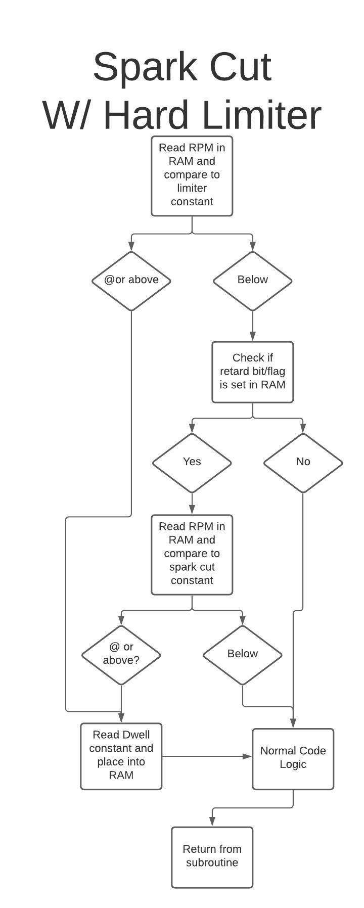

your sort of over complicating the process of this bubba by trying to achieve so much so early in the development. have you got the retard and spark cut parts working yet? the process should be retard -500 before spark cut RPM than your spark cut RPM. retard always stays on with the spark cut. when function shuts off timing will return to normal quickly. start with a simple routine like this....
----Automatic----
1. check wheel speed, if below 2mph go to brake pedal check, if above skip.
2.check for brake pedal, if brake is pressed go to TPS check, if not skip.
3.Check to see if TPS is above 90%, if yes follow into timing retard & spark cut. of not skip.
4. retard timing starting -500 RPM of the spark cut RPM.
---Manual----
2.check for clutch, if clutch is pressed go to TPS check, if not skip.
it can be that simple to start. the manual transmission one can be TPS and wheel speed only. doesnt need a clutch switch to detect technically to have just launch control because the decider weather launch is active will be the wheel speed sensor as it can only activate if below 2mph.
and retard isnt necessary to start, you can skip that for now too. just need to find the right spot in the code to force the coil dwell time to 0.0ms and make the ECU temporarily ignore its real dwell table. to test that is simple in theory. just make your jump out for that custom code where you think the point in the original code is that the final dwell value is placed into RAM than just make a forced constant value somewhere that is referenced and set it to 0.0ms and an RPM that spark cut will happen. once you have that its this easy......
1. check RPM constant, if at or above RPM jump to fake forced dwell time. if not skip.
2. read fake forced dwell of 0.0, 0.1, 0.2 etc constant you made and force it into RAM instead of the value from the dwell table.
this is a basic way to figure out if you got it right. the spark cut is the most important, more important than the retard for now. i have already confirmed a few pages ago that forcing dwell to 0.0 or a very low number will give the spark cut/bouncing effect that is needed. by bouncing what i mean is the engine RPM will climb to the desired spark cut RPM than when that is hit and the dwell time is forced to a low number the RPM drops below the spark cut RPM making the ECU read the dwell table again automatically causing RPM to rise again to spark cut than back down, than back up etc. where the dwell is read is normally is a pretty high priority routine so thats why it will be a fast on/off spark cut. changing the forced dwell time can also change the speed of the cut as well. 0.0 will be faster and the higher you go the longer the space is between the cut.
to add the timing retard you will need to source some open RAM and create your flags because where the spark cut will happen in code the timing read will be in a totally different sub routine most likely. the first thing to look for in the code for the timing is if its actually sequential like if the ECU has its own RAM position for each cylinder or if the ECU takes a single timing value and breaks it up into being sequential on a hardware level. on some VAG ECU's like MED9 it has per cylinder ignition angle in RAM so i have to hijack all 4 of those to make the timing retard work. but basically i would place the code for the checks for wheel speed, TPS, brake/clutch etc where the timing retard happens than when it gets to the part in custom code to set the timing retard it also sets a flag in RAM that the spark cut code elsewhere is looking for. when the flag is set and the RPM is met spark cut will follow the timing retard.
These are the added constant values i suggest.
-Wheel speed- this is very effective for turning launch control on/off.-----to not use wheel speed if desired set wheel speed to maximum
-TPS %-if above say 90% than your LC can go active -----
-X2 RPM variables- 1 added constant for retard RPM start and 1 for Spark cut RPM.
I will elaborate on adding flat shift code to this once i see a working launch control routine.

Here is flow diagrams i made for you to follow for a good flow in the code.

And here is a diagram of how flat shift would be added into the equation with the spark cut routine.
on the hard cut RPM limiter to make it true 2 step you use both stock fuel cut and the spark cut one. if you dont like the violence and flames set your stock fuel cut to whatever you want your rev limit to be than set the hard spark cut limiter a few 100 RPM higher than the stock fuel cut one, this way if the engine manages to push through the fuel cut one the spark cut one will catch it and stop it. If you want the drama of backfiring and flames on the rev limiter you set the spark cut to be your lower limiter and and the fuel cut a few 100RPM later. this way the fuel stays on during the spark cut limiter and you get the drama that makes all the kiddies drool and ask for more lol.

To summarize current state of what I have:
1. Spark cut launch control works, but could use some updates to try and make it smoother. Ideas are welcome. I have one idea, but would like more.
2. I believe the timed retard after launch is also working, but I want to do more testing. This is not during launch control, when LC disables this goes active to reduce power for a short period of time to reduce or eliminate wheel spin. It will only activate if LC disables with the brake or clutch. And disables if the throttle position goes below LC TPS. This is geared towards drag racing.
3. I need someone to test the clutch input. Using PCMLogger of a RAM address to verify both the location and the state of the flag when the pedal is up and down. This will allow use for manual vehicles and allow testing of the flat foot shift. I may just have to see if I know someone running this OS with a manual so I can do testing in person.
vwnut8392 wrote:your sort of over complicating the process of this bubba by trying to achieve so much so early in the development.
Maybe, but why not add features now vs trying to re-do the whole thing. I think the hardest part I'm dealing with is how long it takes me to code this up in ASM. I'm not a programmer, but I have read that some people have written in higher level languages and then compiling to ASM. That would help a lot, but it would probably take me some time to learn it.
vwnut8392 wrote:have you got the retard and spark cut parts working yet?
I got the spark cut working days ago when I posted the chart of the dwell going to zero. I'm not doing a spark retard for the limiter, I don't think there is much use for that other than changing the sound and maybe it could make it a little smoother.
I tested my code at the track and it seemed to hold the RPM's fairly smoothly at the set point. It's not as smooth as my WOT BOX that I have in my truck, but it's not bad for a first try. I'm open to other ideas on how to make it hold the RPM smoother, but I don't really want to modify timing as I want to leave that for a boost builder function I have an idea for.
vwnut8392 wrote:it can be that simple to start. the manual transmission one can be TPS and wheel speed only. doesnt need a clutch switch to detect technically to have just launch control because the decider weather launch is active will be the wheel speed sensor as it can only activate if below 2mph.
I want to be able to let the user rev past the LC limiter when stopped if they want to. That's why I am adding the clutch switch. I can always add parameters to disable the use of the brake/clutch input for people that don't have them. If the user has it wired in already then I imagine it could helpful.
vwnut8392 wrote: to add the timing retard you will need to source some open RAM and create your flags because where the spark cut will happen in code the timing read will be in a totally different sub routine most likely. the first thing to look for in the code for the timing is if its actually sequential like if the ECU has its own RAM position for each cylinder or if the ECU takes a single timing value and breaks it up into being sequential on a hardware level. on some VAG ECU's like MED9 it has per cylinder ignition angle in RAM so i have to hijack all 4 of those to make the timing retard work. but basically i would place the code for the checks for wheel speed, TPS, brake/clutch etc where the timing retard happens than when it gets to the part in custom code to set the timing retard it also sets a flag in RAM that the spark cut code elsewhere is looking for. when the flag is set and the RPM is met spark cut will follow the timing retard.
I already have some open RAM that I found and I'm using it to do spark retard. It's one single value that can be modified, which I believe I've done successfully. There is a little more testing that I want to do as I think I was having some other issue with my tune that was getting in the way of testing my logic.
I added a very basic Flat Foot Shift logic, but I don't have a vehicle to test it with. I will need someone to test that I have the clutch switch variable correct.

sounds like a good start though. spark cut will always be violent, thats its nature. if you watch my one video with the maroon silverado you will see a difference between a smoother LC and very harsh. the timing retard makes it a little smoother. the purpose here is to use the backfires to build boost on turbocharged engines, it needs to be that way. the retard creates added load on the engine to also build boost on turbo vehicles and on NA helps build torque on the starting line.
