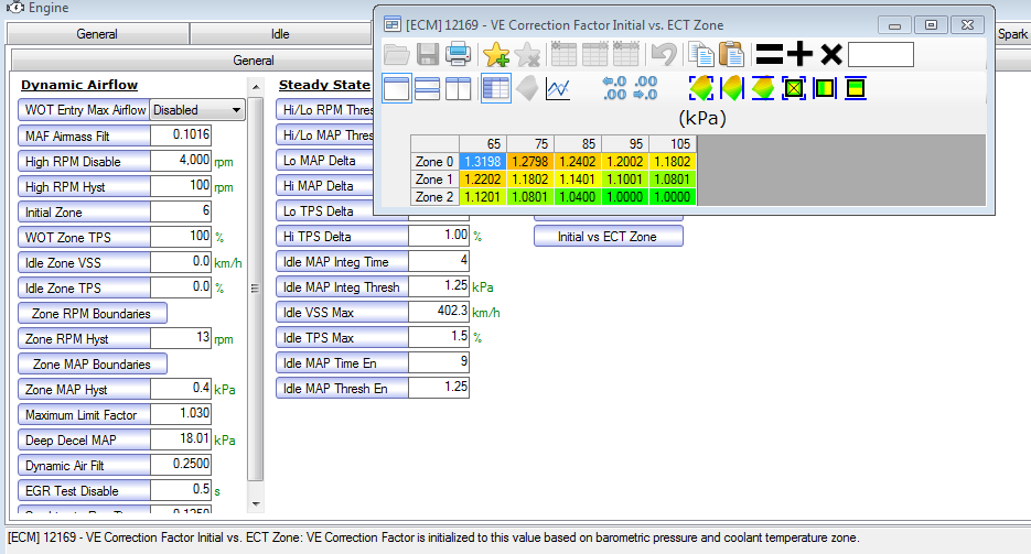

For whatever reason, it appears this engine combo is much less efficient at lower coolant temps, so I started looking for a table to adjust the VE based on coolant temp. I found the VE correction factors in the ...604 XDF as well as in HPT. So I ported those tables over to EFI for the ...618 OS and am ready to try modifying them, but I'm realizing I don't understand how the table functions.
VE Correction Factor.PNG (60.42 KiB) Viewed 5632 times
The description is that the VE Correction factors in the tables are used to initialize a value, which I figured is then updated. Without a MAF, running speed density I'm not sure how it can be updated? This is where I'm looking for some insight into the OS of the PCM to understand how the values from this table are used within the speed density dynamic air mass calc. Are the correction factors reloaded often from this table? or maybe only at startup? Are these corrections multiplied into the VE table, or divided?
Potentially I can log EQ error correction between commanded and actual and use that to 'tune' in this table for different coolant temperatures. At the least I figure I can set this whole table to 1.0, and set the min and max correction to 0.999 and 1.001 and at least make it one less modifier to get in the way.
If this table isn't what I need to modify then I guess I will stick to looking for a problem with the dynamic temperature calc. Potentially it is an issue with the IAT being mounted in the aluminum intake manifold and instantly heat soaking(single plane carb style intake)....but the IAT is believable as it's just a standard 14" airfilter that draws in underhood air.
Curious what you guys know about how these internal VE corrections are used, and how they are best adjusted for speed density tunes. From what I gather here I can make a plan for my next moves. Thanks!

If you are using speed density (the MAF is failed) the VE Correction factor is not used at all in the fueling calculations.
You seem like you are changing the correct fueling table for open loop. I don't see that as a band-aid, but then again I'm no professional tuner.

cool, this tells me what I need to know.
yeah the OLFA table works, just seems crazy its so far off when cold. but then again, all we're looking for is the right amount of IPW at the right time...so if you get that then it's hard to complain.
I have a few different things I'm going to chase, we'll see if any of them make it better. one thing I am going to do is set all the VE correction stuff to 1.000 so it becomes a non factor.

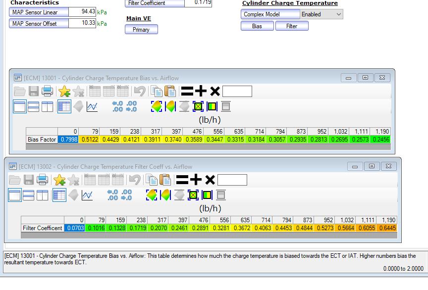

Have you thought of trying to move the cylinder charge temperature bias more towards the ECT? I use this in supercharged applications where the IAT gets really high in idle situations while sitting in traffic, sounds like you are having a similar issue.
Charge Bias.JPG (104.47 KiB) Viewed 5529 times

Phoenix wrote:Have you thought of trying to move the cylinder charge temperature bias more towards the ECT? I use this in supercharged applications where the IAT gets really high in idle situations while sitting in traffic, sounds like you are having a similar issue.
as I have a MAT instead of a IAT, I'm going to turn off the complex model and run it straight up on IAT. I haven't done this yet, but it's the general plan. When you're running down the street the charge gets cooler, and based on sensor location I believe the IAT only to be more accurate than blending with ECT. The air only travels ~6" past the 'MAT' sensor before it's in the cylinder.
this engine doesnt have an intake tube or anything, and will pull in hot underhood air all the time. So I think it'll be fine-we're going to see.
