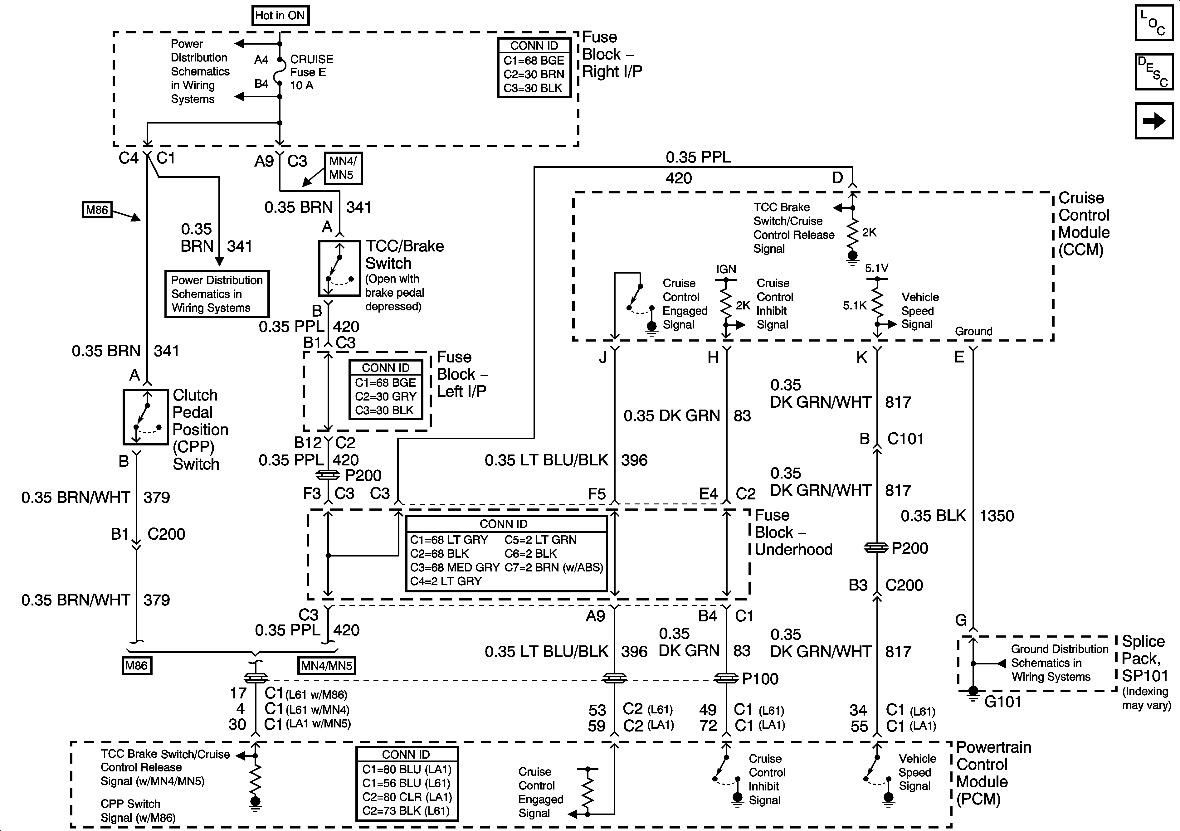

ejs262 wrote:one of the big ticket things I would like to try and figure out is the cruise inhibit control from the PCM. it's preventing the cruise module from working with the 5 speed swap, or at least I think that's whats keeping it from working.
The PCM just grounds the cruise inhibit terminal (H) when cruise is allowed and opens the circuit when cruise should be disabled, so if all you want to do is get cruise back you can ground the Inhibit terminal so it's not being controlled by the PCM.
The cruise control module receives a vehicle speed signal input from the Powertrain Control Module (PCM). In operation, the voltage varies between 0 V and 5 V.
The cruise control module, cruise engaged terminal, sends a signal to the PCM when cruise is engaged. The cruise control module, cruise inhibit signal terminal, is a circuit used by the PCM to inhibit cruise control when conditions inconsistent with cruise operation are present.
After the cruise control engage criteria has been met and the cruise ON and Set/Coast have been commanded, the cruise control module sends a signal to the PCM that the cruise control is engaged.
The PCM will inhibit cruise control:
When vehicle speed is less than 40 km/h (25 mph).
When in PARK, REVERSE, NEUTRAL, or 1st gear.
With low engine RPM
With high engine RPM, e.g. fuel cut-off
When vehicle speed is to high
When an over or under charged battery voltage condition exists
Antilock brake system/traction control system is active for more than 2 seconds
If the PCM determines that any of the cruise control inhibit conditions are present, the PCM will disengage the cruise control. The PCM accomplishes this by opening the cruise control inhibit signal circuit.
With low engine RPM
I could do that as well. I would like to avoid further hardware changes, mainly because I can use this as a learning experience. I think it's possible that my problem is based on a hardware configuration as well though, so changes may be necessary either way.
