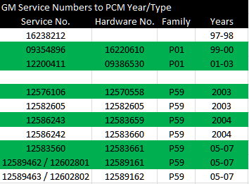

Here is a list of numbers I've collected, highlighted green means it has the IAC hardware present and will work with both DBW and DBC.

I literally just gave you that information above with all the hardware and service numbers. Green means it has IAC/AC hardware. Unfortunately the hardware/service numbers are not stored in the bin file either so unless you can verify the PCM is virgin you pull tune files from you'll not have that information.Gampy wrote:Please show me where this information is that says what works with what and what each different piece's (hardware & software) capabilities are so I (and others) can gain the knowledge to know what will work with what or has what capabilities.ShorTuning wrote:I would like to think that people that would be using this information would have enough knowledge to know what file will work with what. Especially they should know what hardware they have and what capabilities it has.
Your alls shin dig just trying to explain why hardware/service numbers only matter when figuring out if you're using DBW or DBC and to signify whether it is P59 or P01.

Dude I wrote most of this software and I'm not entirely clear on this stuff.ShorTuning wrote:I would like to think that people that would be using this information would have enough knowledge to know what file will work with what. Especially they should know what hardware they have and what capabilities it has.
Based on that chart it sounds like you're saying there's effectively 3 kinds of hardware that people need to be aware of:
1) P01 - all are usable with DBW or DBC
2) P59 without IAC - usable only for DBW
3) P59 with IAC - usable for DBW or DBC
Related question - do you know whether there's a hardware number that indicates a P59 with an Intel flash chip? I'd like to experiment on one of those before I take another shot at AMD, but I'm not sure how to identify one without opening it up.
