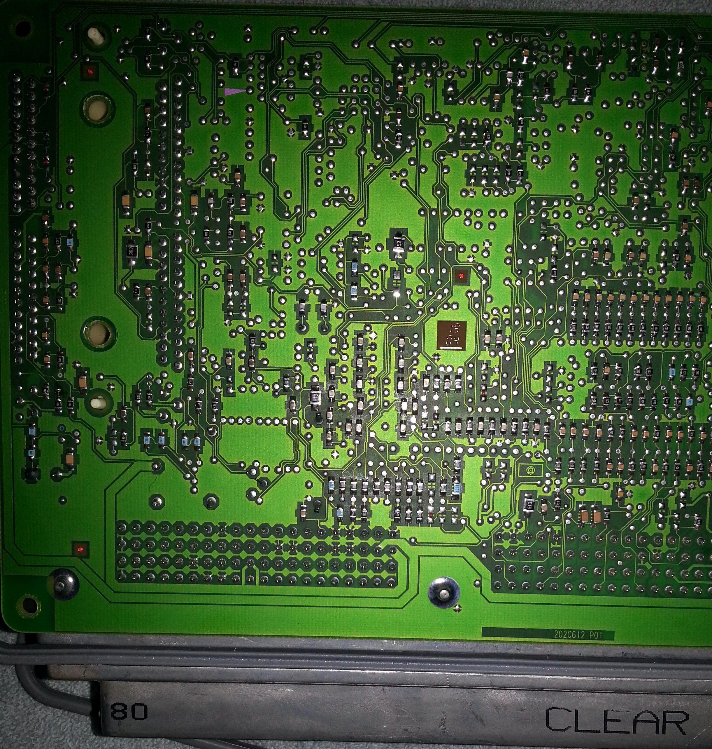

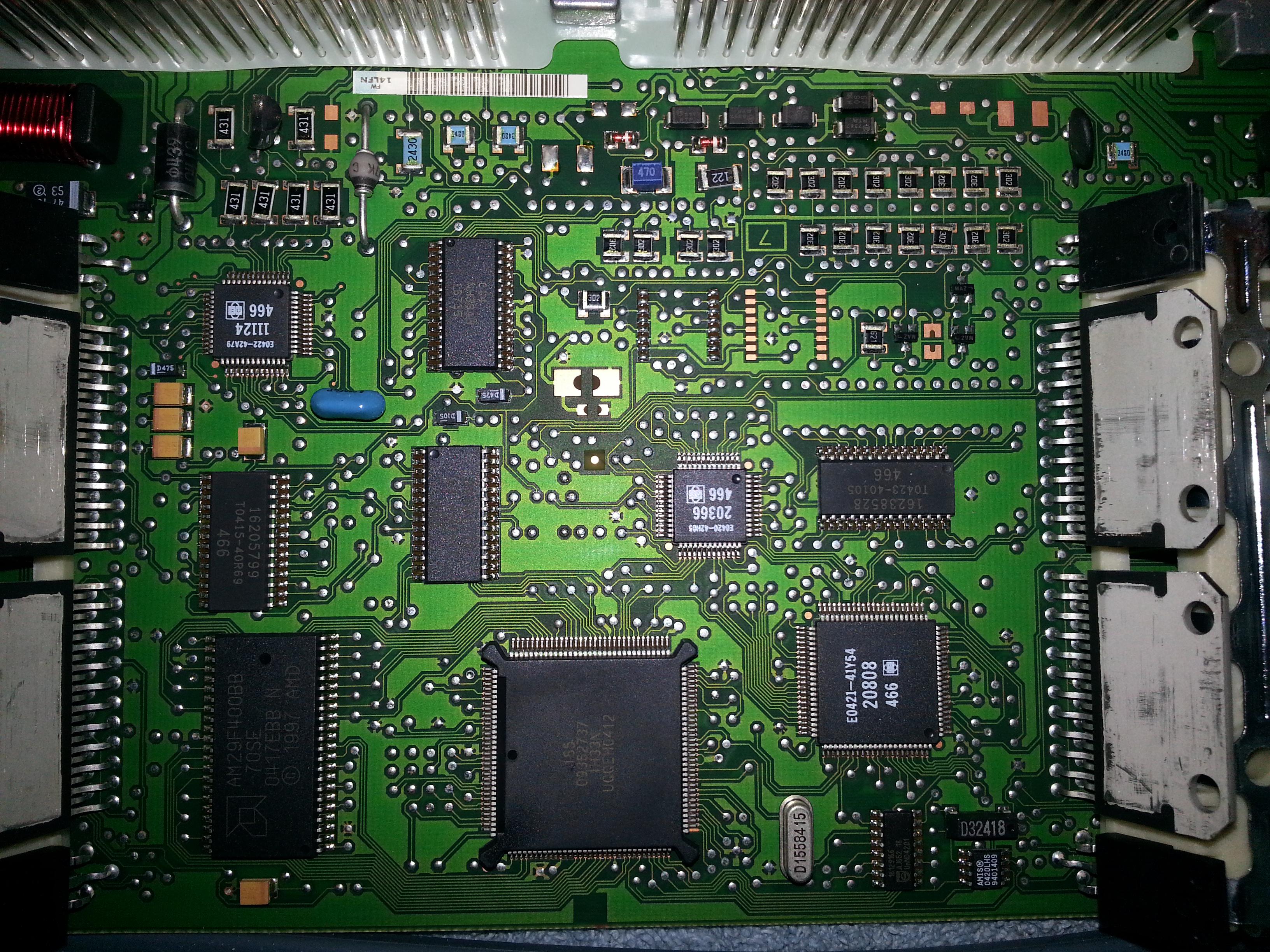

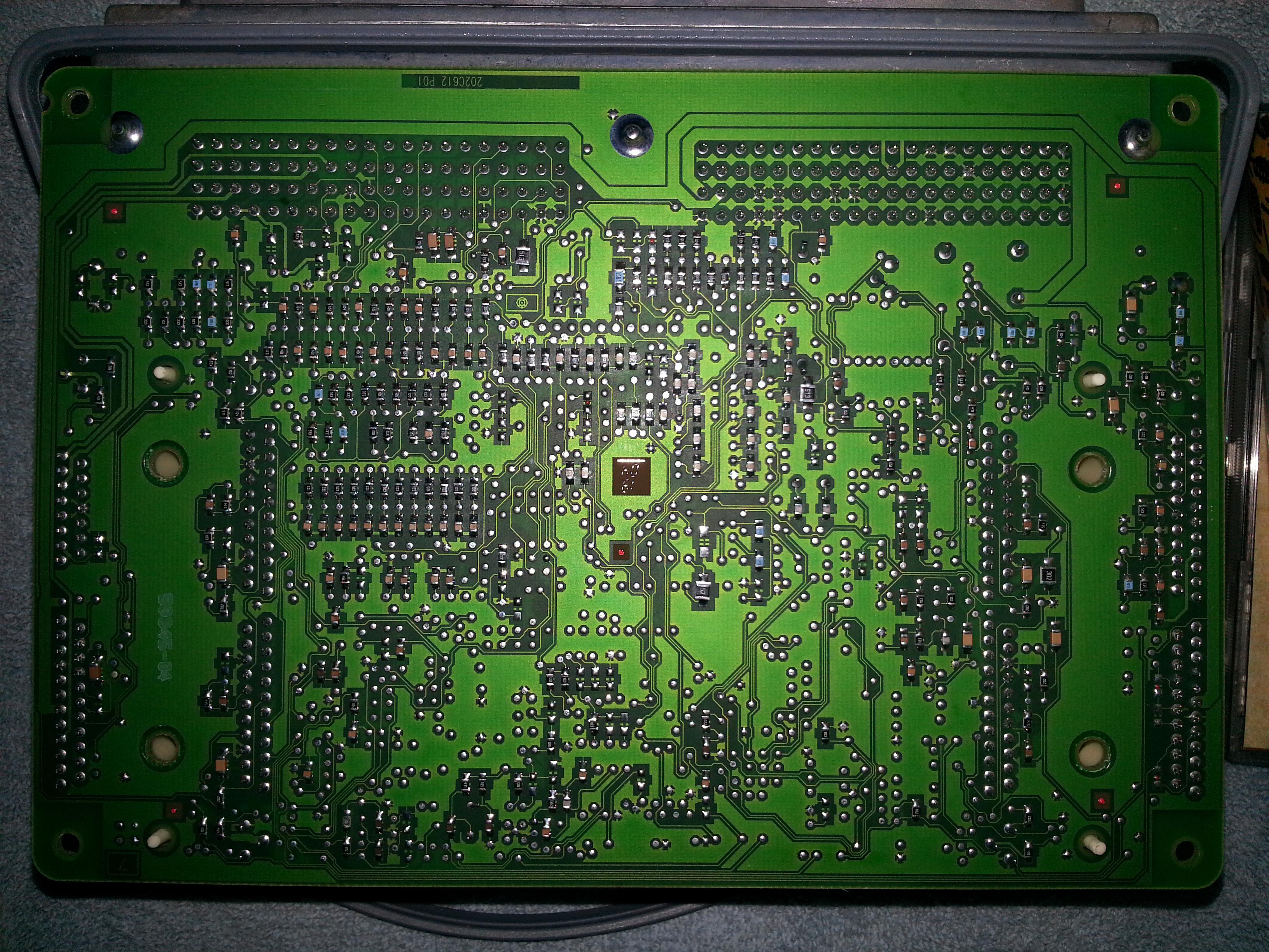

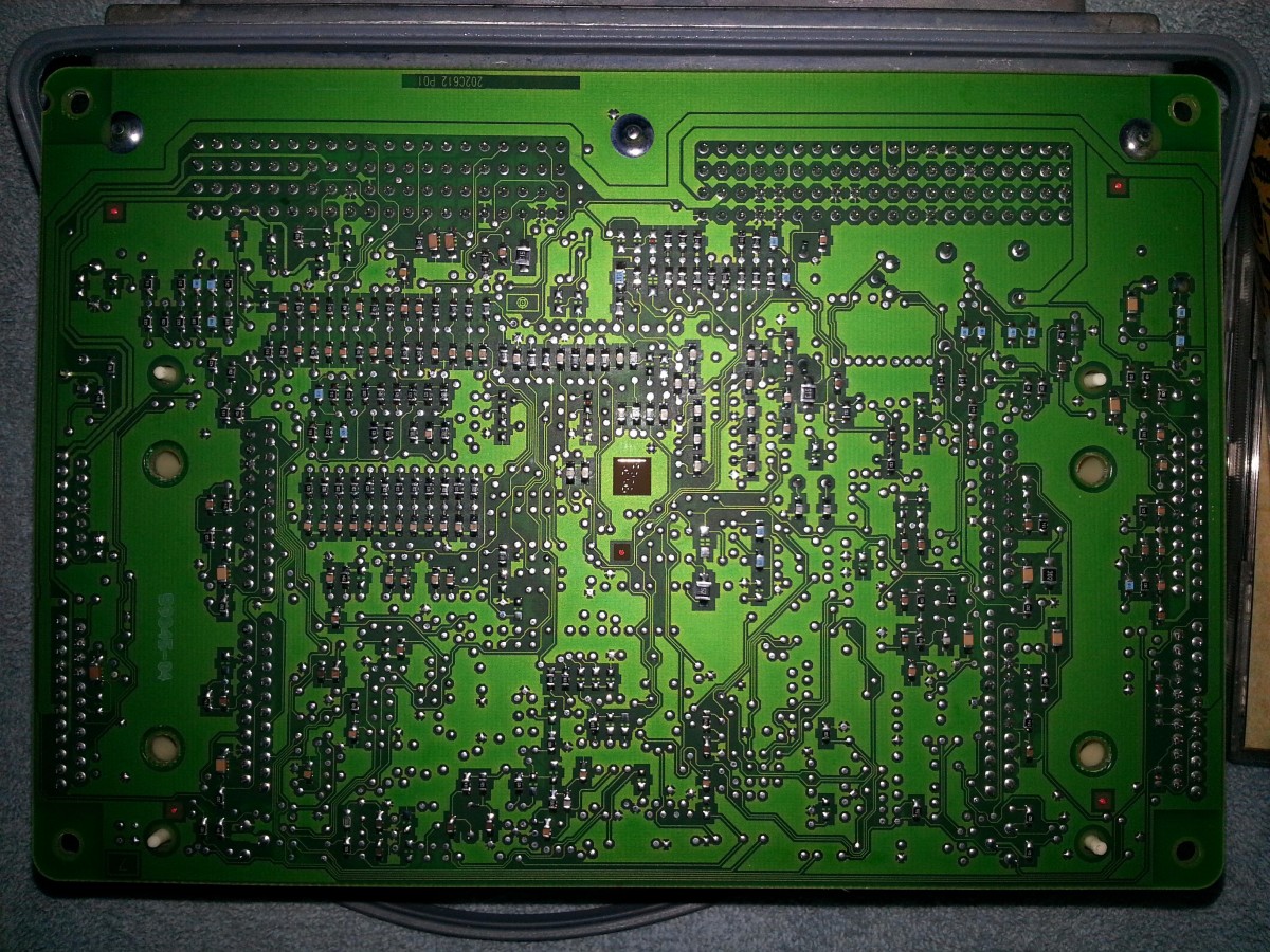

It's official ... The P04 does in fact come with a AMD chip as well!
Lookey see what showed up on our porch a little bit ago ...
2005 Buick Century 4dr Sdn Custom 3.1L (LG8)
OsID: 12594316
SvN: 12583827
HW: 12582720
[Edit]
Pulled with PcmHammer: The Unlock short pin, A top view, A bottom view,
Definitely a different layout, and as David pointed out no BDM header, but I'm sure he'll suss out the pinout.
MCU looks a bit different.
The DLC looks to be the same (If I'm looking at the right chip).
I did notice something else different between this unit and David's unit, his is missing a driver chip that would be the IAC driver on a P01/59.
This unit has a chip there ... though not visible in these images except for the used solder points on the bottom.
Why do some posted images get a Zoom magnifier others don't??
