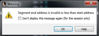

when i try to create the second RAM segment ida wont let me do it. pictures are attached how i was adding the second segment and the error i get.

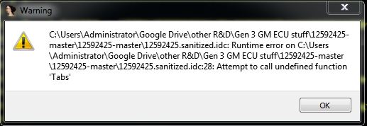

Error i get when trying to run the IDC too.

I've had bad luck creating RAM segments using that UI as well. I think it's a bug in IDA because those start and end addreses look perfectly valid to me.
I don't remember what I used in that dialog box, but I'm pretty sure I really created the segments using the segments tab in IDA. Or maybe skip that step and let the IDC file create the segments.
Try removing the call to the Tabs function in the IDC script. I'm not sure what it's for but I don't think it's useful. What really matters is the names and comments that the script creates later.
I'm guessing Tabs() was something that was supported in the version of IDA that I have (6.1) but not in the version you have. But like I said, it isn't important anyway.

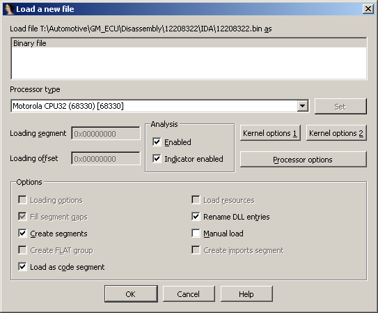

Re: developing a spark cut launch control solution
Right wrong or indifferent ... I dunno know.
This is how I get'er done in 6.8 ...
Select: File
Select: Open
Select: .BIN of your choice.
Select: Ok
At the: 'Load a new file' dialog. Set: Processor Type: Motorola CPU32 (68330) [68330]
Select: Ok
Select: Yes
At the 'Disassembly memory organization' dialog. Select: Create RAM section
Set: RAM start address: 0x00FF8000
Set: RAM size: 0x00FFFFFF
Select: Ok
That's all folks, yur in ... Now the cleanup starts, that's the hard part!
Starting with running the .idc script created with NSFW's excellent .xdf to .idc Powershell script.
Unfortunately, when it comes to math, I'm not sure what has the one up, a rock or I, so how to calculate and correct the split bus issue is beyond my math-less pee brain.
-Enjoy
