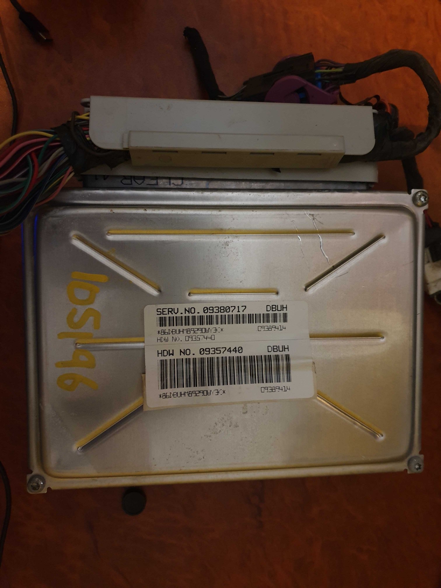

I got a delivery today
Re: V6 ability for pcm hammer.
Antus and i both got presents today
wasted no time ripping the covers off mine, this is what im working with.
i got it connected to the bench and managed to get it to talk, just vanilla Pcmhammer 011 unzipped and run up.

here is the debug log if it helps at all.... im no good at coding but happy to test anything people need.
