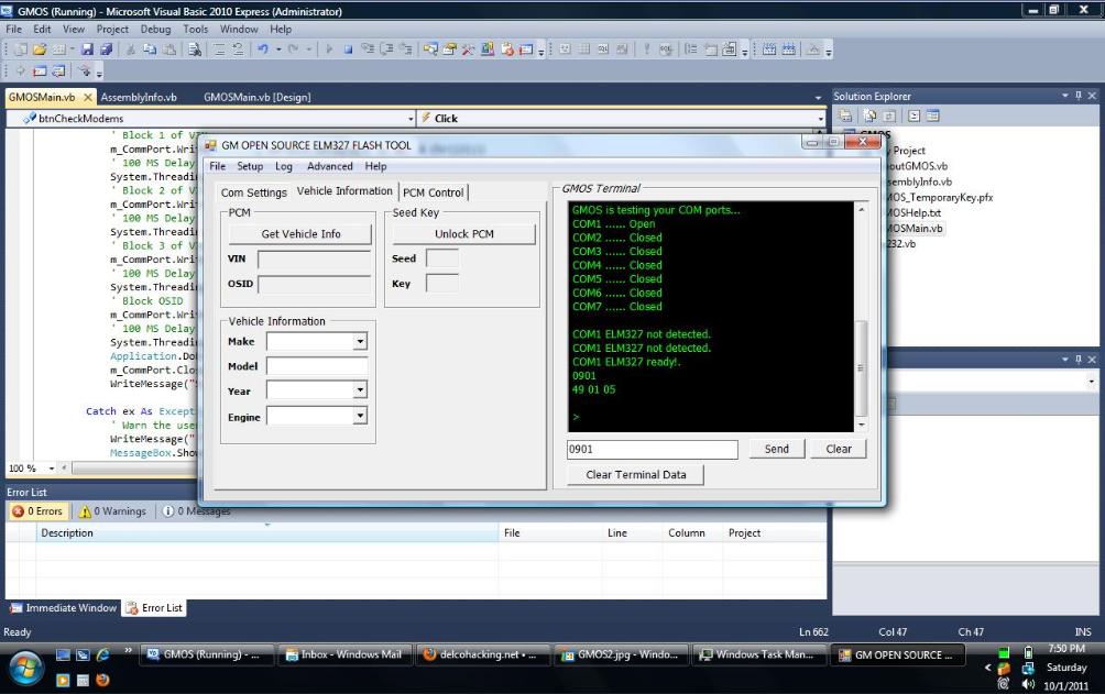

I've said before that I'm not much of a coder, but after an afternoon of debugging, head scratching, trial, and error; finally managed to get a semi functional GMOS running. It's pretty exciting to see it work, but no one hold their breath on a release date. There's still a lot of work to be done and lots of PCM controls to be understood. Anyway here's a screenshot.
- GMOSweb.jpg (100 KiB) Viewed 30358 times
