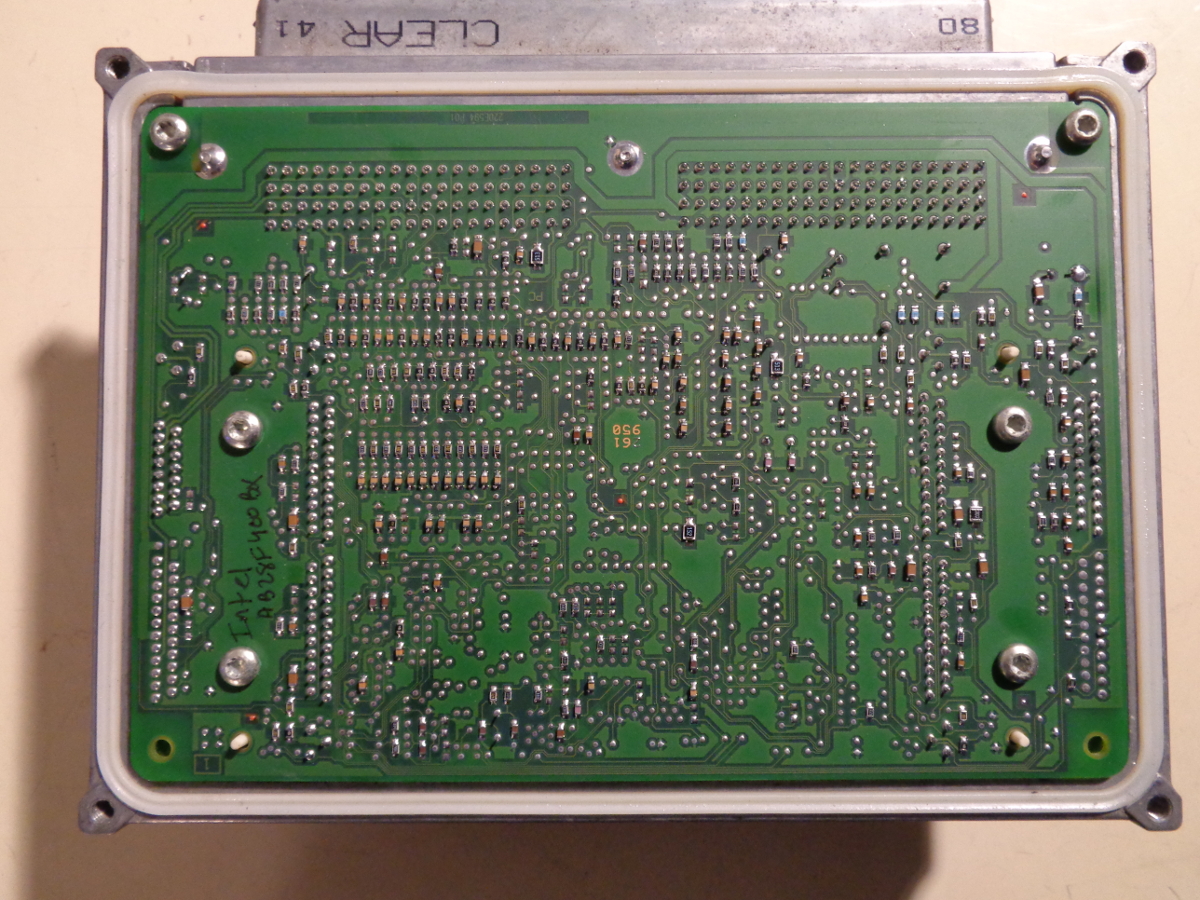

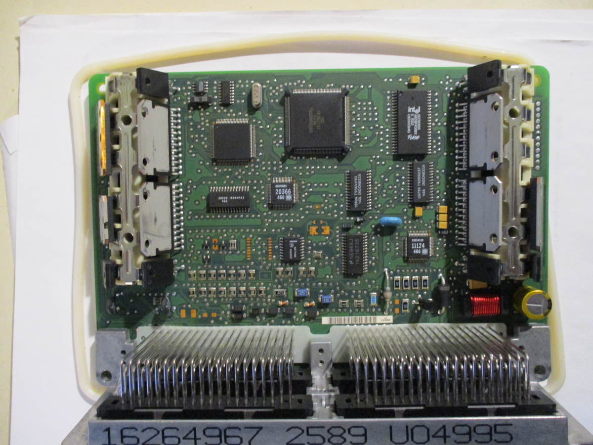

Does anyone know what micro-controller is used in the P04 for the V6's and P08/P10 for the L4's and L6's? Is it by any chance a M683xx flavor like in the P01 and P59? And if know one knows, how can you find out?

Thank you Gampy! I'm going to roll up my sleeves and see if I can get the BDM to talk to the P04 and the P10 I now have here on the bench. I've got a lot of exploring to find the correct probe locations on the mainboard. It's a lot different than the P01 and P59 PCM's. For starters, it has no convenient 90 pin header:
