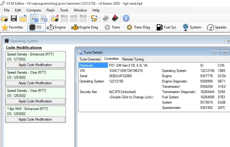

I recently purchased an 02 blazer V6 PCM from the states for R&D and this is the results.
HP Tuners custom OS options for the 12212156 OS.
02 blazer.jpg (103.63 KiB) Viewed 6985 times
i didnt realise this was the OS on it nor than it was so good for what it can do but im sure glad its the one i got!
i got it mainly because i wanted an 0411 to play with and also because i wanted to see what the low res V6 stuff was setup like and will be what im going to use for some 6 Cylinder conversion testing when i get the time!
