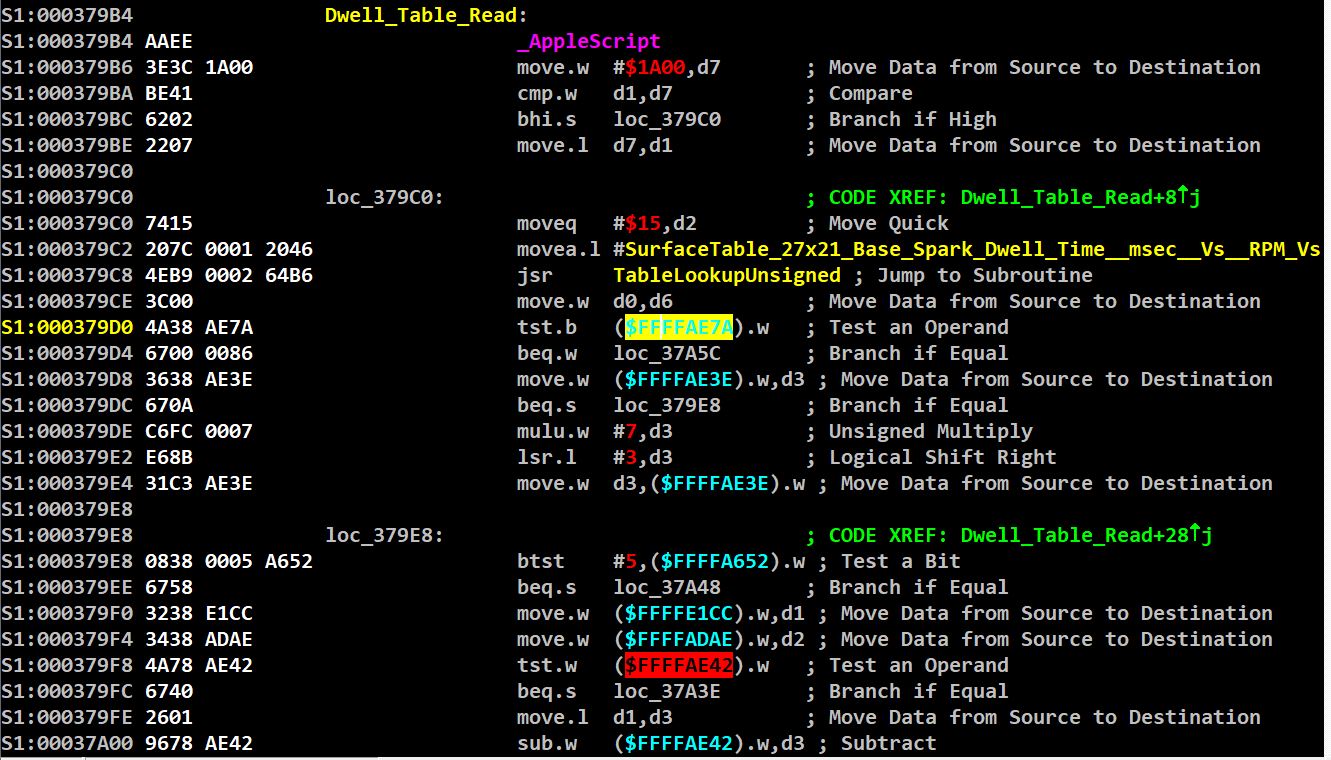

its been a while but i started looking into this more. i did some other testing on a truck with no cats and high flow mufflers. The results are exactly what i was looking for. what i did here just to see what needed manipulated was set the dwell time table from 4000RPM onward to 0 and in the retard test i also set both high and low timing tables to -10 degrees retard at 4000RPM+.
[youtube]https://www.youtube.com/watch?v=BDIZaT5PAfQ[/youtube]

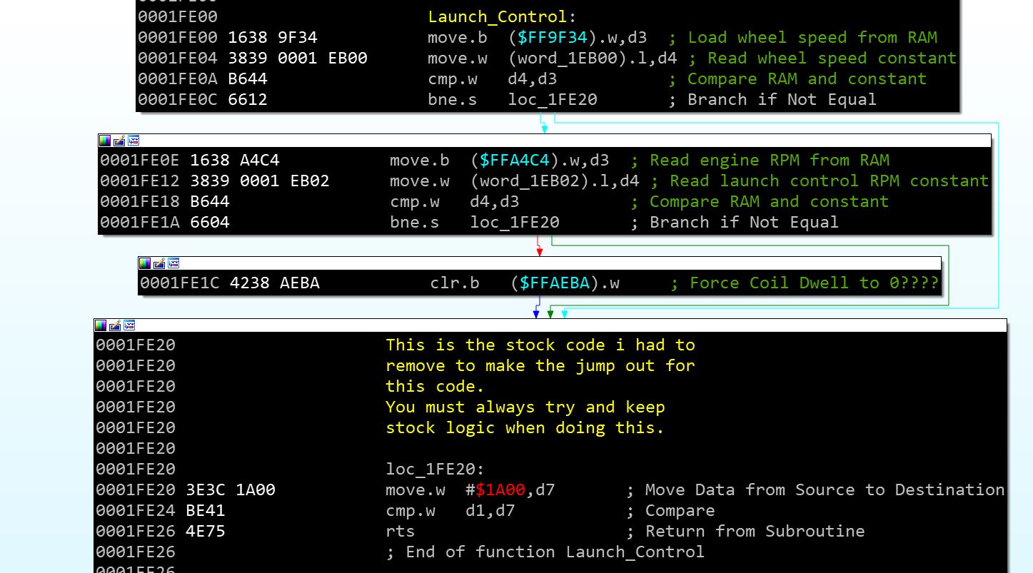

Now on to making the code for this actually functional. i have tried to use NSFW's script in IDA again to spit out a decent starting point for disassembly to find variables but i have not had any luck with it though this is what little information i have to offer without a decent disassembly of the code. The picture attached is of where i think the coil dwell table is accessed and the values from the table are placed into RAM. if im right this is an excellent place to make the jump out to custom code for launch control and flat shift, the jump could be made at S1:000379C2 to a JSR just like the next step below it. if the code is written correctly when the ECU gets to launch RPM it will force dwell time to 0 which makes RPM drop naturally and than the ECU will go back to reading the dwell table forcing the RPM to rise back to launch RPM and drop again giving the launch RPM limiter effect bouncing back and forth.
what i dont know where exactly in RAM the value from the table is placed. figuring out the RAM population is my current problem, i need to know where wheel speed, clutch pedal and engine RPM along with where the dwell time is placed to start, it will be another whole cam of worms to add the timing retard to it separately.

Re: developing a spark cut launch control solution
Well i went ahead and tried using an auto disassembly tool for IDA pro that i got from the VW/audi chip tuning world. Awesome success with it as far as im concerned. anyhow here is an IDA 7.0 disassembly that i made with at tool. This one has a good proof of concept and very basic launch control code added into it. it may work and it may not, i dont know and i probably never will as i dont own anything to test on. How i labeled things in it was thanks to NSFW's IDC script which i just looked at in a text editor to get me in the ballpark where maps and constants where than followed the machine code around in IDA to figure out the source in RAM for those tables or constants. i dont know this code as well as i know 8051 machine code so what i chose in RAM may or may not be right.
This launch control code is very basic. its based off of roll out from the wheel speed sensor. if you are standing still launch control can become active, as soon as you move launch control shuts off. i can also add a spark cut RPM limiter on to this fairly easy than when combined with the stock fuel cut it will be a genuine 2 step RPM limiter. say you want 2 step active set fuel cut at 6500RPM and spark cut at 6800RPM or vise versa if you like that spark cut drama.
One thing i did notice is that when spark cut is active like in the video above the backfiring does trigger the knock control and more excessive timing retard happens plus the misfire counter. have to look into those 2 and see if a way to set a bit in RAM when launch control is active that will force the ECU to bypass those routines completely.
