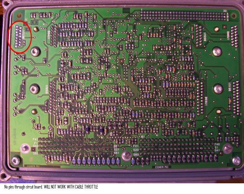

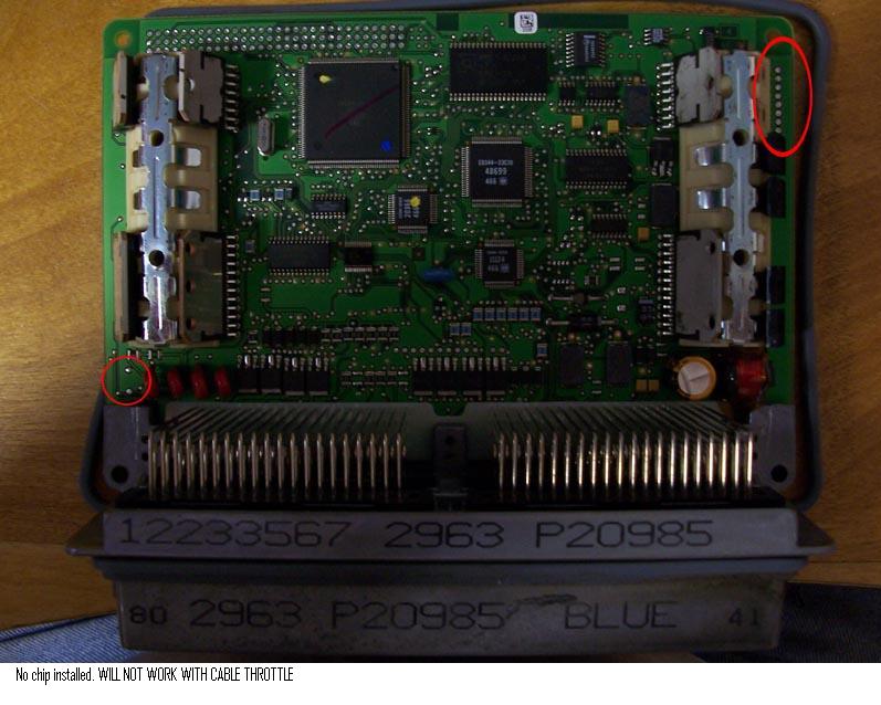

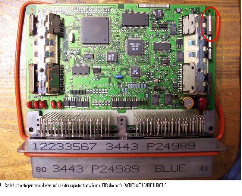

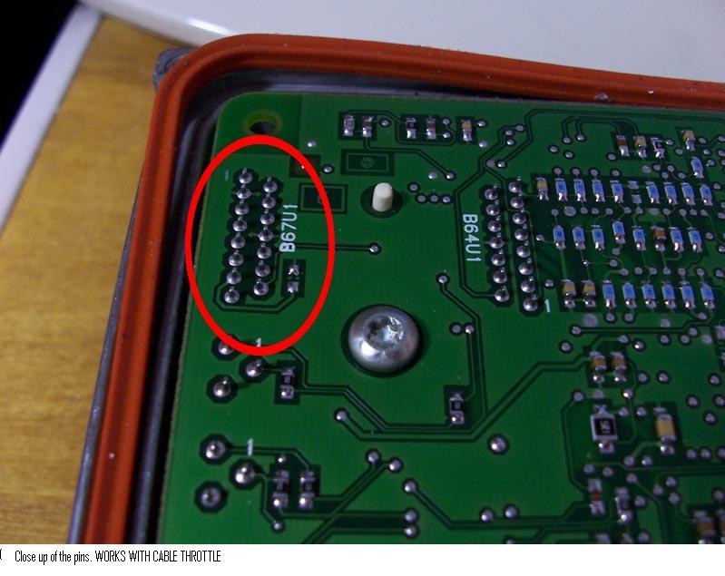

I'll just open them up and check for myself for drivers and chip type. I haven't been able to try PcmHammer yet till I get back to the shop tomorrow and use my Win7 machine. Does PcmHammer have a check utility to let you know what the saved file type is regarding Intel and AMD? Also does it have a utility to check the hardware without having to open up the case during in car programming? I wonder how BinBuilder would work if you mismatch stuff? Just thinking outloud
I grabbed and edited these pics off of http://WWW.LT1SWAP.COM and added notes to the pics.
