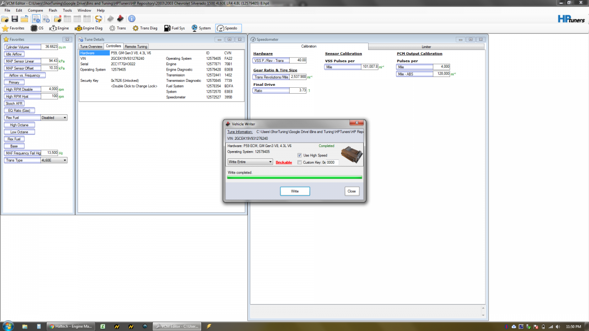

Post by ShorTuning »
Successfully flashed '9405 OS into a '162 Hardware P59.

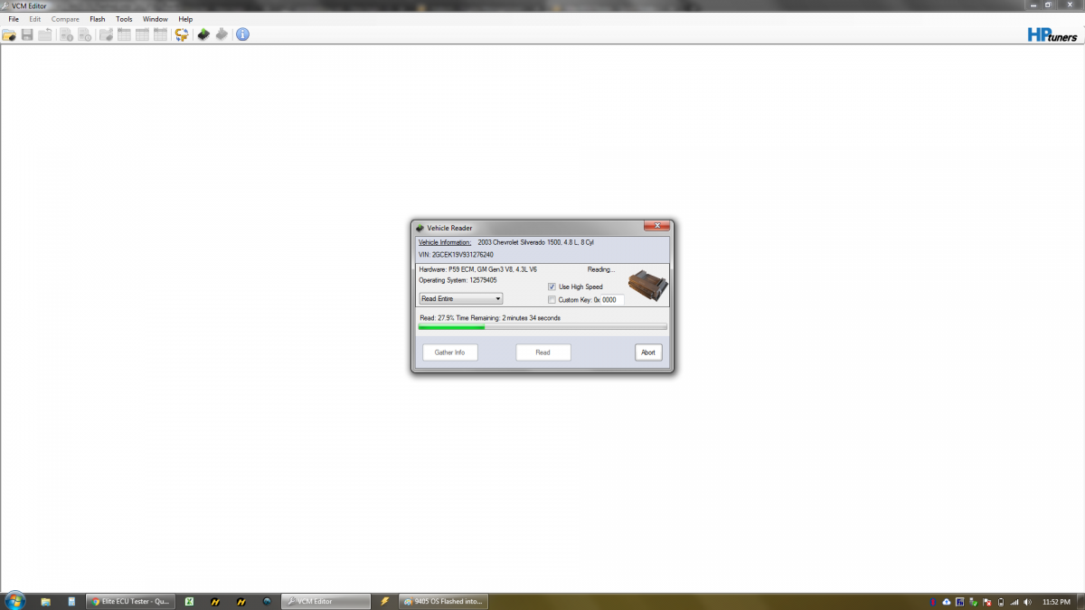

Re: GitHub repo for XDFs
Shut off PCM for 15+ seconds and powered it back up and read the file back out successfully. Did a compare file to the original pull and all is the same as well.
Now I know this is HPTuners and not PCM Hammer or other open source softwares but this confirms that it is in fact functional.

ShorTuning wrote:Worst case it bricks a PCM of which "may" be able to be recovered by resetting the chip.
We already knew it would not brick it ...
ShorTuning wrote:Successfully flashed '9405 OS into a '162 Hardware P59.
We already knew it would flash ...
ShorTuning wrote:Shut off PCM for 15+ seconds and powered it back up and read the file back out successfully. Did a compare file to the original pull and all is the same as well.
The tool doesn't matter, though surprised HPT allowed it, however, it was all a waste of time ...
You have proved absolutely nothing we didn't already know, and eluded to if not out right stated above, if you really want to test it, you need to run a vehicle with it ... Ensure it saves it's parameters and it's not throwing codes.
Of course without disabling the thrown codes!
A simple VIN change (as stated above) would of made this a lot more worthwhile and not such an absolute waste of time!
