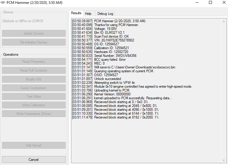

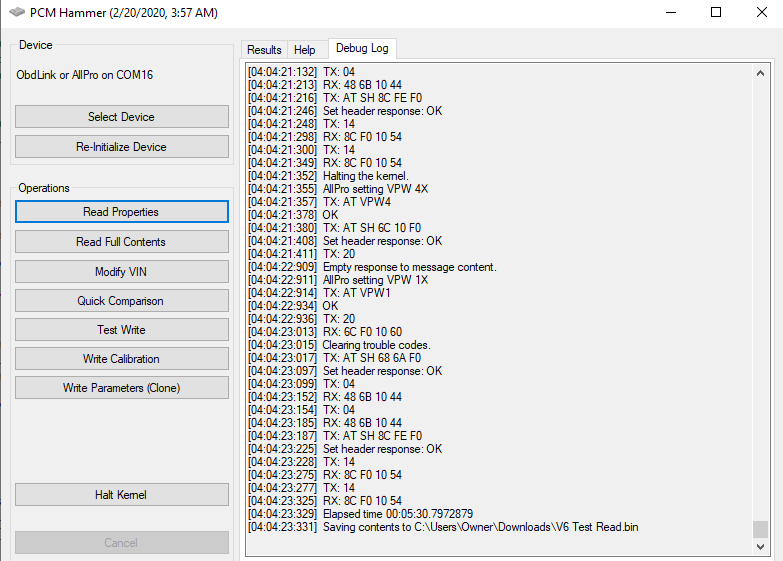

Just gonna leave these here.......
Xpro Elm.PNG (45.61 KiB) Viewed 6255 times
Had to make a few tweaks since I was doing this over Bluetooth but it ended up working....
V6 Read Complete.PNG (44.69 KiB) Viewed 6255 times
There are a LOT of things that were a bit sketchy and it had to request a number of blocks multiple times but given the number of possible variables that could have been the cause and the fact I not only hacked a kernel from Ls Droid into this but also hacked an OBD Xpro VT in using Elm commands over Bluetooth I'm pretty amazed it even worked :punk:

Keep in mind that is a very old version of the pcmhammer code base, and not a kernel are likely to use. It is very cool to see, but it doesnt mean v6 support is nearly ready. P59 full flash support nearly is, and that is what we have been looking at first. Once thats out, and time permitting we'll move on to P04.
