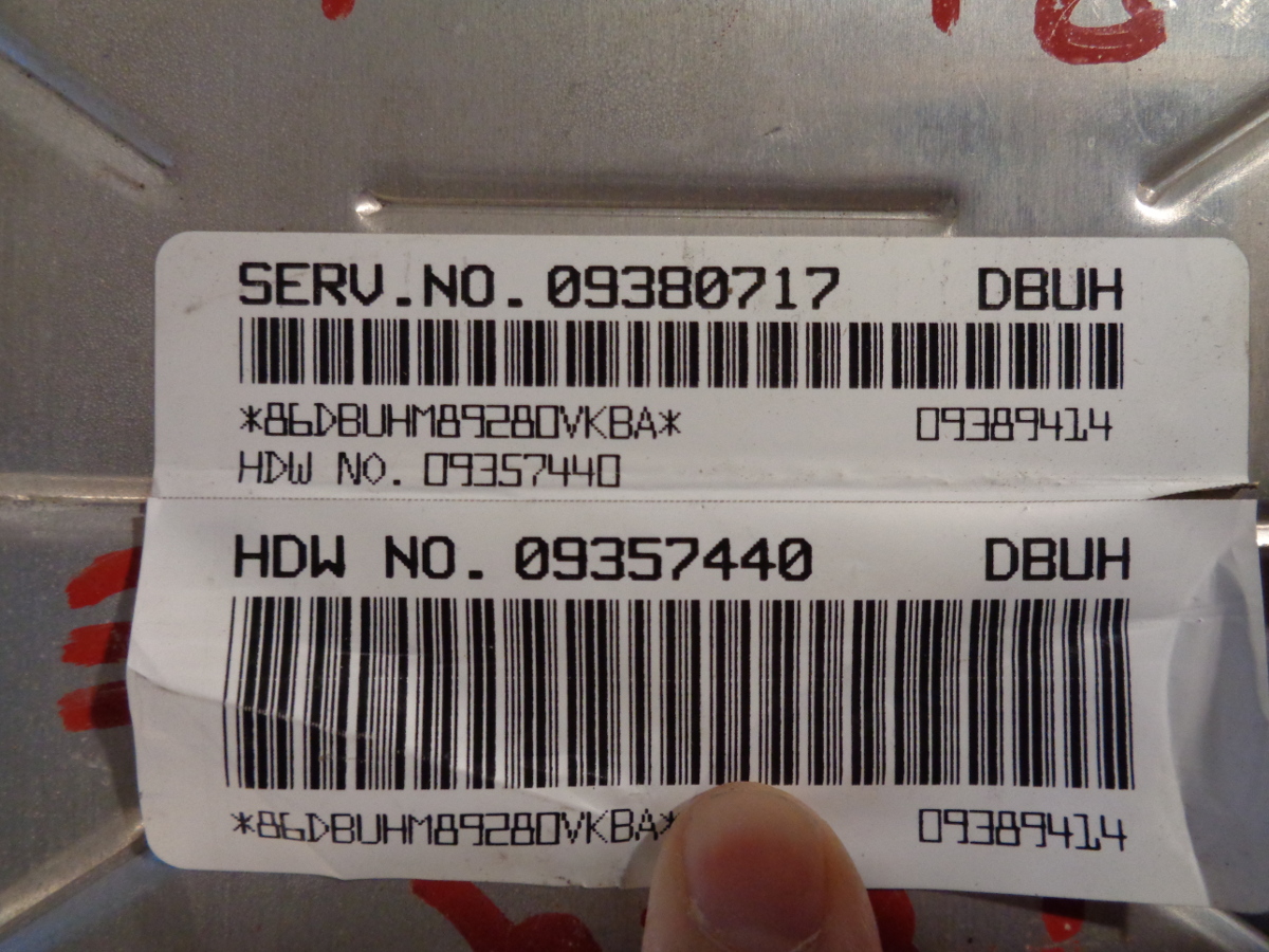

I am super grateful you have shared this list! But I have a question:Vampyre wrote:Here is a complete list of every P04 OSID I could find from GM its about 1400 from 98-05 also sorted them by yr and hardware found in
I'm unable to find my hardware number in your list, but my service number shows up. Are you using the term "hardware" to mean service number? Because there is also a hardware number associated with each service number. The hardware number from my experience will let you know if it has the IAC driver, or not (it does with the P01 and P59 PCM's). The P04 I have on my bench has a service number 09380717, and hardware number 09357440.
-David
Re: V6 ability for pcm hammer.
yeah sorry should have been more specific, the service number is usually what we use to identify p04, it changed with every little revision gm did, things like place made or different part used would change the service number so it makes it easier to dentify which you have and what yr its from

Well, the list you have compiled is amazing!Vampyre wrote:yeah sorry should have been more specific, the service number is usually what we use to identify p04, it changed with every little revision gm did, things like place made or different part used would change the service number so it makes it easier to dentify which you have and what yr its from
