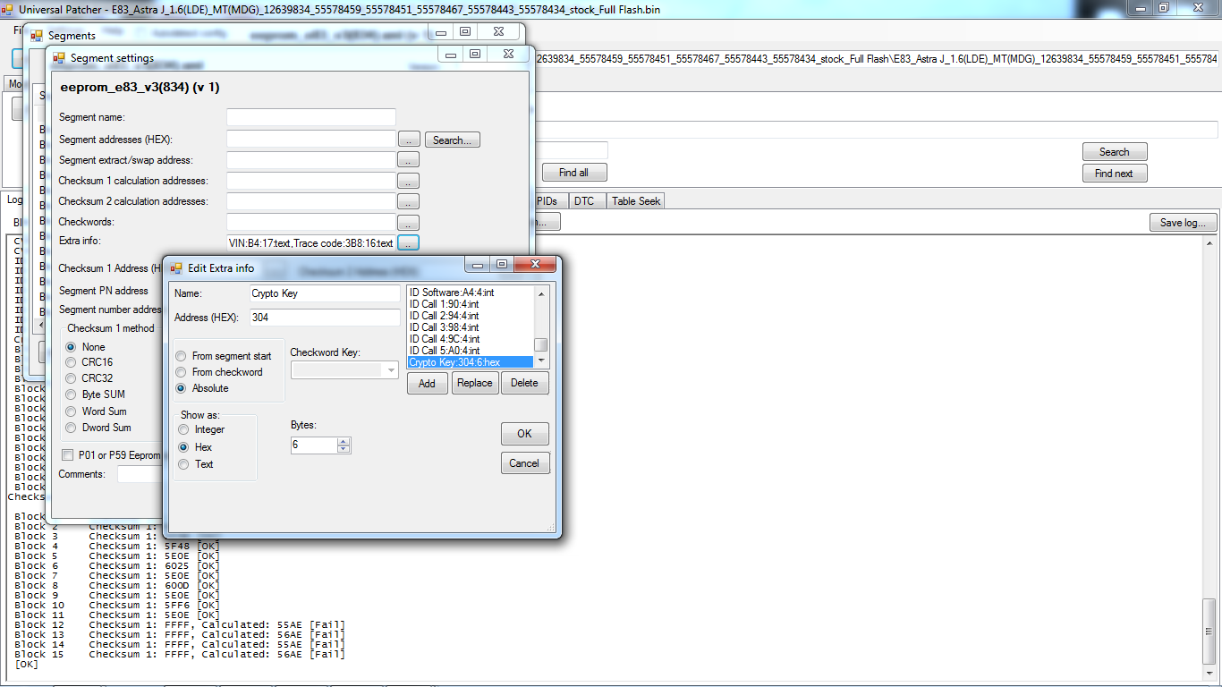

Thank you very much!Everything worked.There is still a wish.When working, I need to display some data in HEX.When creating XML in the "Extra info" item, if you select HEX values longer than 4 bytes, only 4 bytes will be displayed,and I need more.If you select text, any number of characters is displayed.If you fix it, I will be grateful.
Re: Segment Swap utility
malets84 wrote:Thank you very much!Everything worked.There is still a wish.When working, I need to display some data in HEX.When creating XML in the "Extra info" item, if you select HEX values longer than 4 bytes, only 4 bytes will be displayed,and I need more.If you select text, any number of characters is displayed.If you fix it, I will be grateful.
Fixed in 0.16.27
