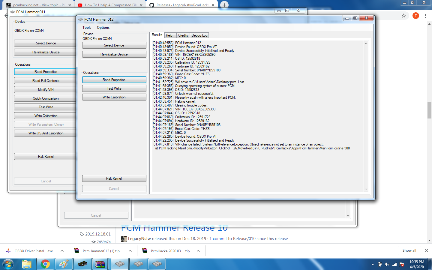

So the 012 version I have does not give me the option to read full contents, which is the only way to save the bin file correct? Do I need to change something on my end to make it work? I installed 011 and it has the option to read full contents, but when I try it says unlock was not successful. What am I missing or doing wrong?
Ill post a screen shot of the 012 and the 011.
Please take it easy on me, I am by no means a computer guru, I am a gear head wanting to learn. I am pretty confident in megasquirt, but its much easier to get into than PCM Hammer.
Thanks for all you have done!
and
Thank you for any help!

Re: Problems connecting to PCM Hammer
Always use the latested version of pcmhammer.
Looks like its failing at unlocking the ecu... so either it has an unknown algorithm, is in some sort of recovery mode or is tuner locked?
Will need to probably add some more debug information to screen to capture whats being received/sent. I can do that later today.
*Edit
Please post what displays in the debug log.
*Edit
Some buttons were moved to the Menu in version 12.
Look under Tools on the Menu ... You will find "Read Entire PCM".
Please attach a Debug Log (in Text format. (ie Notepad)) from version 12 trying a "Read Entire PCM" from the Tools menu.
As Tazzi stated, it is failing to Unlock and a Debug log will give us more detail.
Thank you
I tried it this morning and everything worked great. Got the bin file saved, and now I’m looking to get the XDF so I can open it up in tuner pro. I believe I found what I needed, I’ll give it a try later today. I’ll post back with results.Tazzi wrote:Always use the latested version of pcmhammer.
*Edit
Thanks!
Awesome!
It looks like you have OsID 12592618, you must have the correct XDF for that OsID.
If you find an XDF for it, I would be interested in it as well.
I am not very computer savvy, I know enough to be dangerous with one. After googling, I came across this link, which has an XDF file for 0411 PCMs. Is it for all 0411s? I really don’t know. I’m just playing on a bench so nothing can be seriously harmed. Honestly I’m able to get my hands on 0411s pretty easy so if i brick one on accident I won’t be out much, not saying I want to brick one.Gampy wrote:Awesome!
tonyorlo,
If you have a PCM with OSID: 12592618, you do not have a 0411 PCM. You have a 2005 P59 PCM. I personally do not think there is a XDF for the OSID you have there. I can be wrong though...
EDIT: Look for the service number on the sticker of the PCM you presently have (if it's still there). It should be either a 12589462, or a 12589463
Hope this helps
Hope this helps
DavidBraley wrote:tonyorlo,
Hope this helps
David,
I apologize, those screen shots where from when I was messing with version 009, using the mock devices. I really came into it blind, but quickly realized I was messing with a “dummy vin”. I am not sure what year the pcm I am using is, but I did crack it open and it is a 0411.
