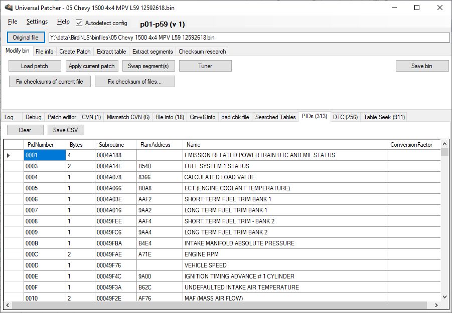

UniversalPatcher can find some RAM addresses.

That's really cool, I could see that being very useful for reverse engineering. Could you export the PIDs, addresses, and names to a CSV file?
Then we could write scripts to import the CSV data into IDA or Ghidra.
The more RAM addresses you label in IDA and Ghidra, the easier it gets to figure out the code that uses those addresses.

NSFW wrote:That's really cool, I could see that being very useful for reverse engineering. Could you export the PIDs, addresses, and names to a CSV file?
Already does ... Well actually, it's a Semi-Colon separated value file.
