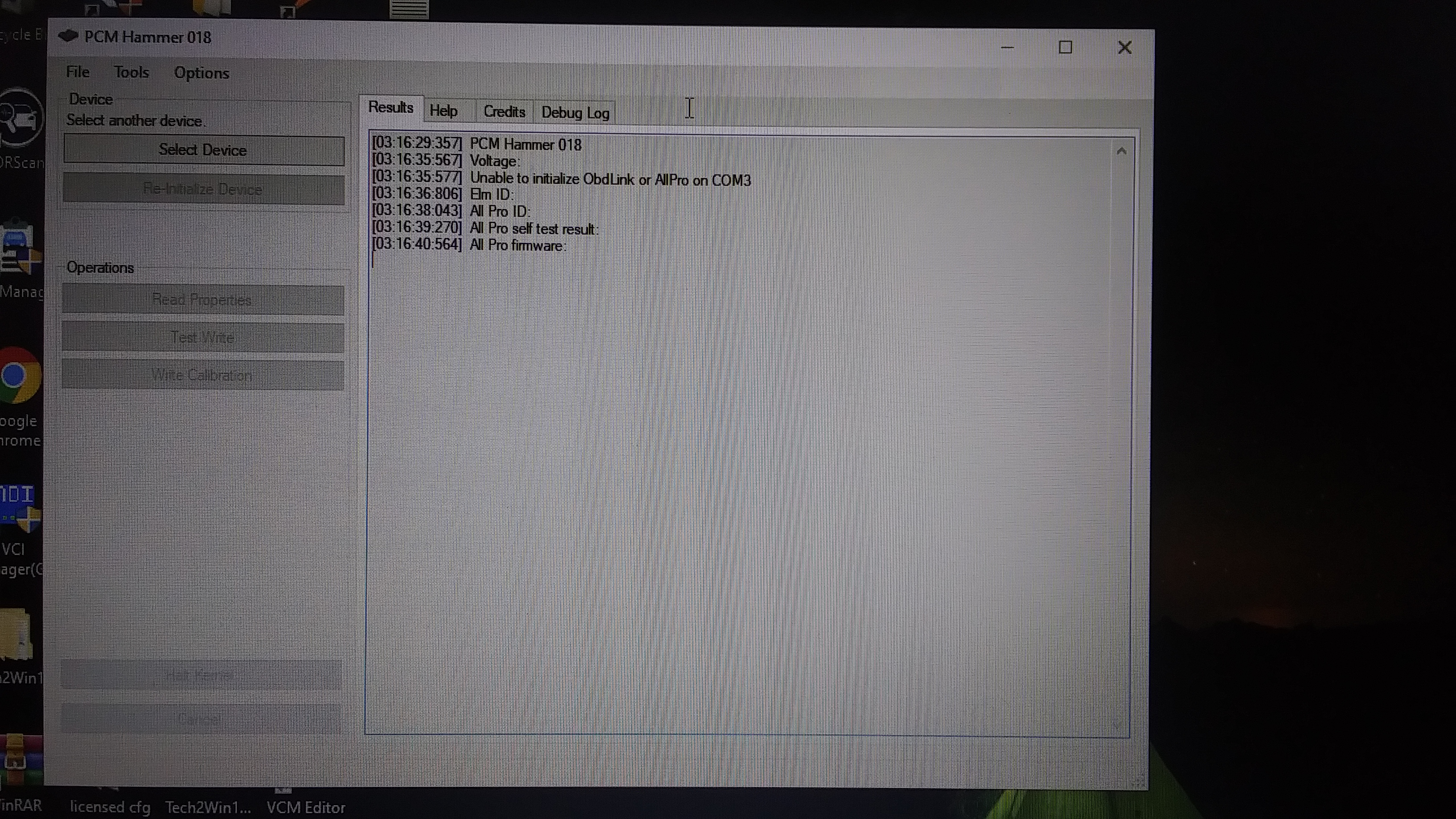

So I tried my elm327, which works with forscan as well, and ran into problems. Hammer sees the device. If I choose avt 852 or obdxpro it just fails and I can continue, but if I choose obdlink or allpro as device type, it tries to communicate with device, but doesn't and then program hangs. I have to use task manager to close it. Here are pics of log when it happens. I can't leave cable plugged in or program hangs trying to initialize device when it starts.

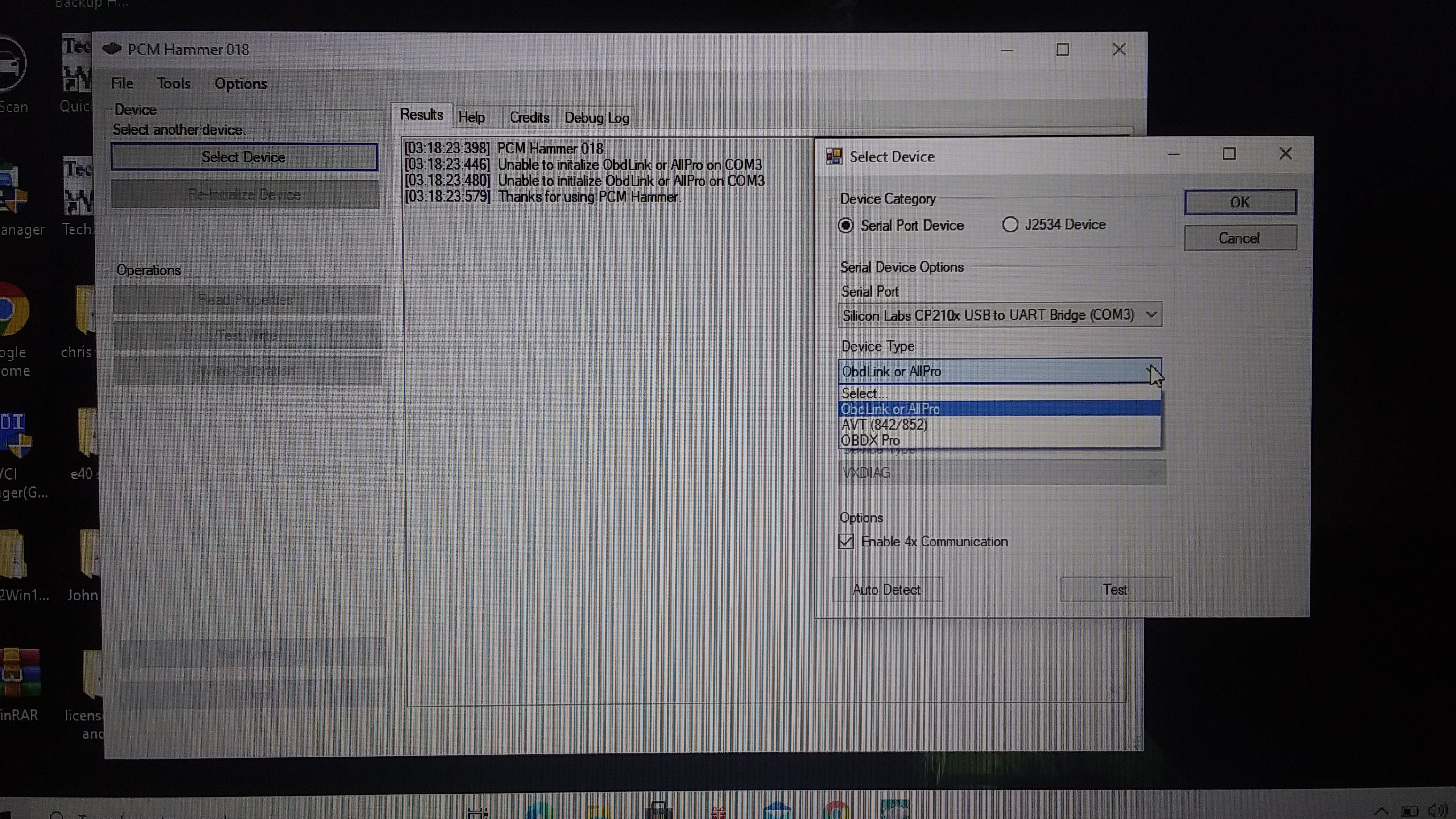

Here is a pic of what hammer sees when I plug in the elm.
Re: Vcx nano error 126 using PCM hammer
Not all ELM devices are the same ... Some will work, some will not!
You would select, "ObdLink or AllPro" and the Comm port ...
We need to see the Debug log ... Please post a Debug log in Text format, i.e. a Notepad file (not a screen shot image).
