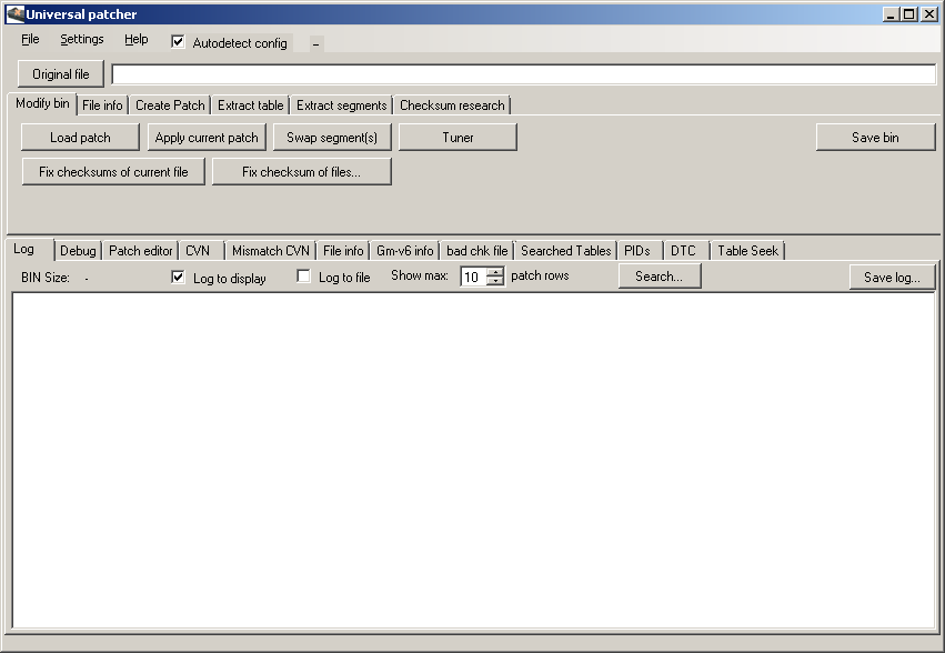

Re: 0411 PID's for EGR pintle, AC pressure, fuel pressure
You need to open Patcher in Advanced mode ...
When you first Execute UniversalPatcher.exe it opens a UniversalPatcher dialog with 3 mode options, select Advanced, then select button Patcher.
I personally don't understand the logic there, it's an extra form that's in the way ... I'm sure joukoy has a reason, it may have to do with the overwhelming amount of things Universal Patcher can do!

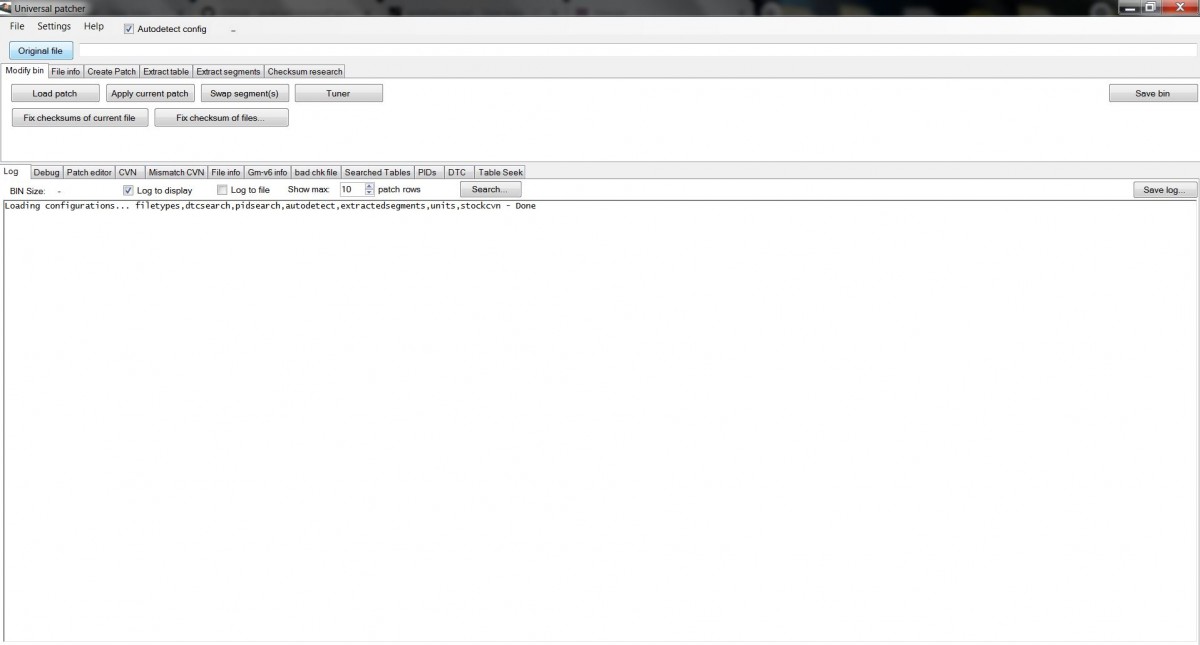

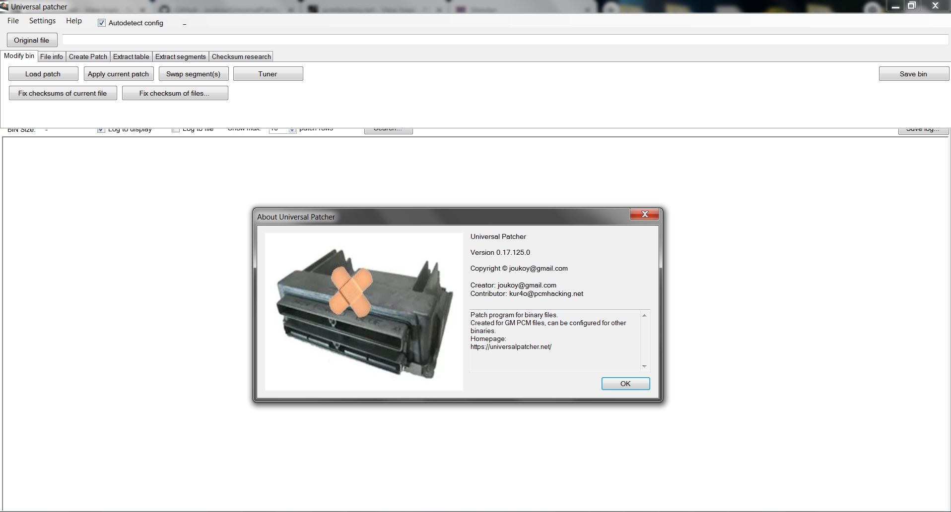

Thanks Gampy. This is what it shows. Looks like something funky in the GUI?
Yea, looks like it ...
I suspect joukoy would like to see that.
Have you tried stretching the size or maxing the window.
When it first opens this is what you should see ... Note the row of tab pages about mid screen. [edit]
Sometimes settings go bad, you might try deleting directory
