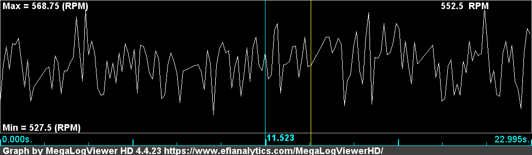

Okay i testes it and got the same problem. i found though if I save the file even without change it works not sure why i took one log and opened it and saved it as (file name2) then it worked. got me thinking that maybe the changes i made didnt matter so i opened one with the clocktime column name just saved no change and it works as well. just never save an file I opened that i didnt change, why would i need to. just weird. ill attach the files and a graph images of both files open in the log viewer.Gampy wrote:Simple change that I don't think anyone would mind ...Boostedforlife wrote:Yes the column name if changed from Clock time to Date, log viewer works fine but if you leave it Clock time it piles all the data on top of itself ( can't watch the log in playback mod).

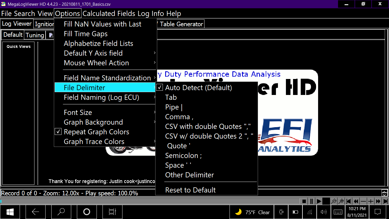

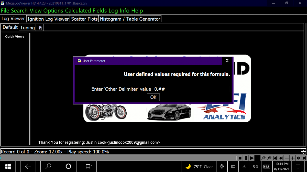

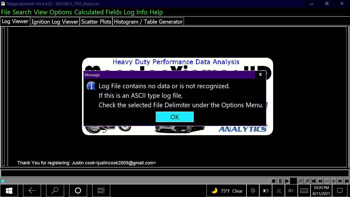

This is an update on the test. With the format (0.##) the mega log viewer will not load the file at all i get this
In the other delimiter option it allows you to define your own values
I've tried all kind for things in here just dont know what they want. tried 0.##, 0.00, (0.##), "0.##", "0.00" What else?
Side note with the format (0.##) even with saving in excel it still wont load
so I screen shotted the delimiter options hereIn the other delimiter option it allows you to define your own values
