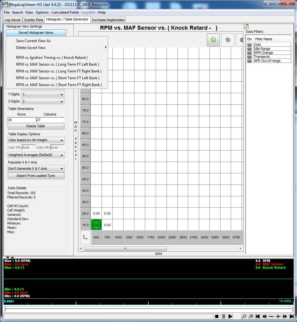

Version 7 uploaded. Fixed all but 2 engine cal parameters.

Version 8 is now available at the link above. All diagnostic fields have been verified\fixed, All parameters sorted, previous issues resolved, and a few descriptions added.
Again if you find a problem please let me know.

Good deal! Make sure you grab the latest one as there were some issues. I've tried my best to make this at least as good as one of the commercially available softwares. I've verified every parameter that has a name like "letterxxx - "

Glad I could contribute. I don't ha e a running setup yet but I suspect I'll have to do something similar with an admx unless you have that has been fully vetted, but with pcmlogger and logviewerhd there isn't much of a need for it except to just keep it all in one app.

LOL no doubt! I tried fighting with admx before I started the xdf and quickly decided that I needed to work on low hanging fruit instead. I've look at others til lI was blue in the face and wasn't able to covert from other well established admx for other cables into elm327. I mean the others handle them in hex and in a different format and I realize elm327 is sent in ASCii but come back in hex, but I couldn't get it to make since. I'd be more than happy to put in the time converting and making a good admx for the ODBX pro but I guess I've ran out of talent. It would be super sweet if the creators of of the OBDX Pro would write one up. I really appreciate pcm logger NSFW. With it and megalogviewer HD I think I have a commercial equivalent setup. Since I don't have a running setup yet if someone could send me some complete logs of their vehicle run\driving I'll finish making histograms and post them up. When I say complete I mean just about everything all in 1 log file not just the 2 default setups in pcmlogger. I'm still very very new to EFI tuning so maybe I'm thinking I need more data than I really do.

Version 9 now available. A couple new parameters, additional comments, sorting.
