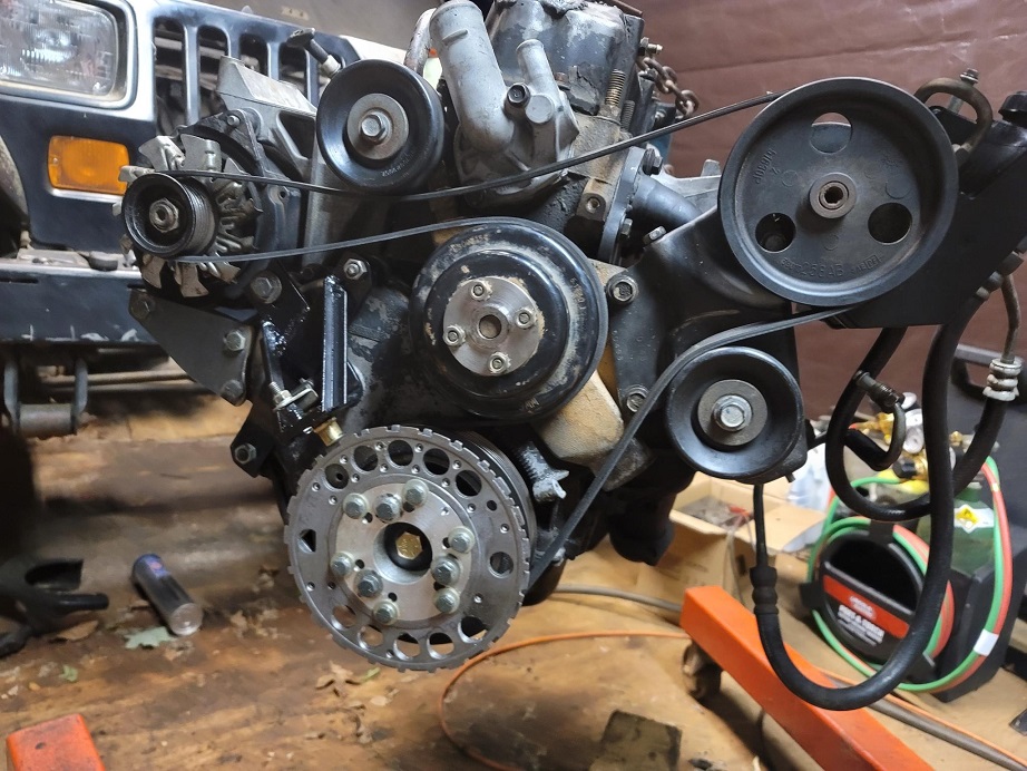

I had the opportunity The last couple of days to make a little progress. I got the crank reluctor mounted and I think I've got the "0" position figured out.
Here's some pics of the reluctor and crank position sensor.
As soon as I can get the engine back in the Jeep I'll start running wires.

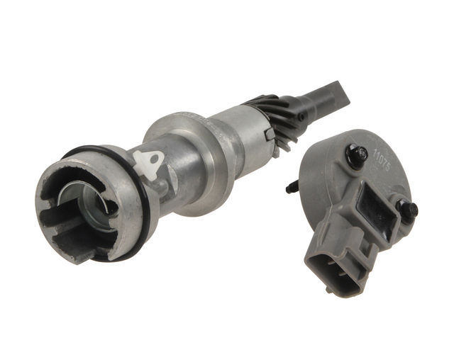

I'm going to be using the cam sensor from a 2004 4.0L engine. It's a drop in part and gives a 1x signal.

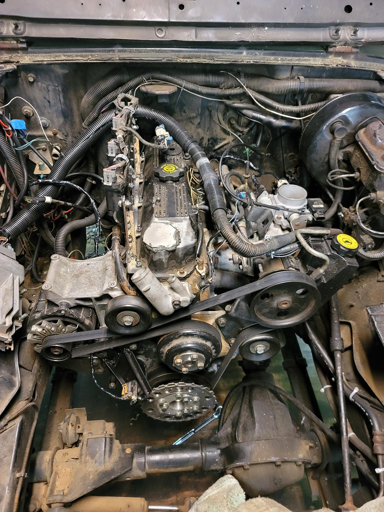

It went from this.
2.5l jeep1 resized.png (2.16 MiB) Viewed 6402 times

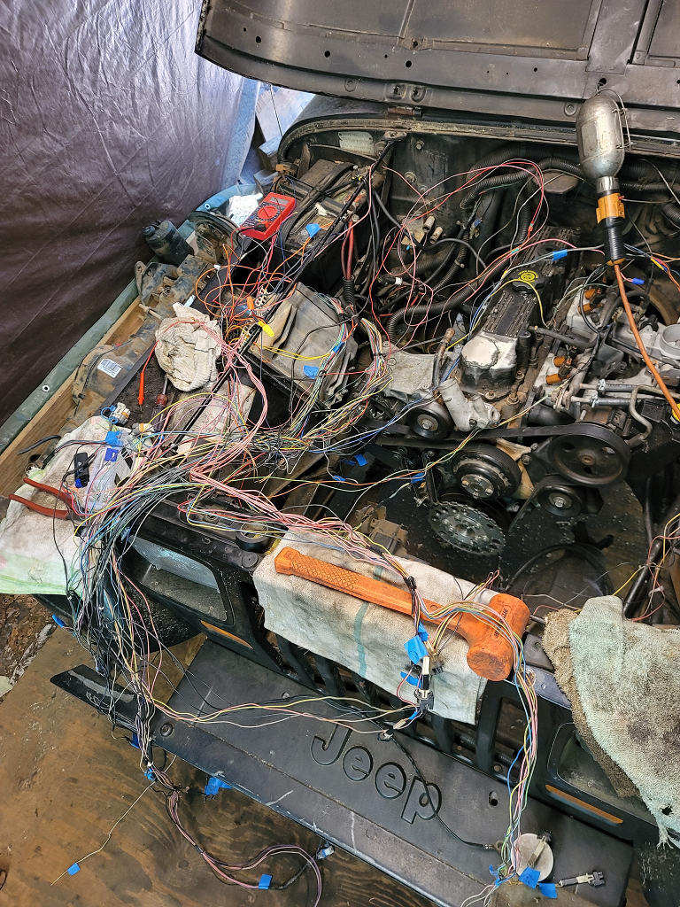

To this today.
2.5l jeep resized.png (2.07 MiB) Viewed 6402 times
Bad things happen FAST!!!
