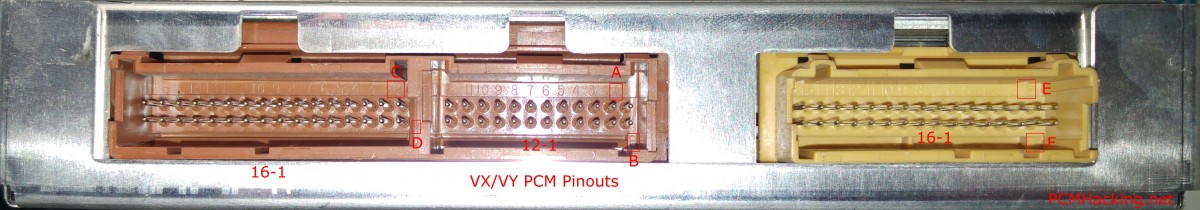

The information is in the thread above, but heres a pic which shows the socket labels on the PCM. Note that the sockets are out of order. That is, we have the original 808 style connector (with different keyway) for a+b in the middle, and c+d on the end, then we have d+e which was added with the PCM models on the other side. You can see the red squares where I have noted where you can verify the port letters at the back of the connectors on the PCM. Click the pick to zoom in for a closer look.

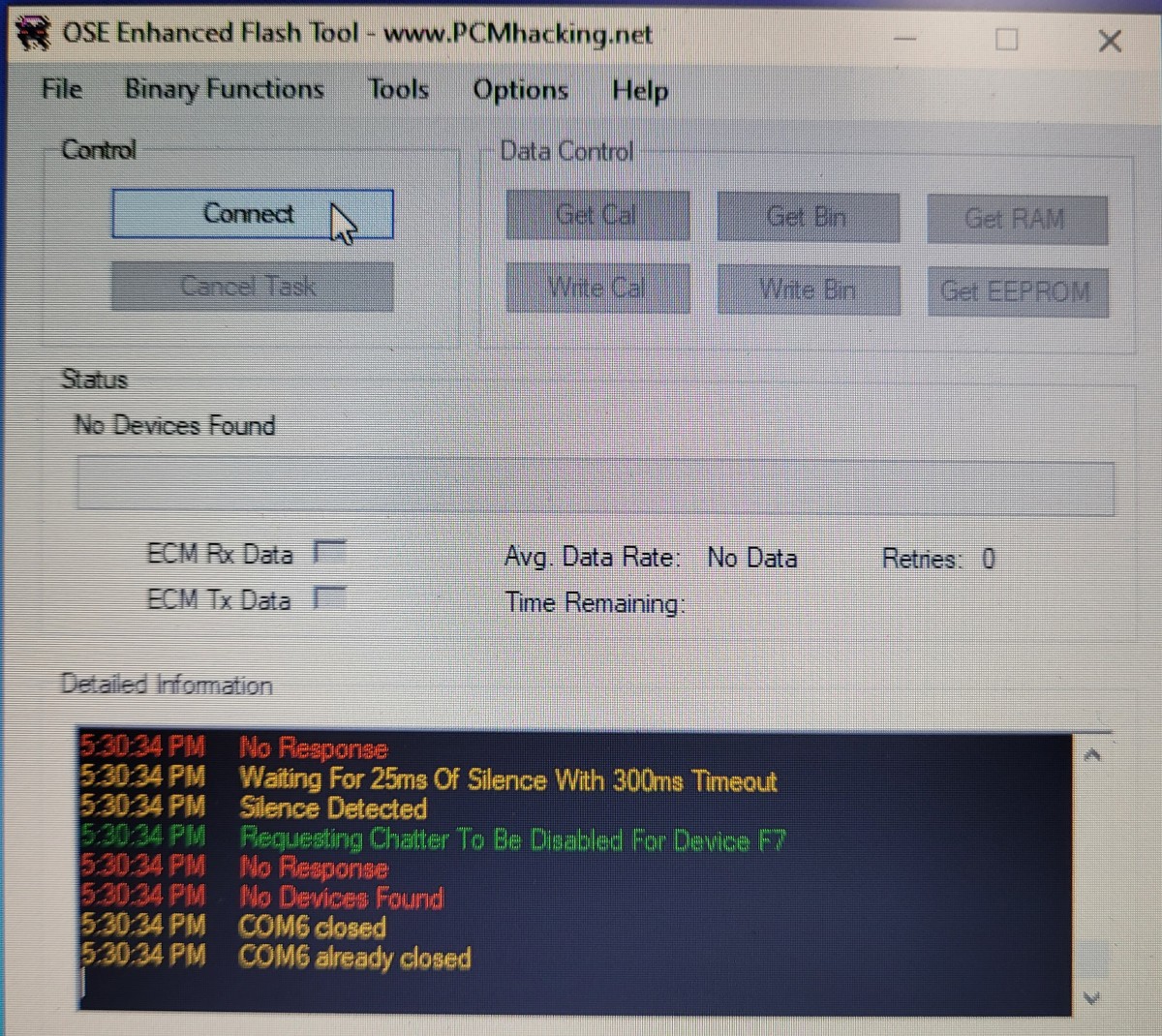

I carried out the bench testing procedure as per this article but could not get OSE Flashtool to connect with the PCM. There is no return transmission/connection coming from the PCM.

show us how ypu have the flashtool set up?
