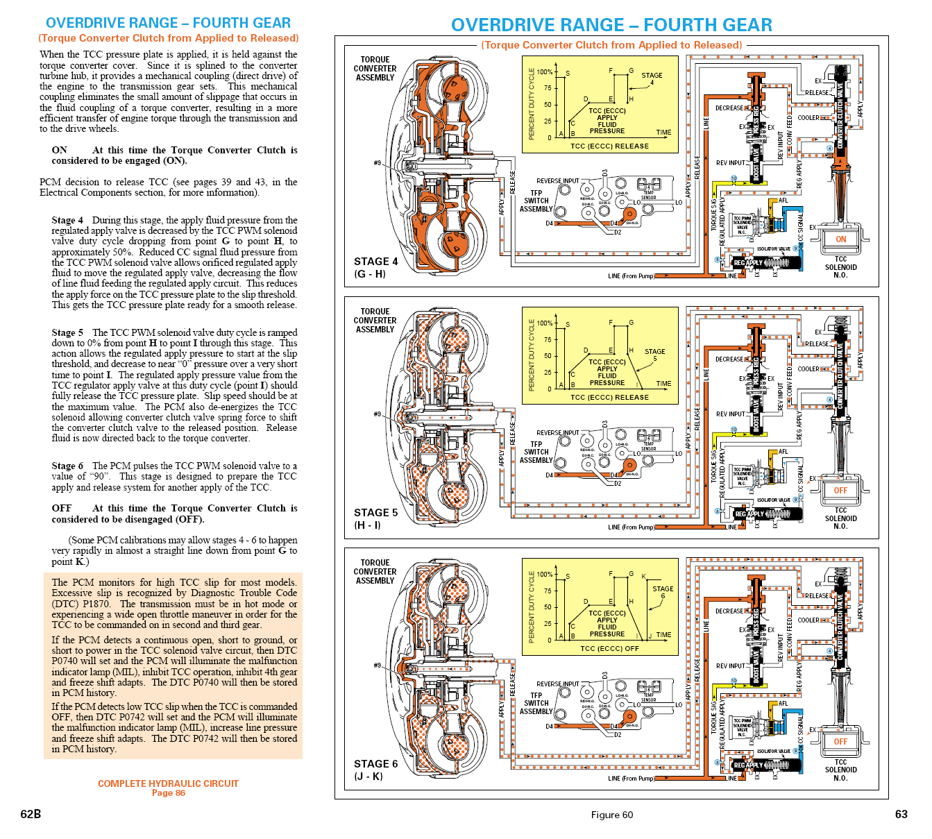

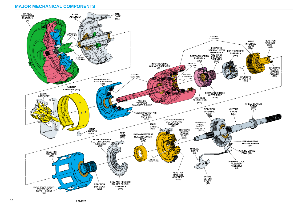

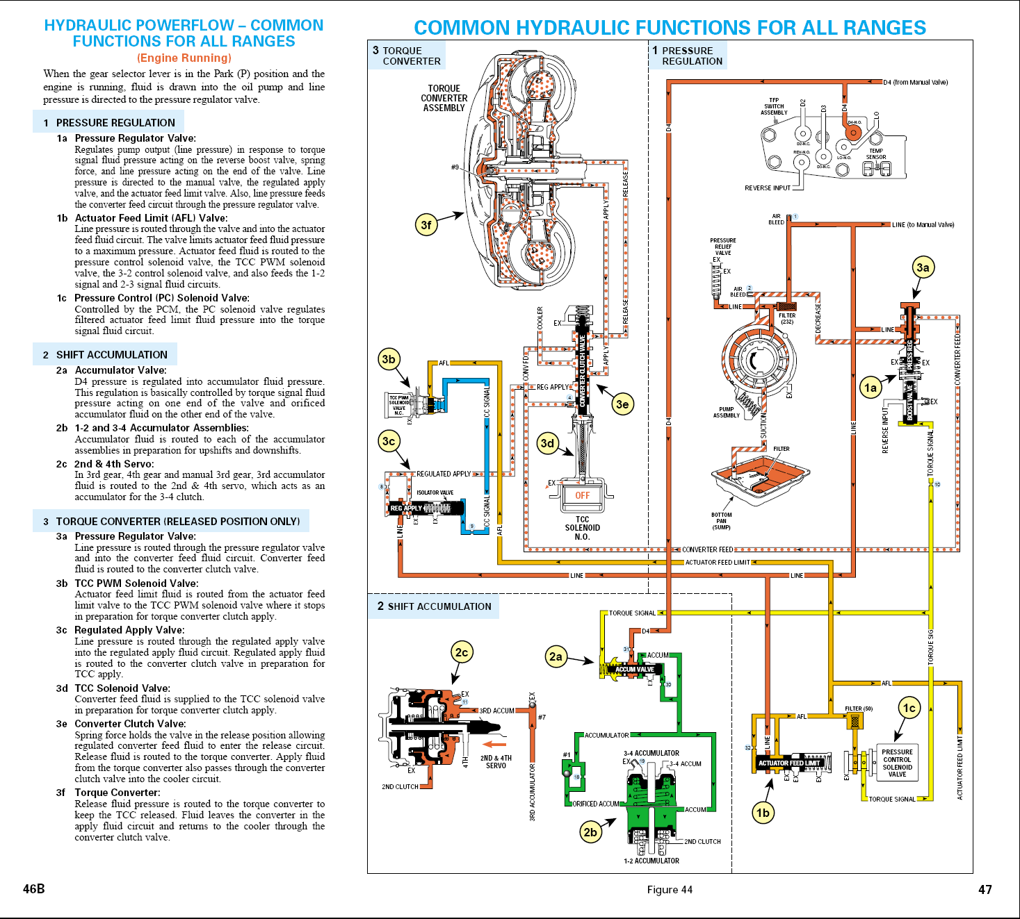

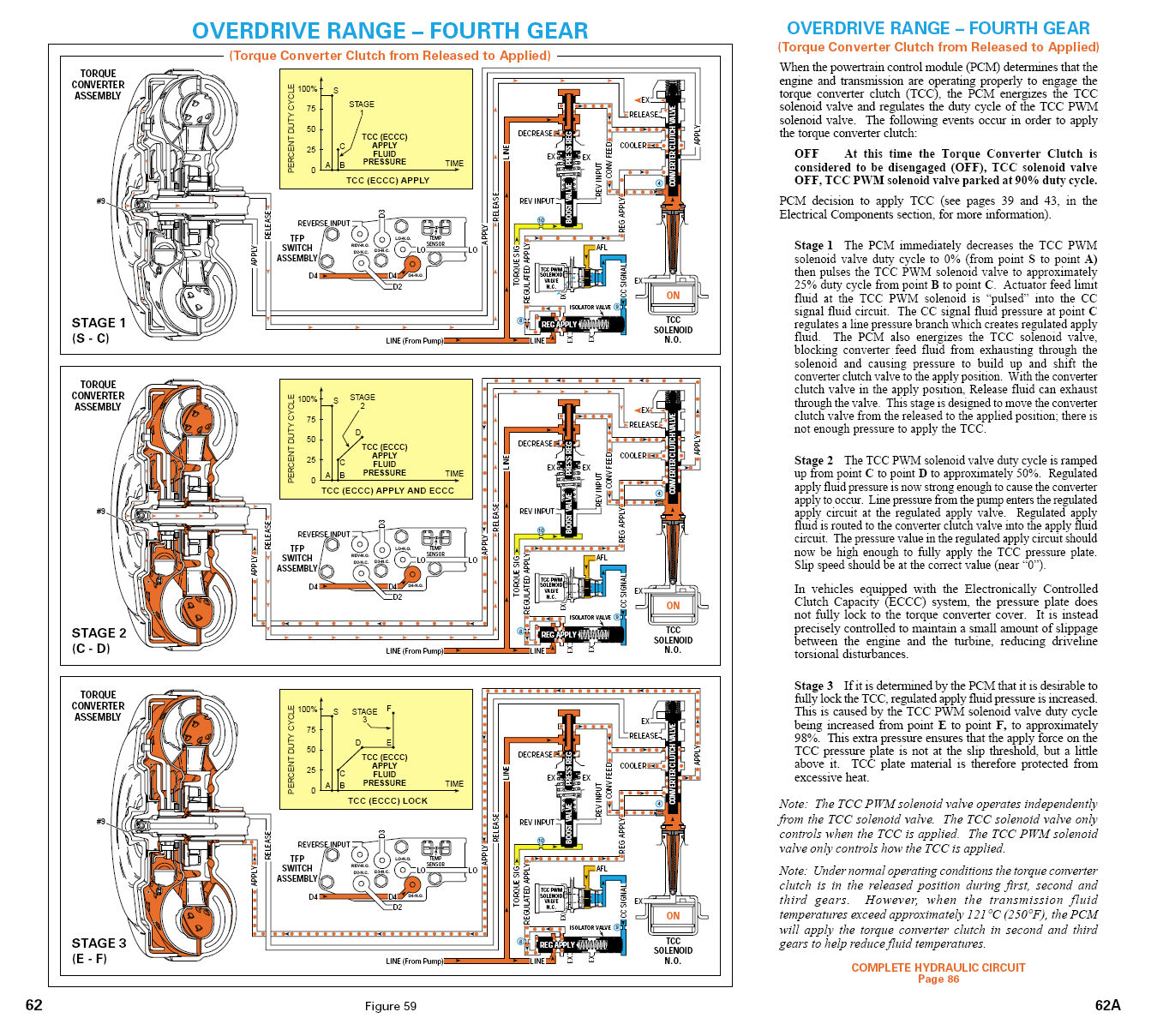

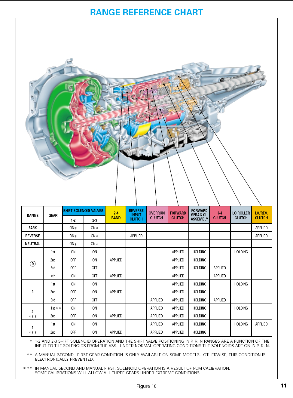

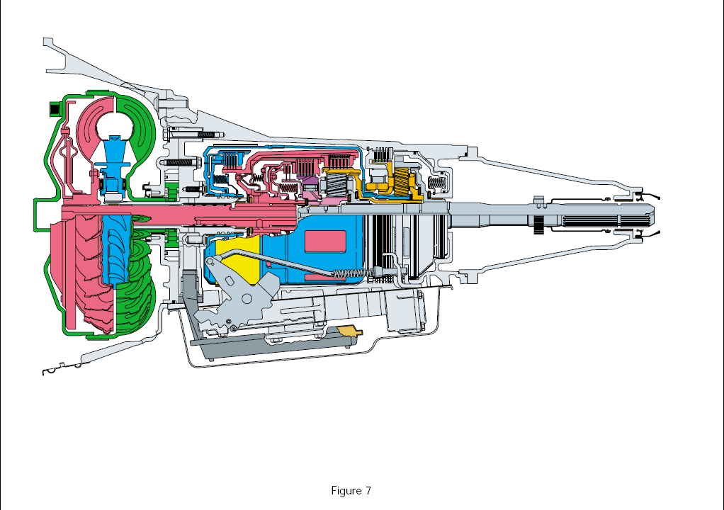

in an attemp to fully understand the PCM controls for the 4L60E im starting this thread it will be a work in prograss to hopefully bring all the info i have into one and help as a guide to help with auto settings tuning.any input/info on settings etc feel free to comment.heres a bit of a gearbox description and stuff for a start will add more tomorrow
- 4l60esidesectionbc1.png (149.56 KiB) Viewed 7846 times
- 4l60ecomponentsil7.png (450 KiB) Viewed 7871 times
- 4l60erangechartkf3.png (460.24 KiB) Viewed 7868 times
- 4l60ecommonah3.png (452.85 KiB) Viewed 7863 times
- 4l60etcc1vu7.png (543 KiB) Viewed 7853 times
- 4l60etcc2hs4.png (565.48 KiB) Viewed 7848 times
