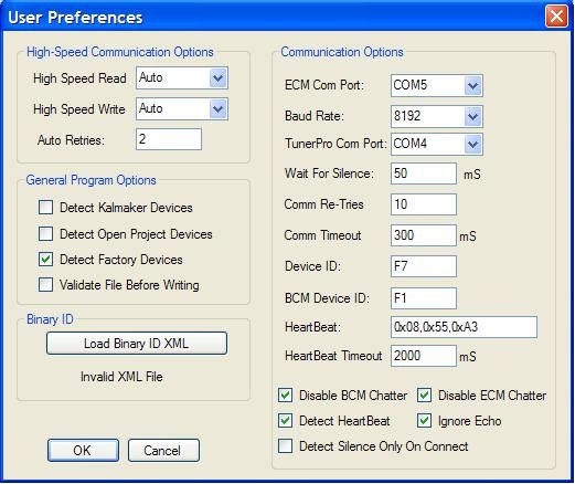

The following information has been provided by Mick. Great work, the flash programmable delcos are nearly ready to fly
Thanks to VL400 you can now download the full calibration from the ECM on your VX, VU and VY Holden V6 using OSE Enhanced V1.15. Might I say this has been tested On and Off Vehicle and the results are quite “Confident”.
Below are the preference settings that I used to bench test with and there might be a few things that need explaining.
The interface cable that I use for GM OBD1 is a Moates unit found here: http://www.moates.net/product_info.php? ... cts_id=128
I’m sure other EFI-DIY combinations will work, best to test on the bench first.
1: I did not play with any of the High-Speed Communication Options at all, what you see below ‘Auto” and Auto Retries = 2 is good to go by default.
2: General Program Options. When downloading from a factory ECM you only need to search for Factory Devices as having the other options selected will only slow the quick process of unlocking your ECM.
3: No need to play with Binary ID as the application will supply this information on the log screen when the ECM is identified.
4: Communication Options:
• ECM Com Port: The USB Interface when plugged into your PC will be allocated a com port number. Once connected, go to Device Manager and check Ports (Com & LPT) Look for the allocated port number of the USB Serial Port (Com X). As you can see from below I have allocated COM5 as the ECM Com Port. Yours may be different.
• Baud Rate: We use 8192 here.
• TunerPro Com Port: Not used, I just made sure that it was different to the ECM Com Port selected.
• Wait for Silence: I found that for bench testing 100ms worked the best overall. On vehicle dumping I used 50ms. The bus was pretty busy as the BCM is the master and it tends to clog the bus a little.
• Com Re-tries: I bumped this up to 10 just to make sure the messages got through. By default it is set to 5. This is ok.
• Com Time Out: For bench testing I used 200ms. On Vehicle I used 300ms. I saw a few NO Responsive messages in the log session and this is what worked best for me.
• Device ID: This is the allocated ID number in hex that references the ECM. For these little puppies you need to use F7.
• BCM Device ID: Body Control Module is the Master. The device ID allocated is F1 in hex.
• HeartBeat: Well this is a frame that is sent out on the bus by the BCM (0x08, 0x55, 0xA3). OSE looks for this frame as a jump in to the bus. Directly after this frame you will find the longest period of Silence.
• HeartBeat Timeout: This is set to 2000ms by default. I had no reason to play with this as it works really well.
• Disable BCM Chatter: For bench testing you don’t have this selected as there is no BCM to shut down. When connecting to the vehicle you need to select this to shut the BCM up on the bus.
• Detect HeartBeat: As the BCM is the master it sends the HeartBeat Frame onto the bus. When bench testing there’s no BCM and no HeartBeat. No need to have this selected. When you connect to the vehicle you need to select this as it makes things very smooth when connecting to the ECM.
• Detect Silence Only On Connect: If you have issues with error messages in your session you can select this. What will happen is OSE will look for silence before sending each command frame to the ECM. Works very well!! As you can imagine it will slow down the time it takes to dump the bin or FIND THAT KEY (Brute Force). For bench testing with no BCM having this selected works well. Some vehicles might like this un-selected to improve the Coms.
• Disable ECM Chatter: Have this selected for both bench testing and on vehicle bin dumping.
• Ignore Echo: I just leave this selected for both bench testing and on vehicle bin dumping.
• NEW OPTION: Erase before write - Always select this option. If you do not you will corrupt the PCM when any changes are made.
• Once you have selected these settings, click OK to save them.
Bench Testing Preference Settings On Vehicle Bin Dumping Preference Settings 1. Turn off all accessories like radio, A/C blower ECT.
