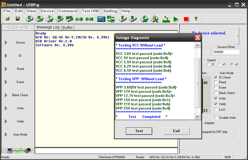

I proceded to ditch the bag of dead chips earlier on today, then I got to thinking as my hand was poised, holding the bag over the bin ready to drop it in, "did I try flashing them on the old PCB3b I bought forever ago.
Dug out the old thinkpad having the parallel port on it and fired the old programmer up, set the jumpers and switch settings and flashed / erased every single chip 3 times, all without error, dug the GQ4x out (both of them, 1 with firmware 1.3, the other 2.20) both error'd flashing the chips.
Before the erase on the old PCB3b, it states that a particular jumper must be set for 12.5v, then removed for the flashing procedure..
What I'm wondering now is do the GQ4x's actually regulate the voltage accurately enough to do the job.!
I also randomly read and dumped some of them to check the dump against the flash, no bad dumps at all..

Re: 12p onto a 27c128??????
Try plugging in the appropriate power adapter to the gq4x. Your PC's usb power might not be enough to power it. A lot of usb ports on pcs can't deliver the current some devices need, eg some phones will not charge on some usb ports etc..
the gq4x has a dc to dc convertor for generating the higher voltages needed by some chips and can do so well over usb 5v power but many pc's and laptops don't give out much more than 300mA or so and the figures vary wildly from 100mA for junk and 5A for good usb controllers.
The power plug on the programmer is for added power when needed. I think it's 12v? it's written on the side and polarity too.

vlad01 wrote:Try plugging in the appropriate power adapter to the gq4x. Your PC's usb power might not be enough to power it.
Yeah that's the first thing I usually try when chips fail to flash, even the old PCB3b needs the boosted voltage on some chips.
The unit I use states it puts out 1 amp..

Last night I got to thinking that I vaguely remember the GQ4x software having a couple of tests you could do, funny how I've used them for years and forget some of the features in front of me every time I use the damn thing.
I ran the test on both of them, the one I bought around 08ish, gave me plenty of grief since it wouldn't program many plcc chips that were supposedly supported, wondered why I wasted the money when the PCB3b was still working fine, I think the time saving feature sold me when I read the speille regarding it's usefulness, then inherited one of the last before they started selling the GQ4x4, from a friend I had buy all the gear from here to start playing with injection, seems it was either too hard or he lost interest, this last one gave me little to no grief, I opened them both up, internally they look identical parts wise, only difference I can see is the firmware running on them..
The early one always throws an error when using the "safely remove hardware" on XP then disconnect it, the other never does.
Running both of them on the same laptop, results below, guess that answers my question about voltage regulation on one of them..
