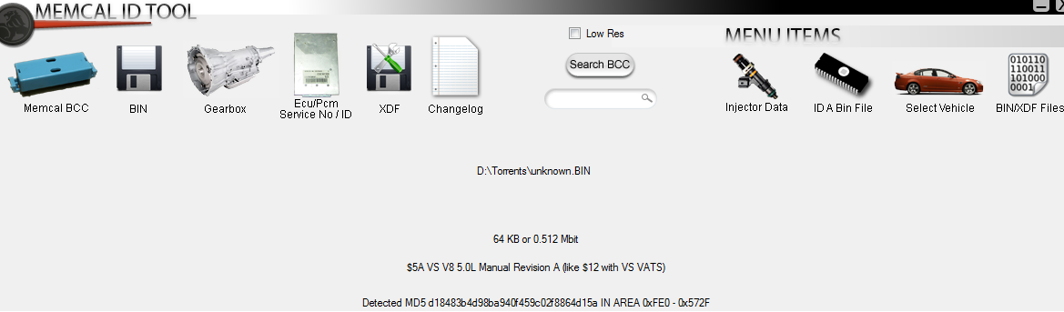

Anyone got an xdf to read a crow chip?
- Posts: 2959
Re: Custom Tuned Bins
It has ID of standard file (see attached) so there should be plenty of xdf's on here for it.
- VS V8 id file.png (85.98 KiB) Viewed 35378 times
