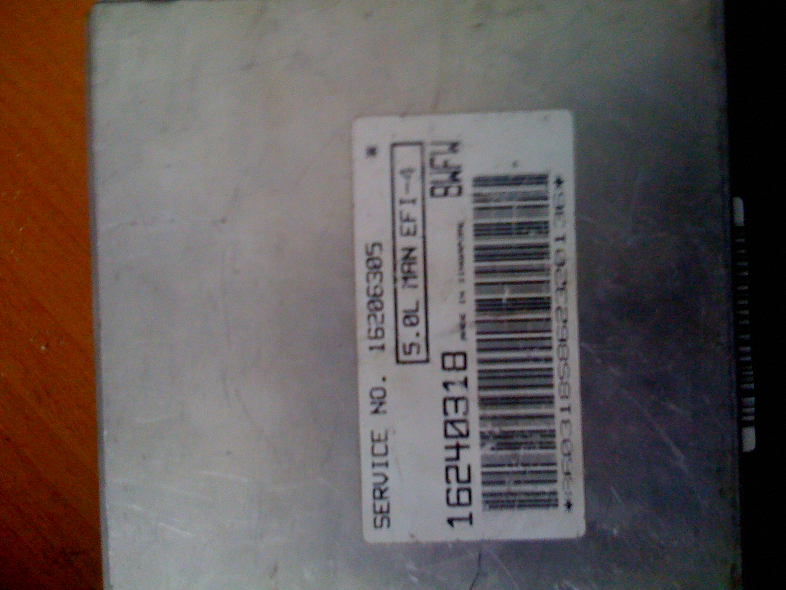

Hi jayme, thanks for your help.
woud this combo work ?
ECU: 16176424 - This is what I have.
BIN: BFPM.BIN - Downloaded from this site.
XDF: I can ony find (16183082 $12 version xx.zip). Would i need a 16176424 $12 XDF ?
The reason i need an xdf is sothat i can *try* and tune it once it s started.
Once again, thanks for all your help.
just to be clear the car has a T5, i am after a manual BIN
Re: vs v8 VAT remove
16176424 is an auto pcm isn't it ?
yeah you are stuck with using Auto bins as that is an auto PCM, it just wont run a manual bin, the ecu is physically different with different pinouts. if you want to use that PCM, you have to get an auto bin, auto xdf, and turn off all of the AUTO related error codes.... I already have a VS v8 auto bin here somewhere with all of that already done if you want it.
yes it is....
i'll rewire the harness for the manaul ECU. this is the bin from it i think...
how can i tell if that is te correct bin for it.
