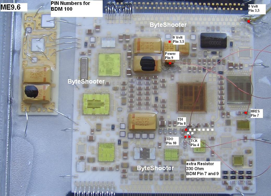

Found this on trionictuning.com
me9.6 bdm
ME9.6 BDM-Connection.JPG (123.58 KiB) Viewed 3976 times

Open source software that could work with some modification on bosch me9.6
https://github.com/mattiasclaesson/Trionic
