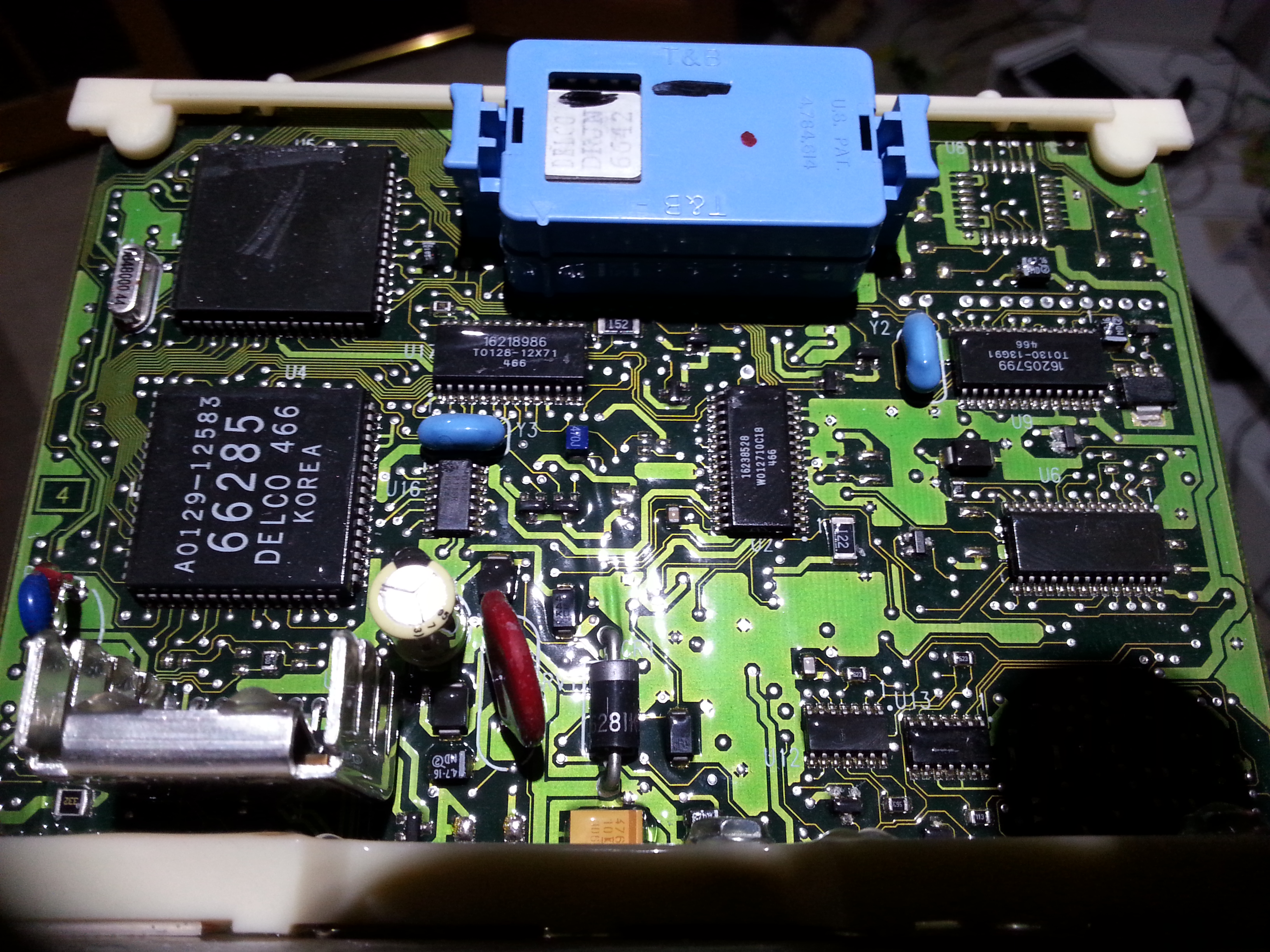

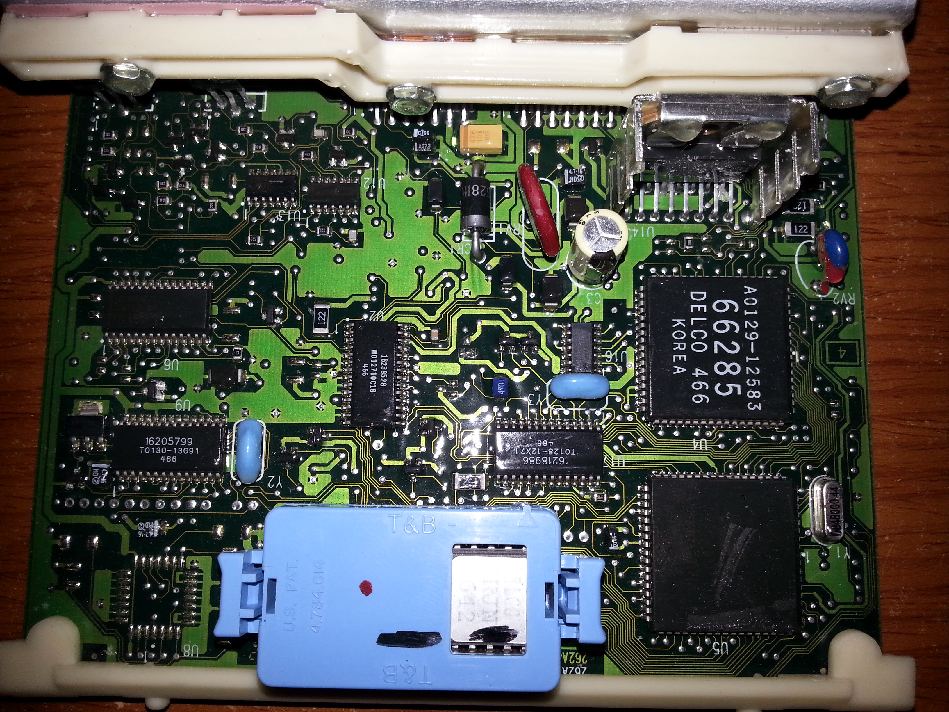

Okay I am now googling taking the EEPROM from my old PCM and putting it on the replacement PCM. I just need to know what it looks like.
Posts: 8250
Re: Help, how do I swap my 2002 Rodeo PCM with a replacement
If you can post up a high res pic of the circuit board we can probably provide an educated guess
PeterA
Posts: 25
Joined: Thu Jan 04, 2018 12:21 pm
cars: Holden Rodeo 2002 petrol 2.2L C22NE engine
Post by PeterA »
Ok here are some pics.

I think I might have RFID in the key. And need to program the old keys to the different "new" PCM....
Posts: 8250
Yeah i think there is key security. Looking at the pics chip U16 with the id scratched off may be a prom, but i have a feeling the data will be in the cpu instead. I also think it might work like other delco computers and actually need pairing with the vehicle bcm. Which amounts to the same thing. You might need to find someone with a tech2 or mdi to do the key learn or bcm link thing.
PeterA
Posts: 25
Post by PeterA »
U16 was the one was the one I was thinking could be the one.
Assuming that the U16 is the chip, if I was to solder my old one onto the new board would that allow the key to work?
"tech2 or mdi" What is an mdi?
It would be handy to have a scanner that works with this car. i have tried 2 types of obd2 scanners now and they do not work.
