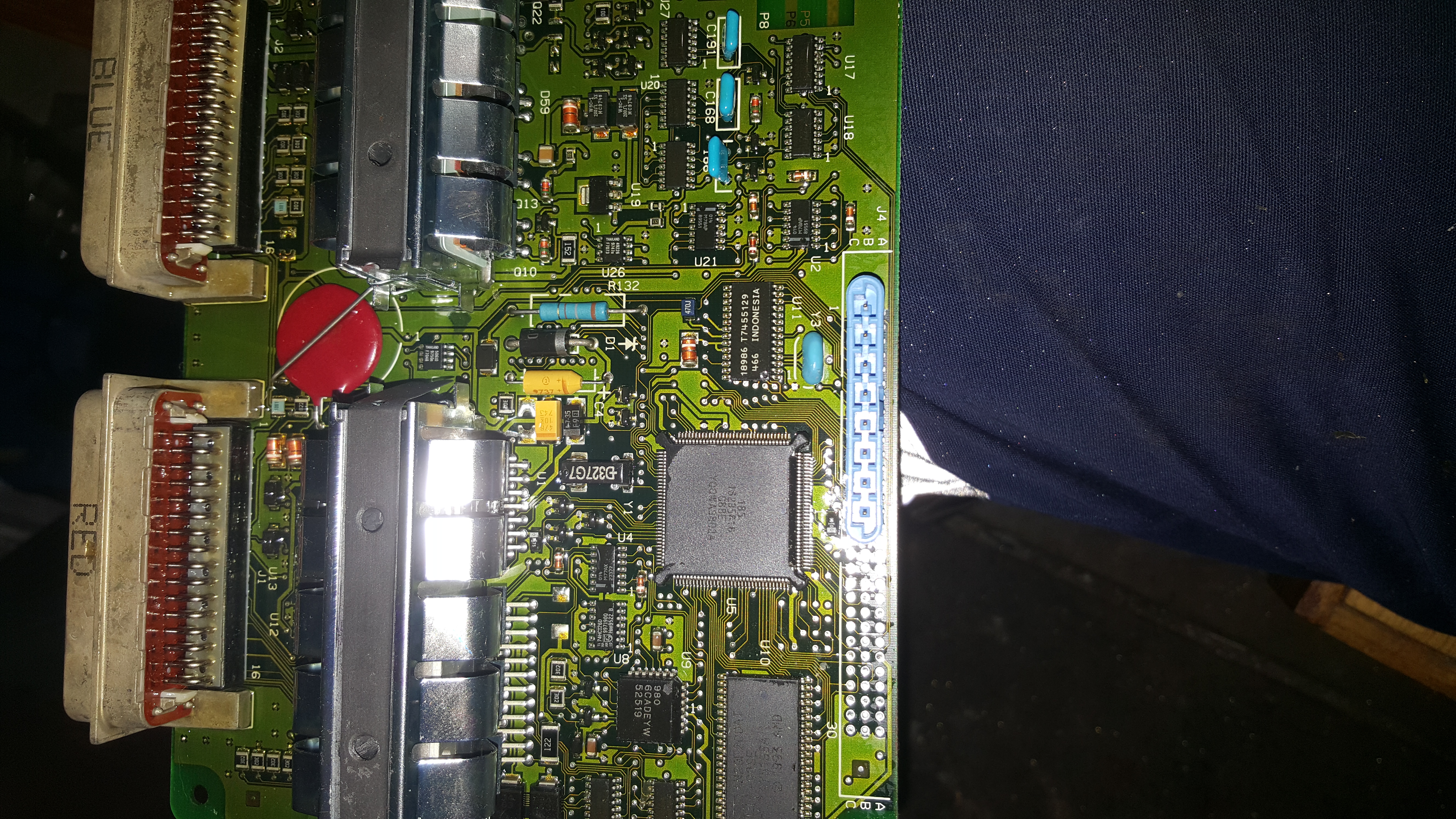

JACKAROO / isuzu trooper 4JX1 3ltr tdi
Im planning on playing around with it but im not too sure where to start.
Any help is greatly appreciated.
- Posts: 9032
Re: JACKAROO / isuzu trooper 4JX1 3ltr tdi
The biggest highest density chip would be a Motorola HC11 processor. The 3 row header in the white box with ABC looks like a standard Delco/Delphi header that would contain address and data bus lines. The blue connector, I dont know. I'd pick the pinouts for a HC11 processor, such as the F1 footprint and see if that main chip lines up. If it does look for the BDM pins and get a USB-BDM-NT interface and try and read it. But these are not a well known PCM and you might run in to walls and get no answers quickly. The above is about the extent of my knowledge on this one.

Actually i just realised this is the tdi which is later then i was thinking so less likely to be a hc11. I found some details here discussing that you can do some fuel trims with a tech 2. The bdm comment still stands as it has that 3 row header but it clicked that thd hc11 is too early for bdm. http://forum.australia4wd.com/index.php ... rs-to-ecu/
Do you want to communicate for logging or to read the flash?
Looks to be a 2mbit flash chip next to the processor, you could desolder if you have the equipment or perhaps try a test clip

well for now i have given up on the tuning part i have partial maps from desoldering the ic howeverejukated wrote:Do you want to communicate for logging or to read the flash?
now my projects have taken me in a slightluy different directing and i am trying to figure out why it seems the only units that will actually communicate with these cars is a tech2
i have a few different readers and none will get coms with them and i have even tried some console commands on an elm terminal without alot of luck
so... if anyone can help out? or thinks they might have handy tips it would be much appreciated.

Hi Aussielegend,
The Injectors can be programmed via a Tech2 for minor fuel changes that affect individual cylinder power. So if you have an ageing Injector that has gone out of factory spec (maybe a blocked nozzle with only 5 of 6 jets spraying), then you can potentially trick the ECU into thinking that the Injector is a lower delivery class than its Trim Code as printed on top of the Solenoid. eg. say your Injector Trim Code is 48, which correlates to a B2 Injector, but its in cylinder #4 which appears to have a lower power output when using the Tech2 Injector Balance Test. So you want that particular injector to give more power than its currently allowing, so you can set it to be a B1 Injector and work your way down slowly to the lowest factory delivery Injector of A1. If going all the way down to A1 and doing the Balance test each time, and it still has a lower output (rpm drop is less than other cylinders when that injector is turned off), then you need to replace or repair the Injector.
So it can be a blocked nozzle (less than 6 jets working), or it could be something more sinister like a broken amplifier spring, or a damaged plunger in the barrel. The worst case scenario is a broken poppet spring which really means a replacement injector.
BTW - Any chance you have the numbers as printed on top of the chips of the ECU Motherboard, as I'm working on a potential Immobilizer workaround and it would save me pulling the cover of one of my spare ECU's?
