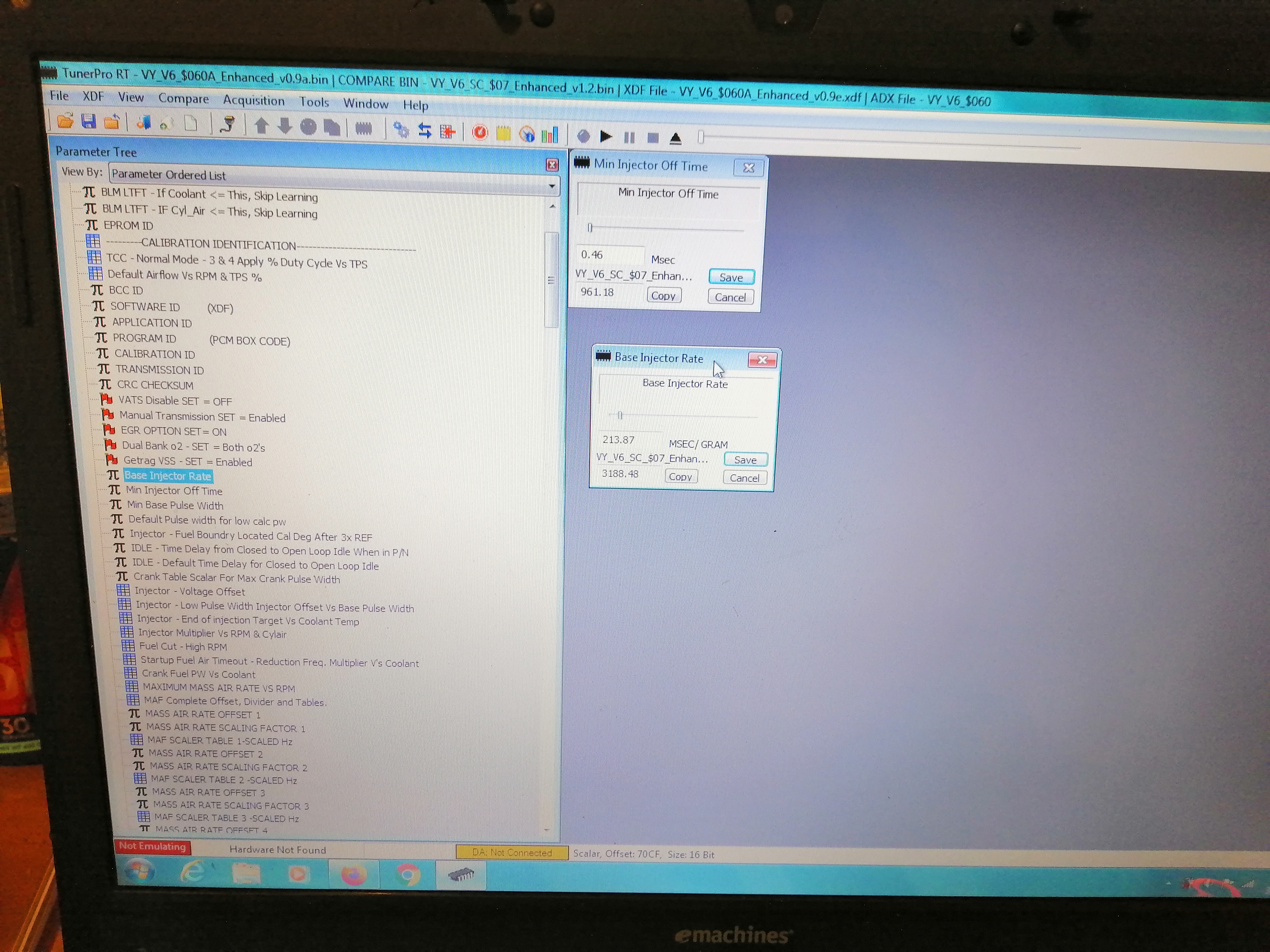

Not sure what's going on but every time i try to compare files some whacky looking numbers come up, Am i doing something wrong ?? lol
Posts: 8253
Re: PCM questions regarding L67 Swap into VY
Im not in front of a pc, but your comparing a $060a and an $07 so the same xdf wont work for both at the same time. Look under tools and you can launch a second copy of tunerpro then you can have a bin with its matching xdf in both copies.
