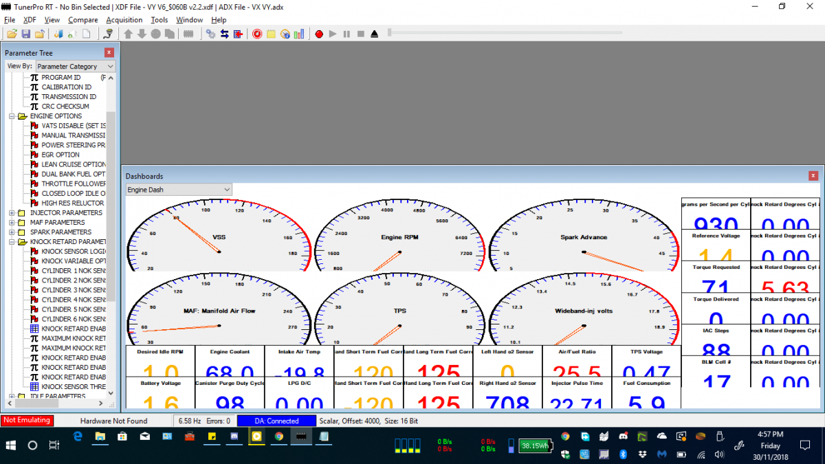

Now what is happening, is that the cable is talking to the car, in fact at one stage the CEL set, and the traction turned off, so the cable is doing *something*. But the data being pulled from the cable is complete garbage, as if there is an incorrect profile loaded into the software or something. I really have very little idea what I am doing but it seems like this is what's happening. It's just spitting out pure garbage, gauges are all over the shop and giving meaningless readings, just, nothing is right.
I have followed the attached guide to the letter (apparently), to no avail.
As far as versions of software I am using, as of yesterday, it appears I am running the latest version of everything, that is TunerPro and the USB-RS232 transceiver driver, which is a CH340C. A chip I've never heard of, but apparently Arduino Nanos use it, so whatever.

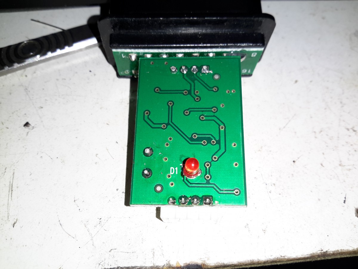

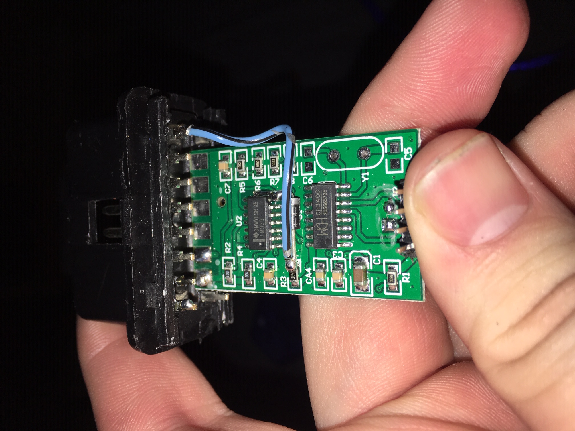

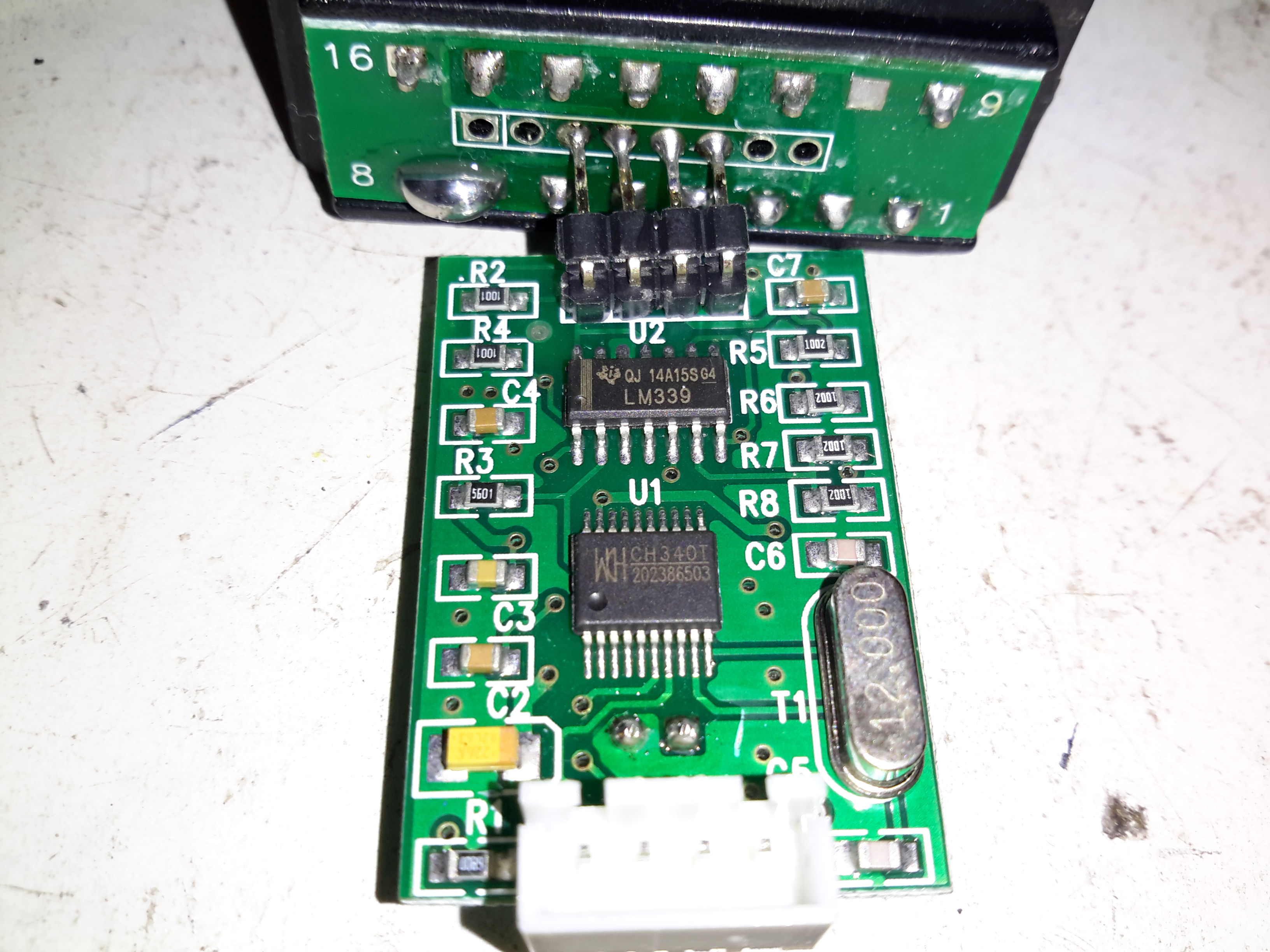

Attached are the files I am using to try and make this all work, including the instructions that came with my ALDL cable, and a disassembly of the ALDL cable itself, just for reference more than anything, in case anyone else ever finds this thread useful.

Just a casual wire and diode hack job on a board not designed for this in the first place.. yep... seen that a couple times now
None the less, Should be able to have it working, its likely the ADX file you are using is either incorrect or is not syncing up with the car correctly. On my old VY V6, depending on the ADX file used, I would need to click connect/disconnect a few times for it to sync up and show valid data. Some ADX files will connect better than others as they search for 'quiet' points so it knows it gets synced with the car.

Thanks, I tried another profile, I think for a VX, and I'll have to look as to where I got it from, although a weird thing it does is that when the cable connects and the ECU starts giving out Bin Laden's home address, it commands both low and high speed cooling fans on. Which isn't a problem, it's not reporting erroneous engine coolant temp readings, as far as I know it's not reporting weird air con pressures, it's not doing anything that would suggest the software is interfering with any sensors in some way, it's just that the low and high speeds come on and stay on.

It doesnt command fans on, it commands aldl bus communications in the car to cease to make time for the logged data to be transmitted to the PC. When the BCM looses communications with the PCM, the fans come on as a safety measure as the BCM no longer knows the engine temp. That is a pretty shit cable, it may work but having lots of trouble is also likely. Our boards are a much better circuit that is designed for the job, with quality ftdi usb chipset so drivers load automatically.

Damn. I really wish I knew that cable was garbage before I wasted $70 on it. Although I'd be curious as to why as there are literally two active components on it. The TI chip is just a basic comparator, can't see how you'd screw that up, and the USB-Serial chip, while not FTDI, is still a known quantity because they use these things extensively in Arduinos.

P.S. The profile I'm using is apparently yoda69's VX-VY V6 Auto. Seems like it works pretty well, apart from the whole 'cable being crap' thing. So much for 'Made in Australia' as the listing suggests. Maybe the burned CD that the drivers came on, that wasn't even finalized (although that'd be handy to throw a profile that works on for the next poor soul I'll unload this heap of shit on to) was burned in Australia.

Theres a couple editions of the yoda69 adx about, I believe one of my demo videos I did in my own VY V6 was using that file, took a few connect/disconnect to sync up with the car nicely, it always got there though. Can even hear the high speed fans turn on in my demo too so its definitely normal behaviourrawrs wrote:Damn. I really wish I knew that cable was garbage before I wasted $70 on it. Although I'd be curious as to why as there are literally two active components on it. The TI chip is just a basic comparator, can't see how you'd screw that up, and the USB-Serial chip, while not FTDI, is still a known quantity because they use these things extensively in Arduinos.

I believe that whole package is something like a $5 KKL cable or something (i dont know which cable or the original protocol), with ALDL hacked in to it with the diode out to pin 9. I dont think that comparitor has anything to do with ALDL though it may go through it and hes just using the case and the usb chip part as a means to an end. You could probably identify it if you look which protocol pin is connected to the pcb. It might even still work for that protocol, too.
- Posts: 10111
Re: Brand new to it all, ALDL cable spitting out garbage.

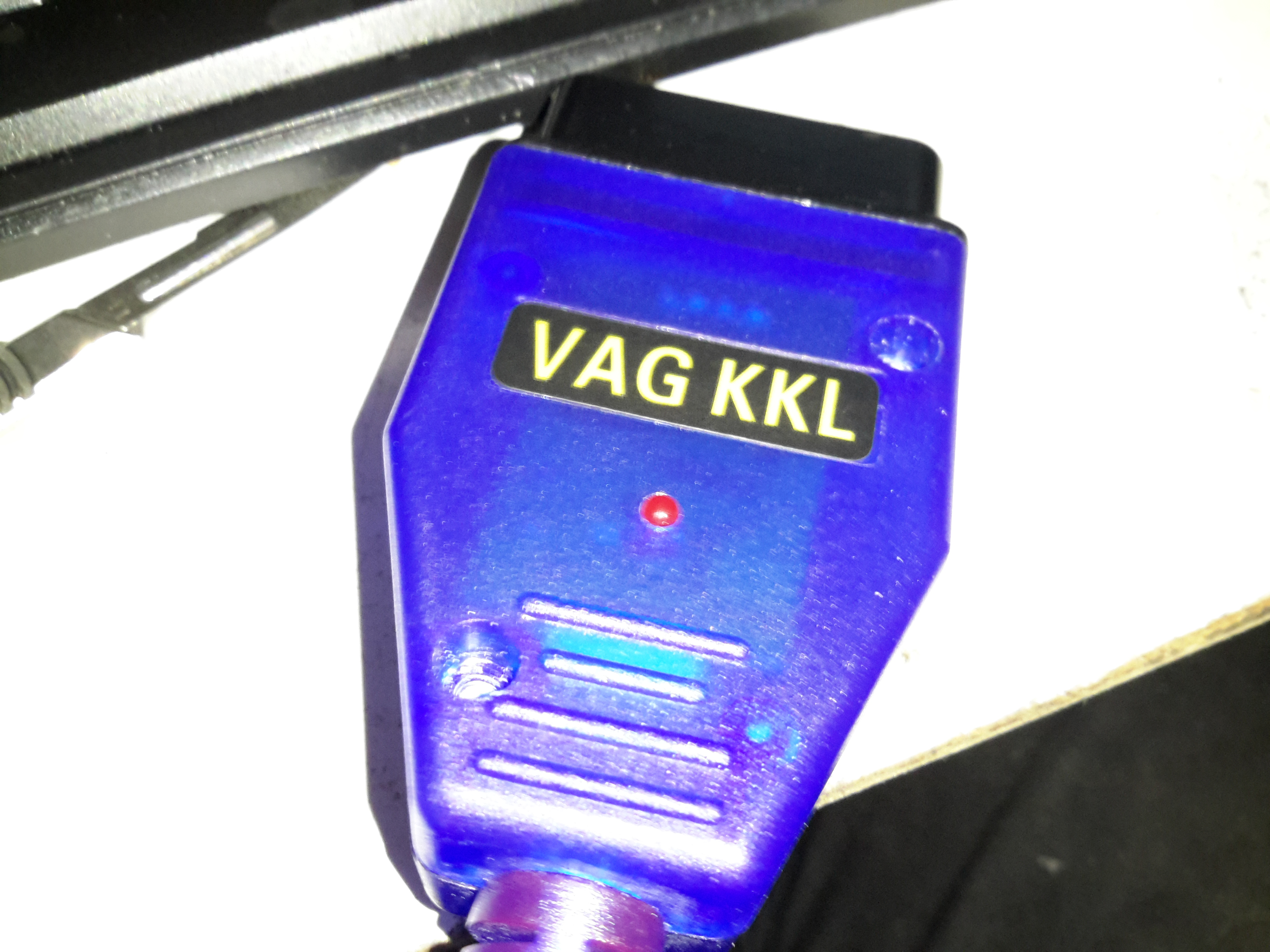

Here it is, its this one with a slightly different connector on the end, and built even cheaper with 2 missing filter capacitors and without the crystal for timing.
"This is a little bit of kit I got to talk to the Webasto TT-V I salvaged from a scrap Jaguar S-Type, and converts USB-RS232 to the standard car diagnostic ODB connector. (These are a much cheaper option at £4 than the official Webasto diagnostic adaptor & loom which is over £90."
https://www.experimental-engineering.co ... interface/
Probably this one but Ive never bought this to open it nor would I. The cheap KKL adaptors could also be like the sub $8 elm clone scene where they're all random and its impossible to get the same thing twice and many of them dont work.
https://www.ebay.com/itm/VAGCOM-USB-KKL ... 2992561260
