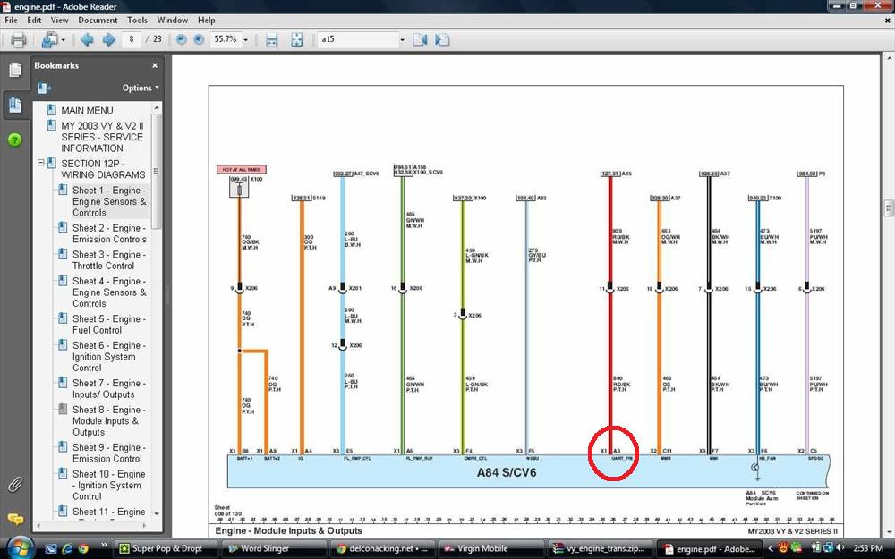

The specific link between the bcm and pcm is at A3 on the pcm.

Thanks kojab.kojab wrote:The specific link between the bcm and pcm is at A3 on the pcm.
engine module inputs/outputs. so a3 on a switch will allow the bcm to be powered up, but not communicate on the the bus? this is vy scv6 diagram. sorry so many questions, its a new learning process for me

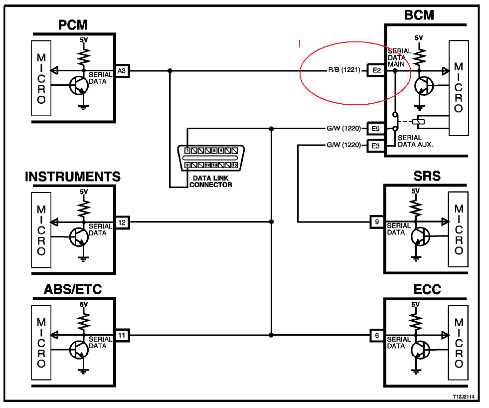

- Posts: 10014
Re: bcm be-gone
Is that the vehicle data bus in to the pcm, or is it only used for pcm<-->bcm. If its the vehicle data bus in to the pcm, then you'll need to install the switch on the BCM end. Sorry I cant be more help, my vehicle has just a plain old 808.

Re: bcm be-gone
Antus thats what im wondering. Need to be sure a3 is just used by the bc to talk to pc through the bus and not used by the pcm to link for other bus comms to avoid disabling the bus altogether. So like you said, may need to switch the bcm end.

Re: bcm be-gone
for any one interested in the details of doing this, here is what you need to do, cut the red highlited wire. it is a red/black wire on the bcm(not pcm), it has a yellow and green white wires next to it. wire a rocker switch or whatever you have inline. you can now real time tune using flashtool and nvram board. sweet.
you will have check engine and oil/p light on. to enable logging when using the ose plugin with the bcm switched off, you need to edit the adx connection macro and delete the listen for silence/heartbeat/chatter commands. VY BCM-be-Gone mod cheers all for the help

Re: bcm be-gone
sorry for bringing this post back to life, I have tried this wire switch mod on a vt series 2 v6 and I get no start, dead key. I have ensured several times I have the correct wire and plug and have tried with VATS disabled and still no go. in the end I have just unplugged the bcm at plug #2 top rh as you look at it under the steering column and all good for emulation etc. is this right? thanks
