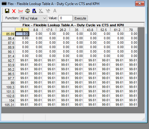

Question for the experts on here:
Have I got this table correct for fan on 92 degrees (roughly) from 0-70KPH then 70KPH fan will turn off?
Max Flex Temp vs KPH.png (16.63 KiB) Viewed 6732 times
Re: MadMax 355ci VN Calais
That table will turn the fan on based only on temperature, would need to 0 out the 70kph column if you want it off above ~70kph (actually would be above 65kph it turns off) regardless of temperature. Whatever value is in the first/last columns/rows of the table get used outside the table min/max axis values.

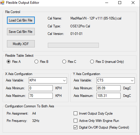

Also make sure you have the relay option set in the flashtool config, or you will PWM the relay which it wont appreciate.

I have the relay option ticked and have then made the changes I think you have suggested in comments.
Put images here to help others.

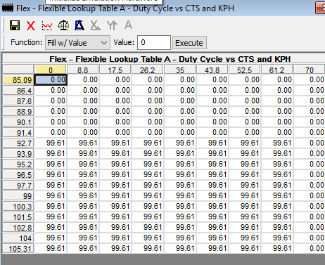

Table Flex Temp vs KPH 65.png (18.62 KiB) Viewed 6701 times
Setup Flex table in OSE Enhanced Flash Tool V151
Max Flex Temp vs KPH 65.png (17.87 KiB) Viewed 6701 times
Correct table for fan on 92 degrees (roughly) from 0-65KPH then 65KPH (roughly) fan will turn off
Please let me know if this is correct and I will change if needed?
That should do what you want now.
