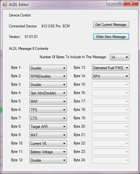

Re: My First Tune 12P
Well that says it all. I will be reading (again) your tuning guides on these messsge 6 as ive never done them.
What does the double mean? Byte1for example.
it means its a 16 bit item, so in the adx settings you need to set it as 16 bit instead of 8 bit.....
have a look at the items in the full message and you can set them up the same, only thing you need to change is the offset that they use for M6 and also the size of the packet etc in the connection settings. but if you use the M6 that VL400 provided and just adjust it from there you should be ok.
Looks like I better get reading theres a bit to it by the sounds of it.
