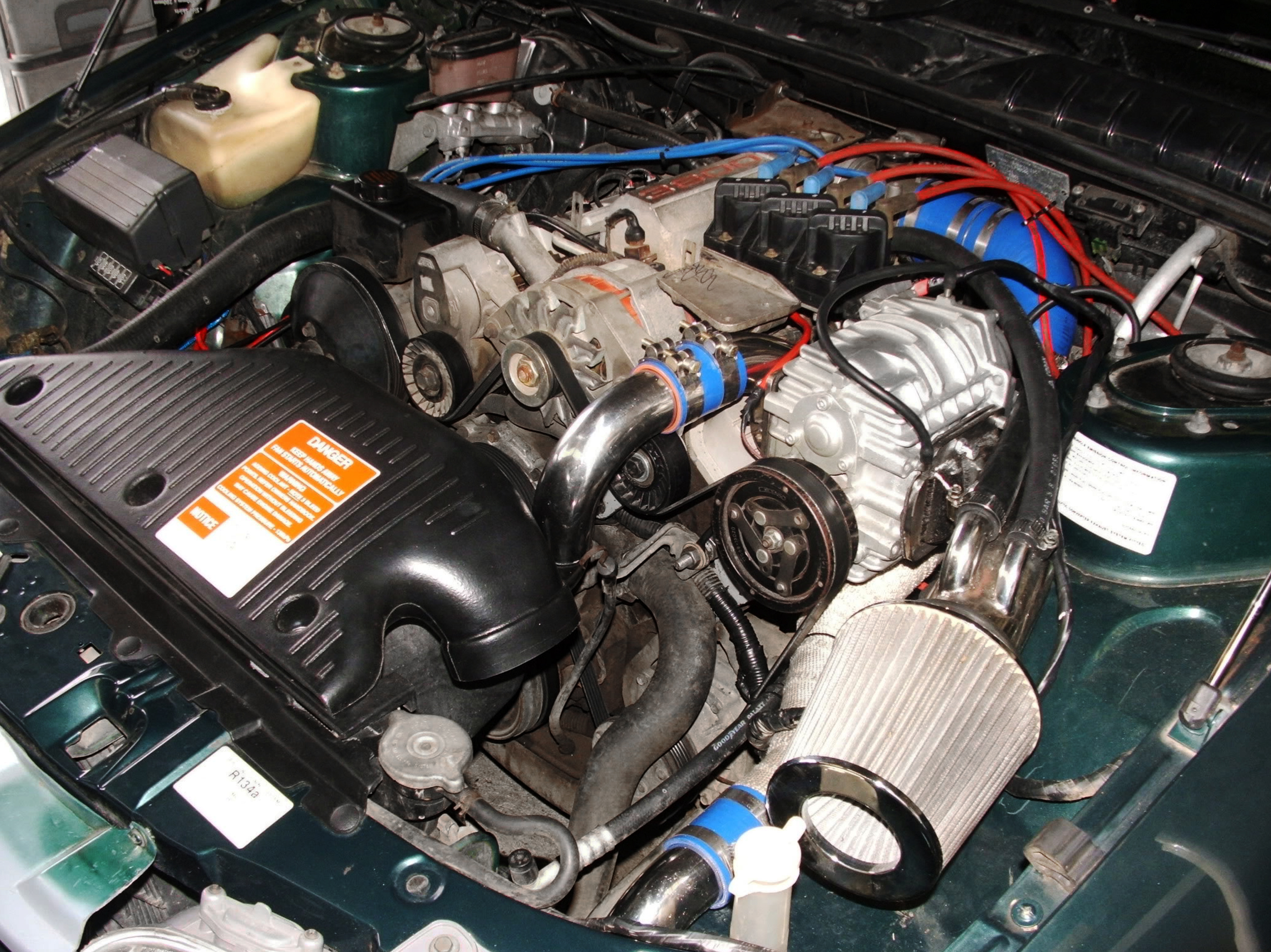

Yep, it was a great kit,
Originally a basic non-intercooled 4psi CRS kit.
Later I installed plumbing and a front mount IC, got a green foam tune to suit 2-Bar, 70mm TB, and 42lb injectors.
(As per picture)
Then I milled a 10psi pully, without the clutch. Which worked awesome, and infact my calcs were a little off and it ended up being 12-psi at WOT (potentially because of the bigger IC)
I sold the kit when I moved to NSW because of their mod restrictions.
I can't believe the stock internals held up to 12psi, although I doubt the VE of the motor allowed for 12psi to ever fill the cyls, I had tuned genie headers, but factory cam, so there was probably 2-4psi artificial psi in the plenum.
Now I'm back in Vic hence the FI mods on my VT.

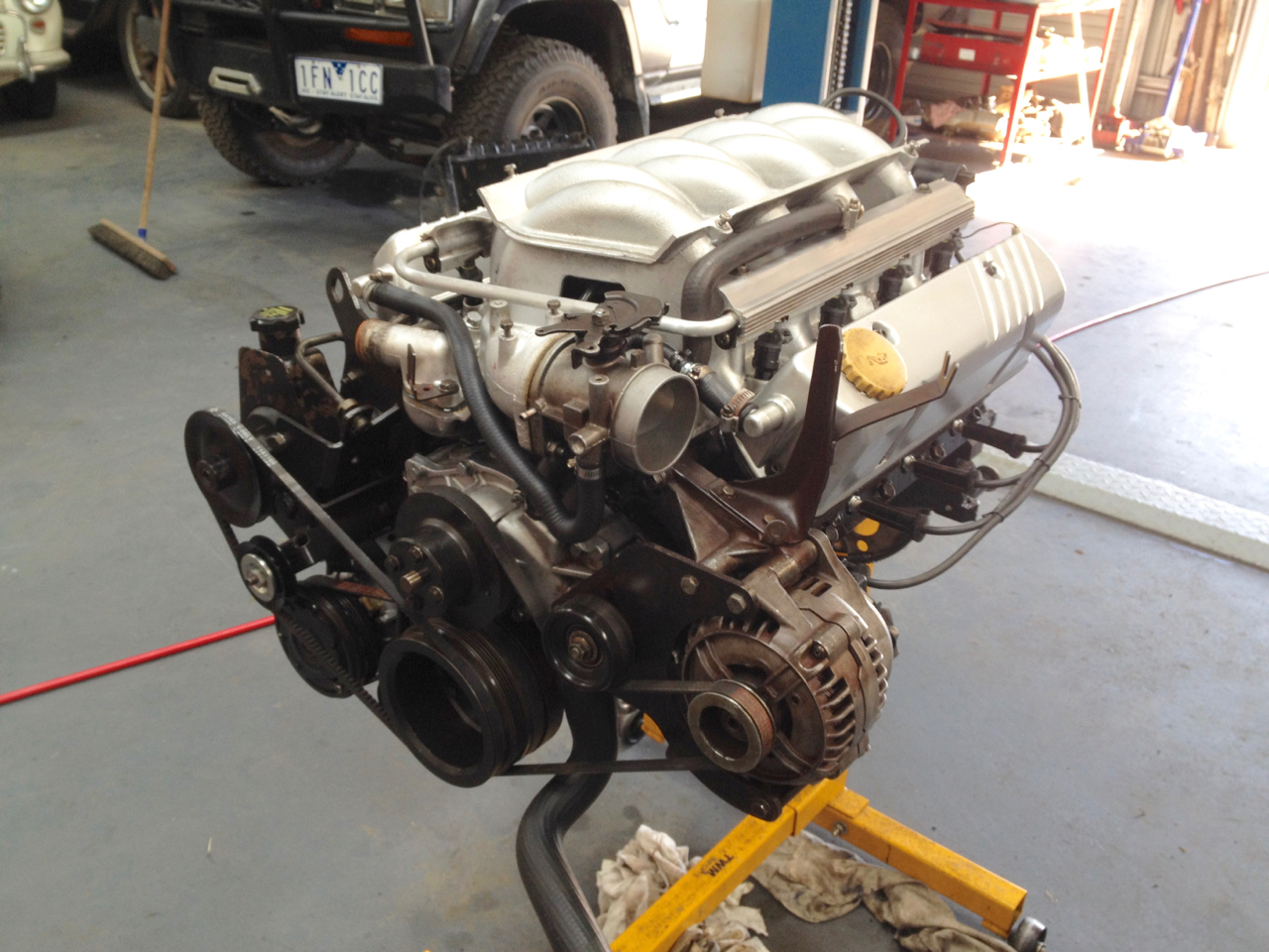

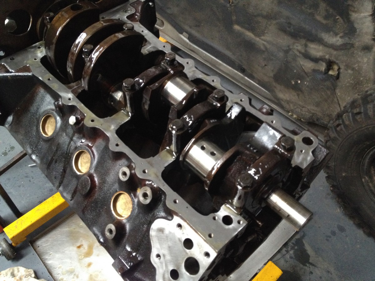

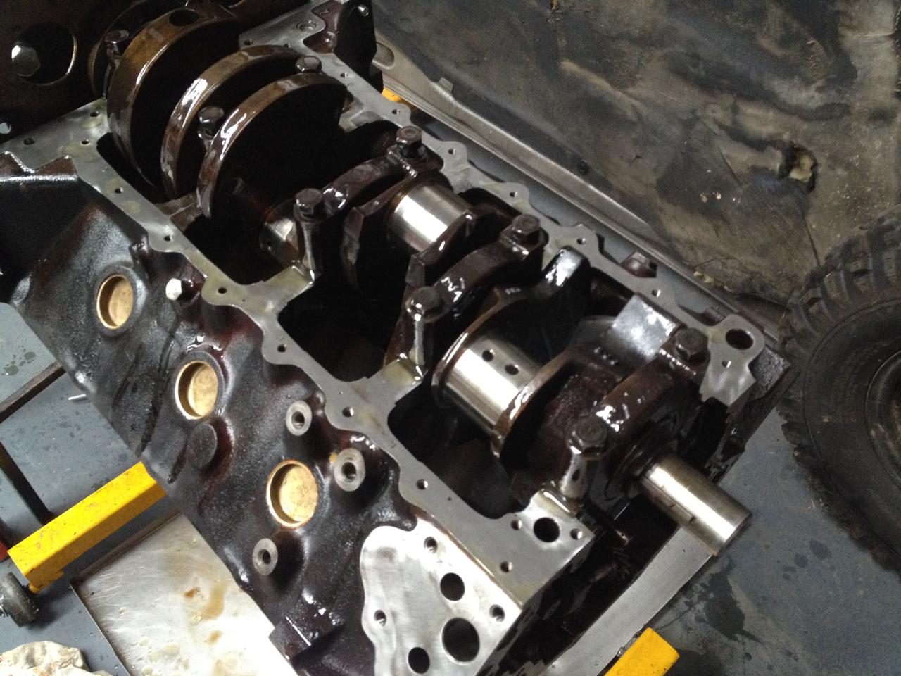

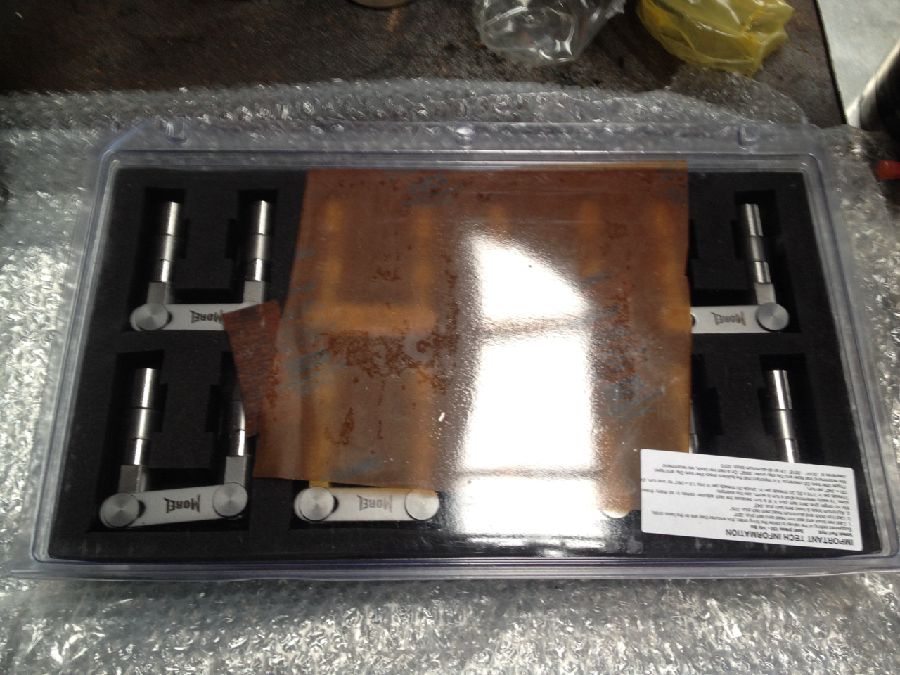

Here's the photos of me rebuilding the motor after the stock spider retainer failed and the Lifters started munching the cam lobes:
Bottom End:
Bits:
Bottom End:
Bits:

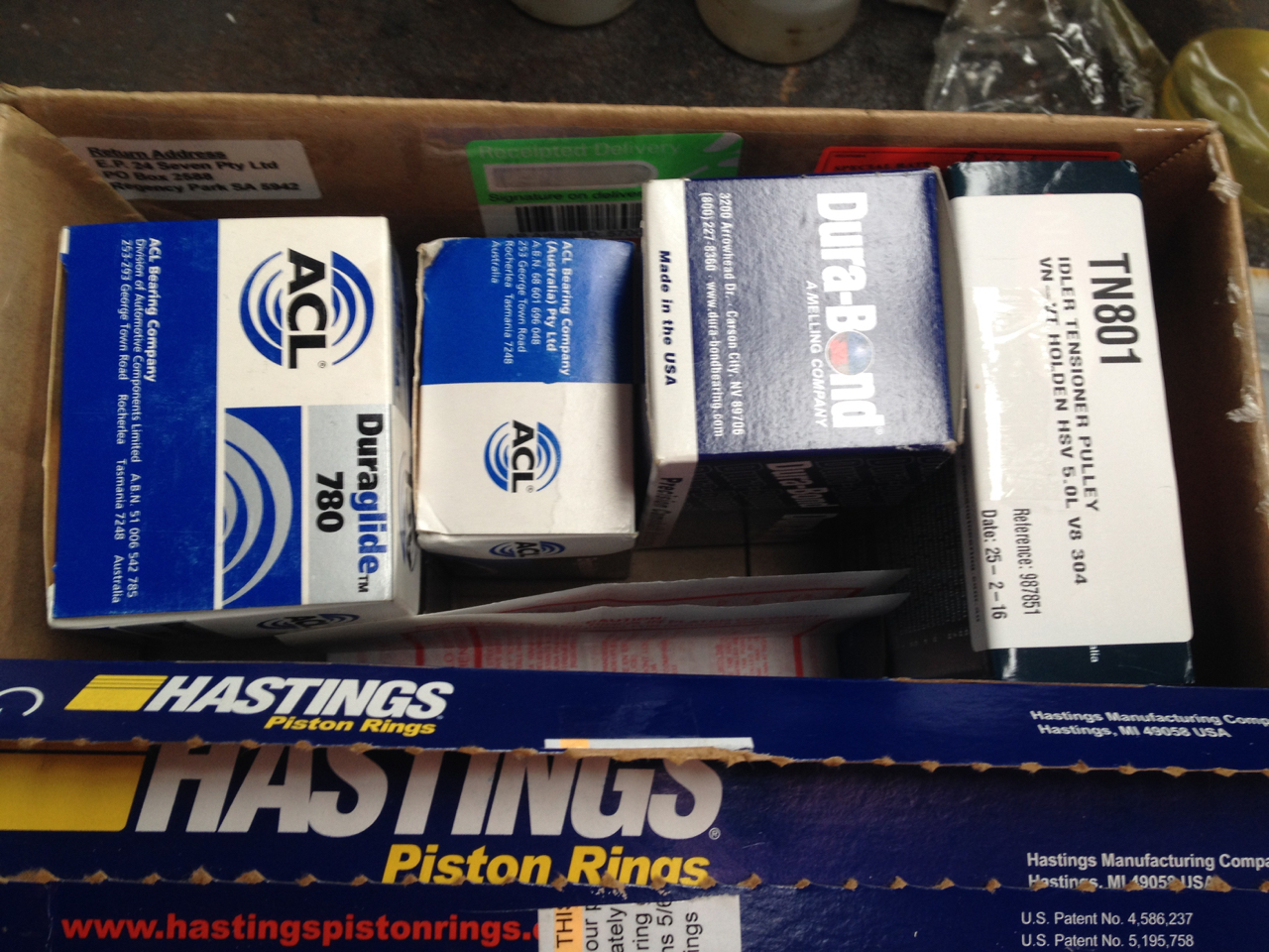

Block Populated with Freshly ported and ground heads and Freshly ground valves, New Morel Tie Lifters so I never have the spider lifter issue again, new rods and a 3314 Crow Cam:
All bolt ons:
Now to wait for the remaining parts to come so I can setup both ECU/PCMs on the stock motor, before I go into all the FI mods
All bolt ons:
