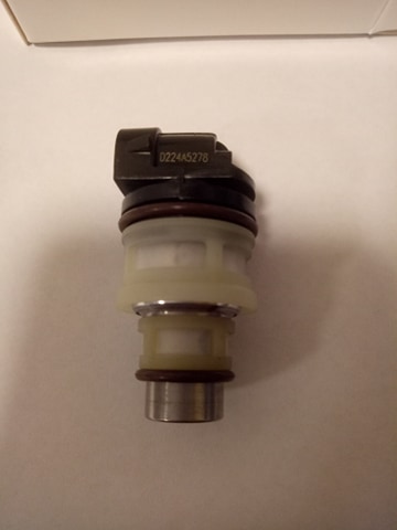

TBI AE seems to be fine, had to almost halve the default numbers but no issues there. If you're going TBI, I just ordered a GM 2.0L-2.5L injector from Aliexpress for $15 shipped. Depending on the mod you're doing, the 1.3/1.6 injector (same injector between Mazda121 and n13) may be a little small and research shows its a drop in replacement. Happy to post links if you're interested and I'll report back when its here and fitted.

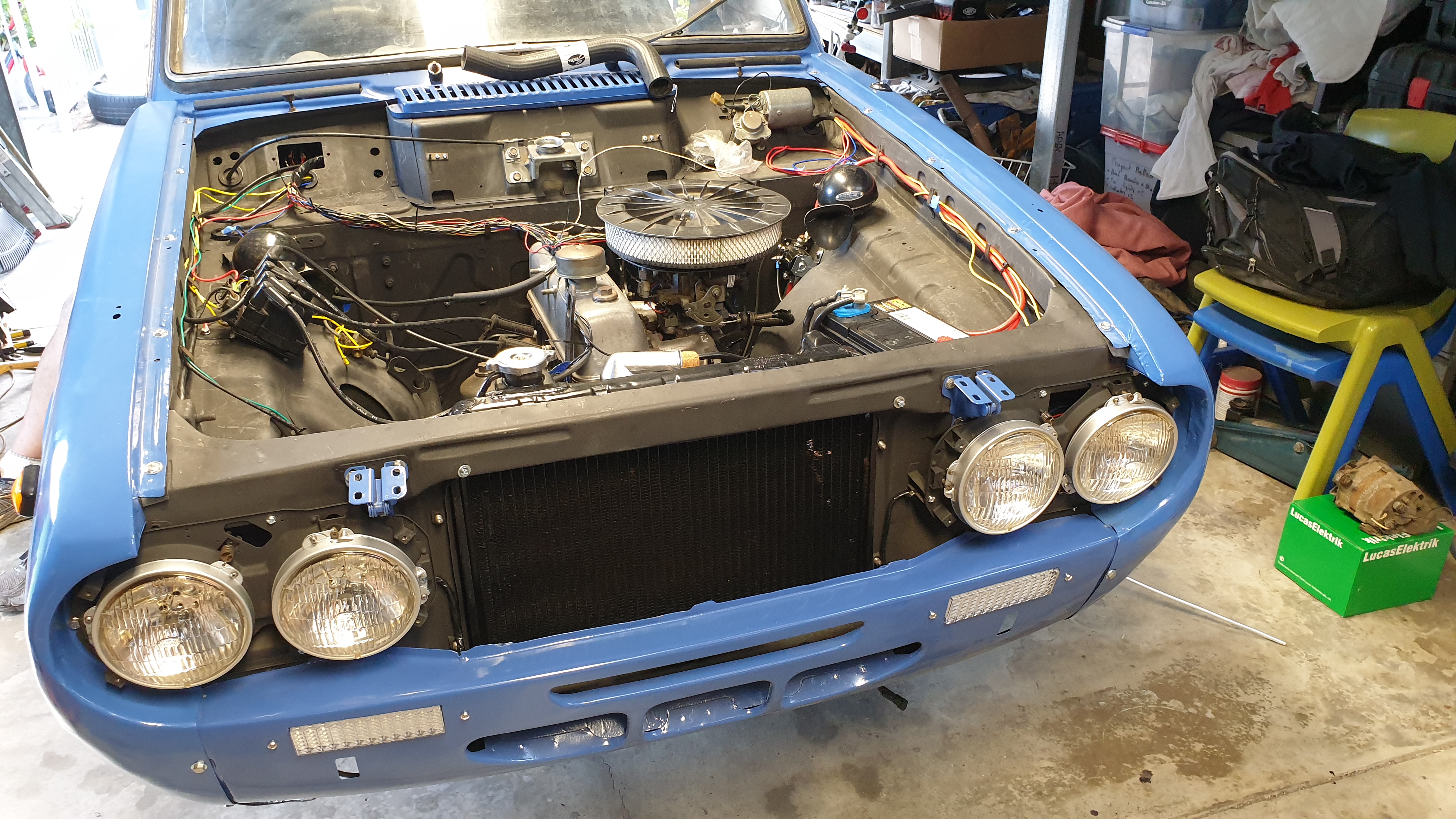

Thats good to hear about the AE. TBI Yes, we 3d printed an adapter to fit the pulsar TBI to the Isuzu intake. I saw the car keyed on the other day (not started yet) and all the sensors were working and we compared MAT and CLT at ambient to confirm they were both working. I think he did use a Pulsar TBI loom, but I also know he re-built it, so he must have added MAT as part of the build process. This is only a 1.5 engine, but he has mentioned turbo, so it'll be interesting to hear which injector you got and how you go with it. Thanks!

Nice car! I drove a mates from Sydney to Ipswich who topped off the clutch fluid with engine oil. Had no cluctch from around Hornsby to the destination. Wasn't too fun in peakhour traffic.
If you search for the part number "5235277" you'll find the injector on aliexpress if you want to take a gamble on it. The car(s) it fits use the same TBI as the pulsar so it *should* fit...

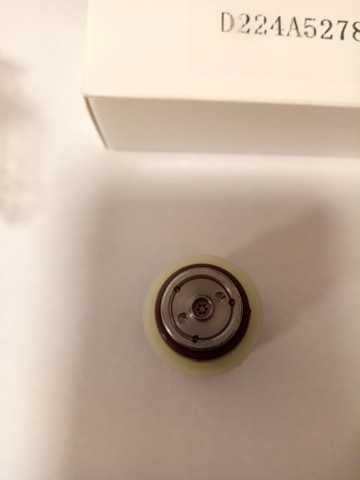

The new injector arrived. Pics:
I've got volumetric flasks and precision scales arriving in a few days, I'll get flow and deadtime numbers for each and post
