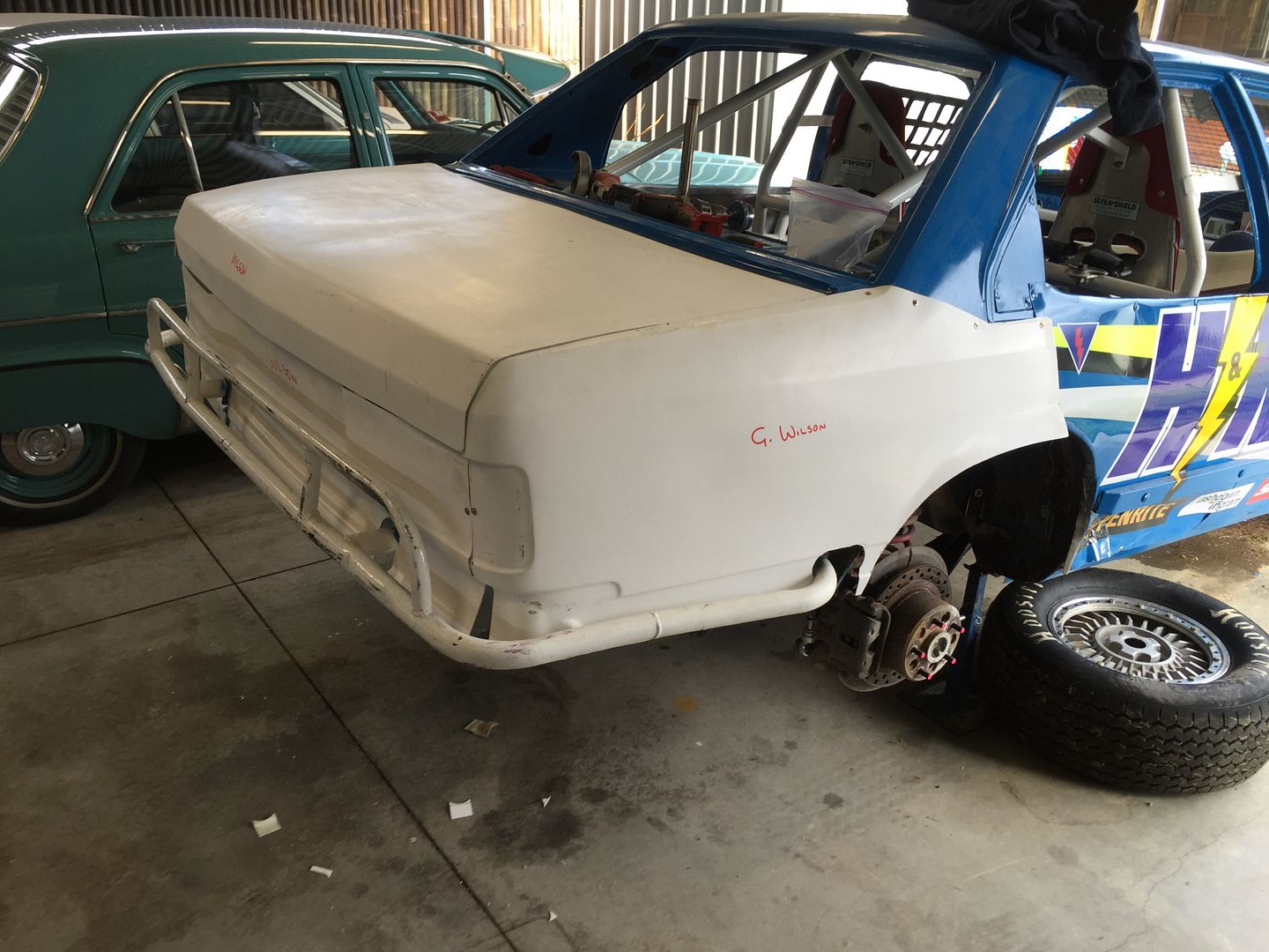

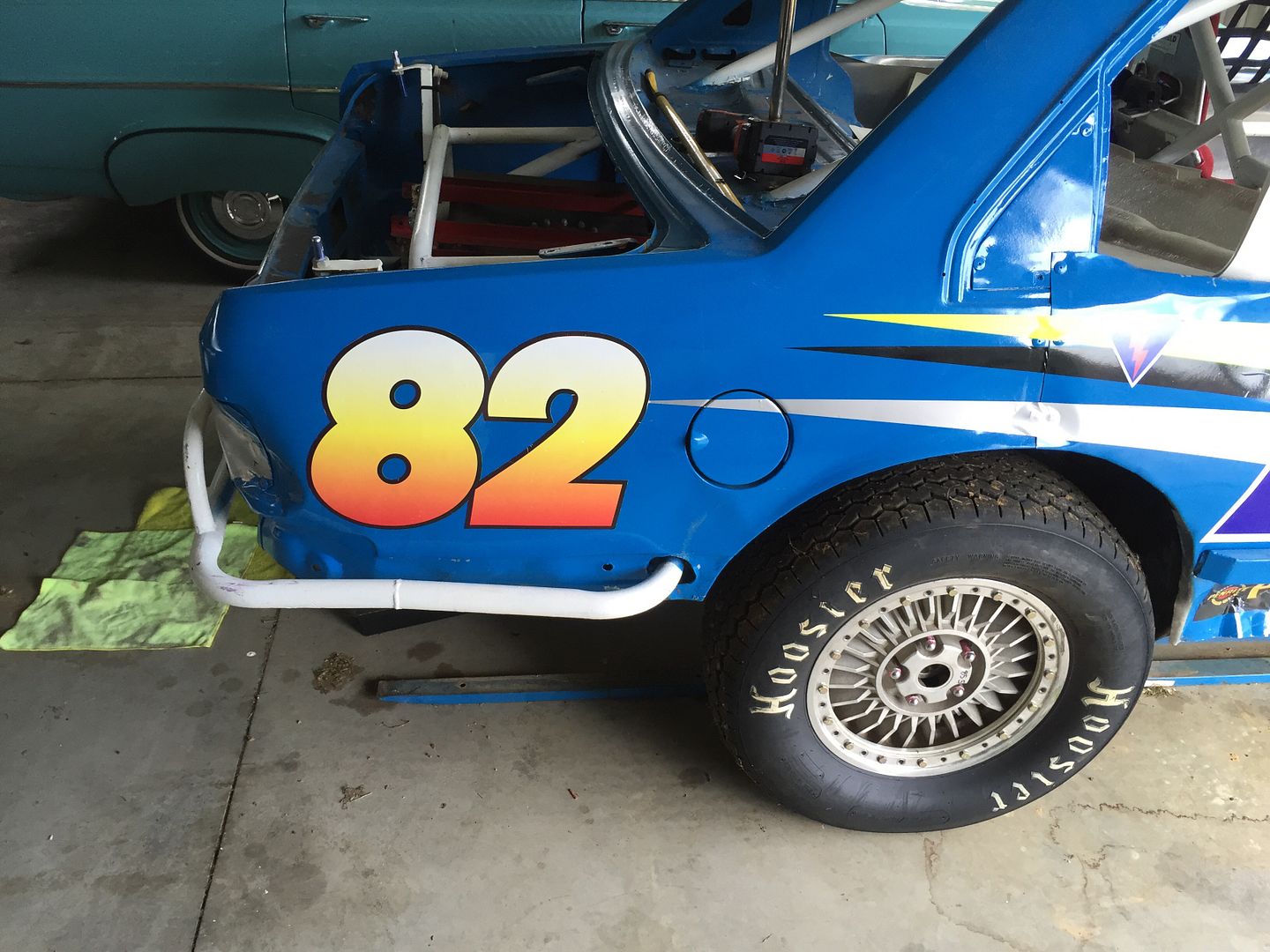

So got happy with the grinder yesterday, here's what happened...
I felt sick at this point, i was thinking 'WTF have I done....' But then i screwed this on...

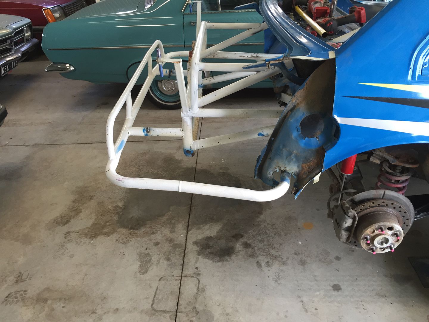

And after all that was done got stuck into cutting out unnessesary stuff, like the old battery mount and old fuel tank mounts and protection bars.
Had a bit of a rethink about componant placement, we used to run the fuel tank up high to make better use of rear weight, but all that was done when the car was first built and when it was a street stocker... Now we have the ability to adjust the suspension and chassis so the new fuel tank will be getting mounted as low as possible and as close to the diff as possible to aid in a lower centre of gravity.. The new fuel system is 10kgs lighter than the old complicated setup
and requires a lot less bar work.
