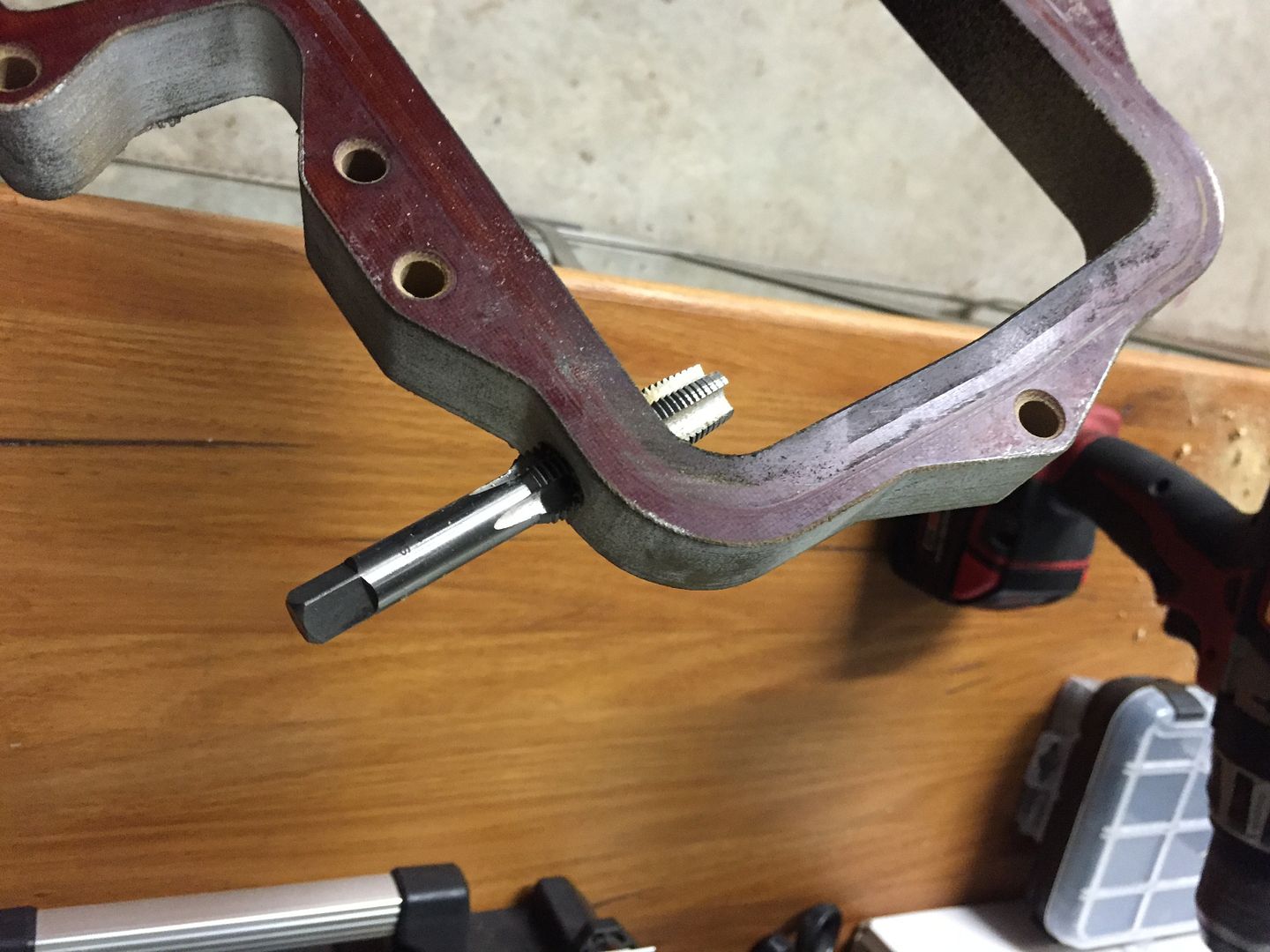

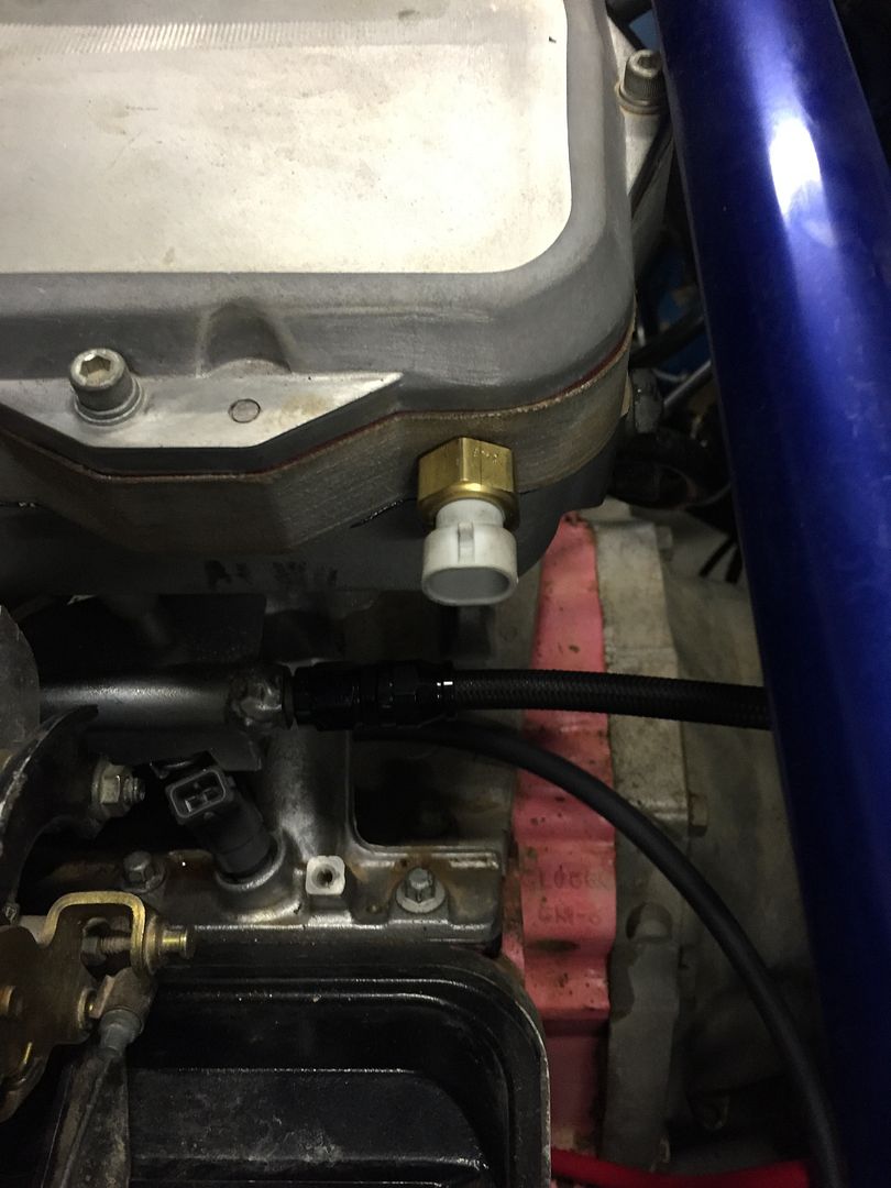

So after a lot of hunting, i finally tracked down a tap for the IAT, for anyone interested its M14 x 1.5 which is made from unobtainium.... Anyway, can anybody see any issue with the chosen location, i put it in the spacer hoping that heat soak will be less of an issue...

Biggvl wrote:So after a lot of hunting, i finally tracked down a tap for the IAT, for anyone interested its M14 x 1.5 which is made from unobtainium....
Isn't that a standard speak plug tap?
Simon
Yes it is.

Yeah, funny that, never had the need for one in the workshop, done plenty of plug thread repairs over the years, use a tread chaser for that (or helicoils is someone else has had a go) never had to cut a spark plug thread from scratch before.
It seems there is little demand for that size and thread combo (around here anyway) it took almost 2 weeks to get one from our tool supplier...
But back to the original question - can anyone see an issue with the placement of the IAT?

No mines in the same spot as yours maybe a little closer to the throttle body but works fine for me gets a reasonably good reading
