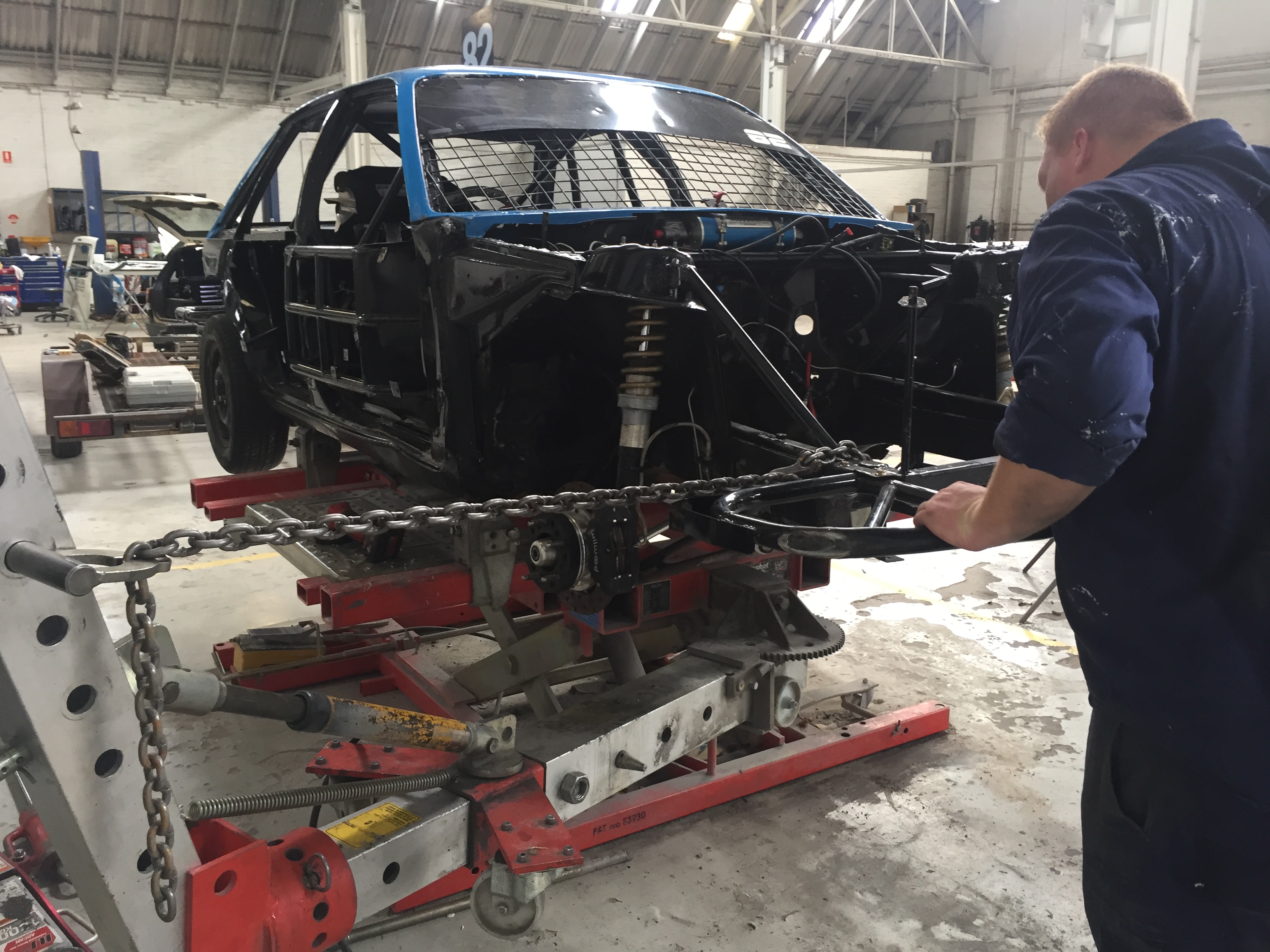

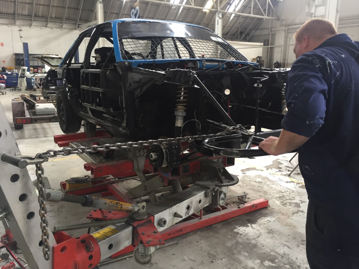

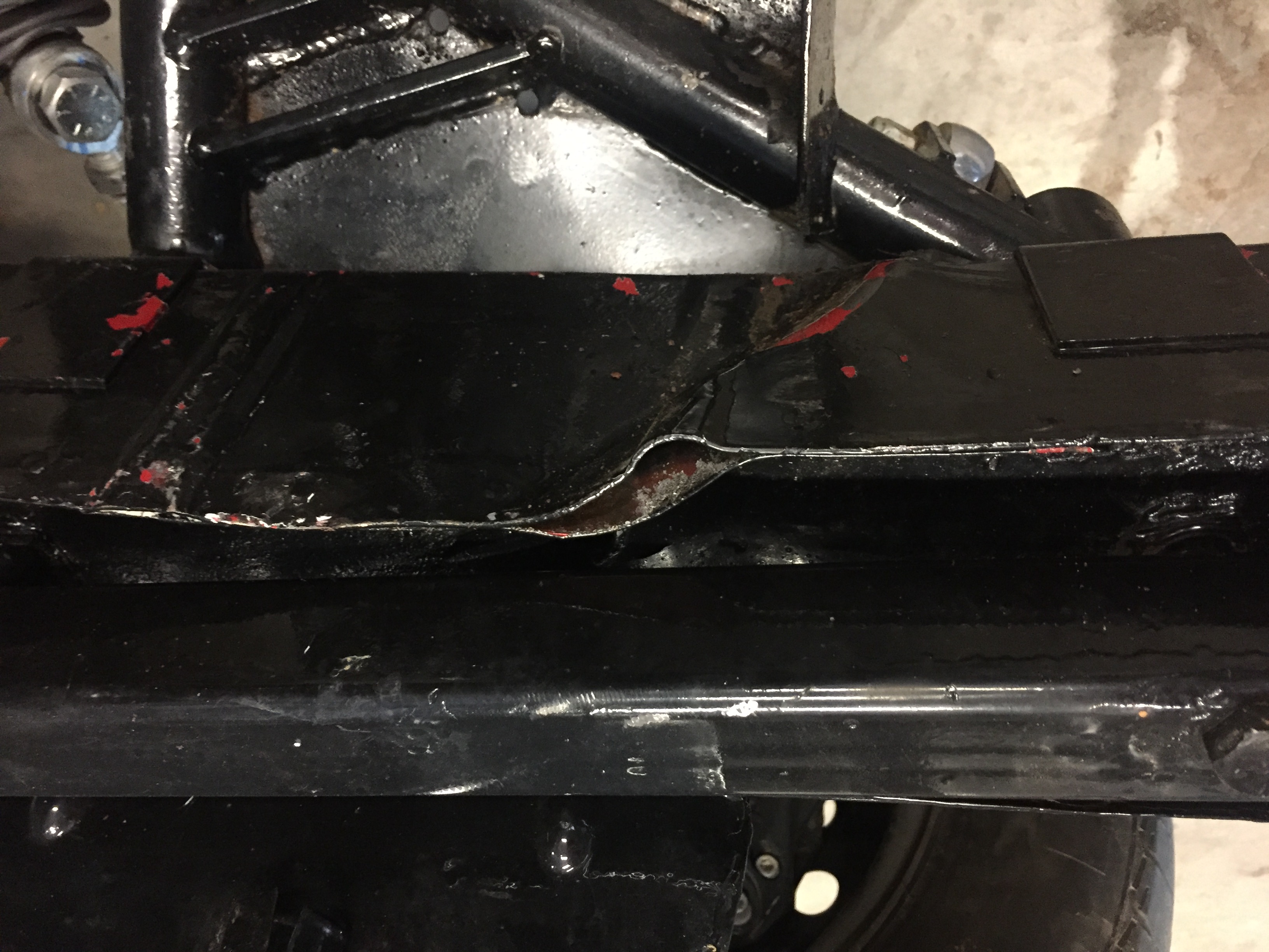

Right, I know it's been ages but here's a little update. I have ended up with a very fast and great handling car, we lost more weight than we hoped and are still finding ways to get rid of it. I have competed in two endurance events and had mixed success. Although the car is fast, I was dogged with power steering problems at both events. In the three hour enduro a car spun in front of me and left me no where to go, I hit him hard, had to pit to get the bumper cut to not hit the wheels, got back out not knowing that the rack mount was damaged. About 50 laps later one of the rack mounts failed and caused me to hit the wall hard.
So today I spent the day at a mates panel shop on the rack fixing the bent rails

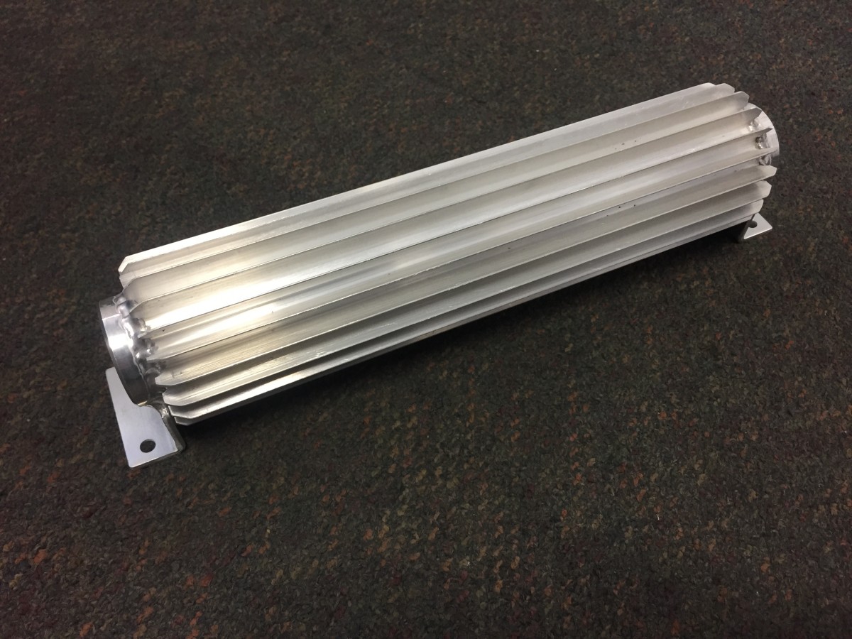

Oh, and I got this to add to the circuit...
- Posts: 8550
Re: How to loose 200kgs?....
To the PS line?

you might want to get a proper oil cooler radiator, that has such small internal surface area and large internal volume that oils poor heat transfer properties will reject jack all to the heatsink. You might only reject 1-2c at most with that.
You want a proper oil cooler with internal fins or tight spiral. The issue is not so much getting the metal to cool, but rather getting the oil to transfer to the metal in the first place as you need to get the oil to flow over as much surface areas across as much of the volume as possible.

Good illustration on typical oil cooler internal design. Gives a fair idea how difficult oils are to cool off compared to water and other mediums.
