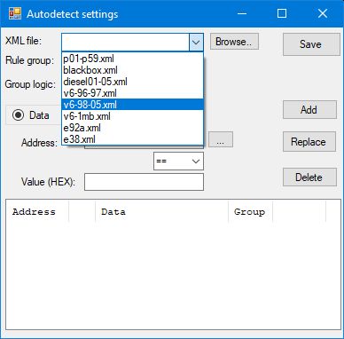

This is how it SHOULD work:
Click "Setup autodetect", then select XML-file from dropdown (see attachment) and edit rules for selected XML-file.
If not, please inform where is the problem (is dropdown empty?) so I can fix it.
