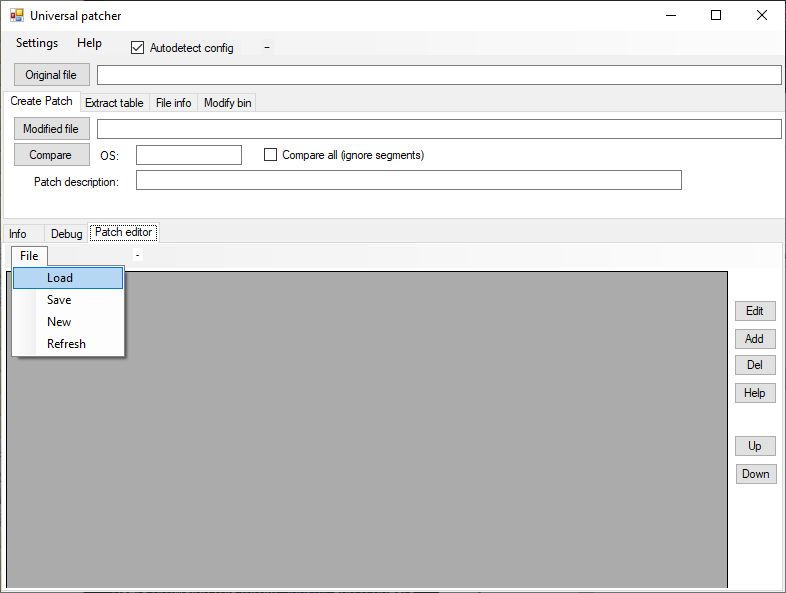

The new features looks great. I am missing the patch save button. Can you add some scroll bar to the manual patch "data window". Now it is easy to overflow on larger patches.

Re: Segment Swap utility
Patch save moved to menu.
I can add button again if this is bad choice?
- universalpatcher-patch-file-save.jpg (34.46 KiB) Viewed 3650 times
I totally missed it.
I don`t know which one will be better, the buttons are easier to work with but the menu is more refined and adds a little confusion.
