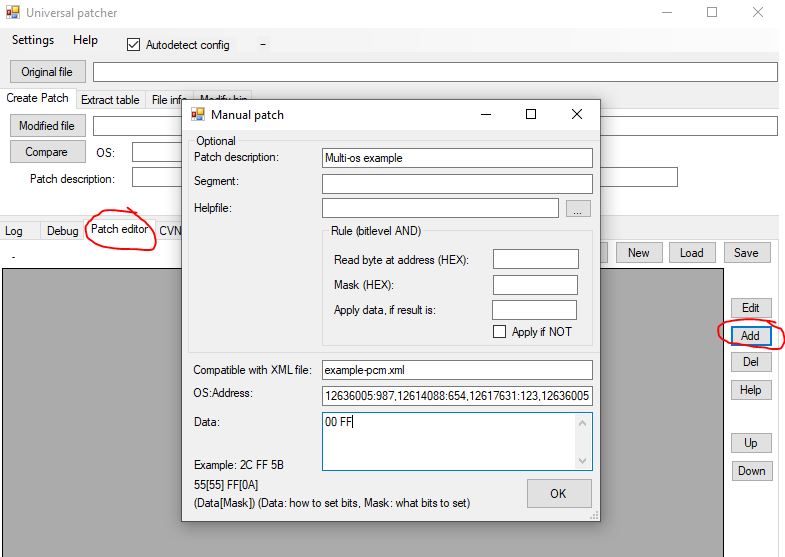

ironduke wrote: ok.. ok.. ok.. try not to laugh.. I have never edited an XML file in my life but never thought it was this much of a pita.. lmao.. After I thought I tried everything remotely possible for all of them in the same row, then I tried patch 'rows' that I took to mean each line has an OS and address then the Data is at the bottom, then I made them all separate with each compatible OS having the data line directly below it, etc.. Then I came up with the idea of using a comma as a separator between compatible OS:address sections..
Now I have <CompatibleOS>12636005:address,12614088:address,12617631:address,12636005:address,12639835:address</CompatibleOS>
and the data line below it and it seems to work.. Nice to have 1 patch for a bunch of different OS for the same function..
I looked around the program itself, but I didn't see an easy way to create this xml file by itself, like if I created a patch file by comparing two files and saving it, I didn't see how I could compare 2 more files and then save/ add it to the same xml file.. I understand there may not be a huge request for this? I'm known for off the wall ideas..
Thanks again, but if someone ever creates a easy to follow set of instructions with full blown examples I would be the first to sign up!!! lmao...
Version: 0.9.22
Added possibility to Append comparison result to current patch, instead of creating new. Thanks for the idea.
You are right, I should create instructions, but it is not as fun as coding new features :oops:
XML file editing with text editor is not necessary.
Please see attachment, it should explain how to create single patch for multiple OS.
