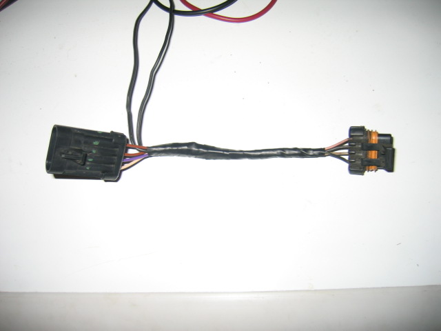

I made up a small patch loom using a couple of old O2 sensors and a couple of plugs from another loom I raided at the wreckers so that I didn't have to cut the actual loom.
Fitting new O2 sensors, patching the loom and then fitting some later style 777 injectors was the best thing I ever did for fuel economy on the old VS.

Can you draw how you did the patch loom ?immortality wrote:I made up a small patch loom using a couple of old O2 sensors and a couple of plugs from another loom I raided at the wreckers so that I didn't have to cut the actual loom.
I intend to change the O2 sensors so would end up with two I can bastardise.

Sorry, completely forgot about this. I don't have a wiring diagram, the only thing I still have is a pick of the completed patch loom.
The unused tails are wrapped up inside the loom to make it look tidy but they are isolated and not connected.
This is the last version I made. I fitted one in each side and extended the earths for both sensors so they were earthed at the same location on the block and then wired the heater earths together on a different part of the block.The unused tails are wrapped up inside the loom to make it look tidy but they are isolated and not connected.
