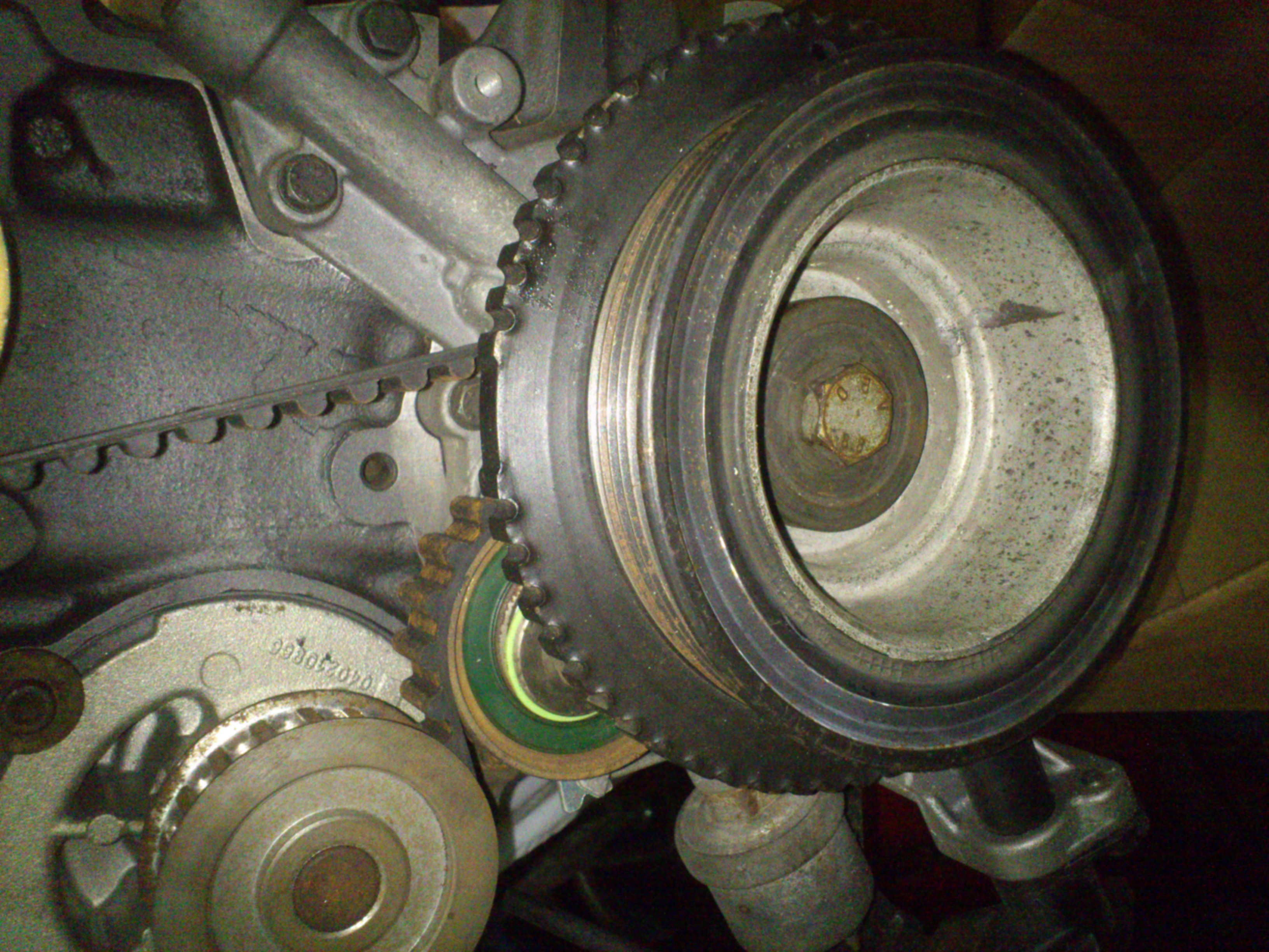

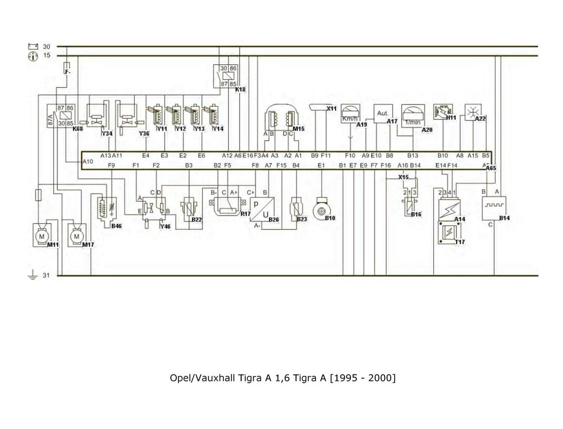

This is diagram from my BRDS euro ecu that uses dis, it has a 60-2 triger and it is 4cyl.
